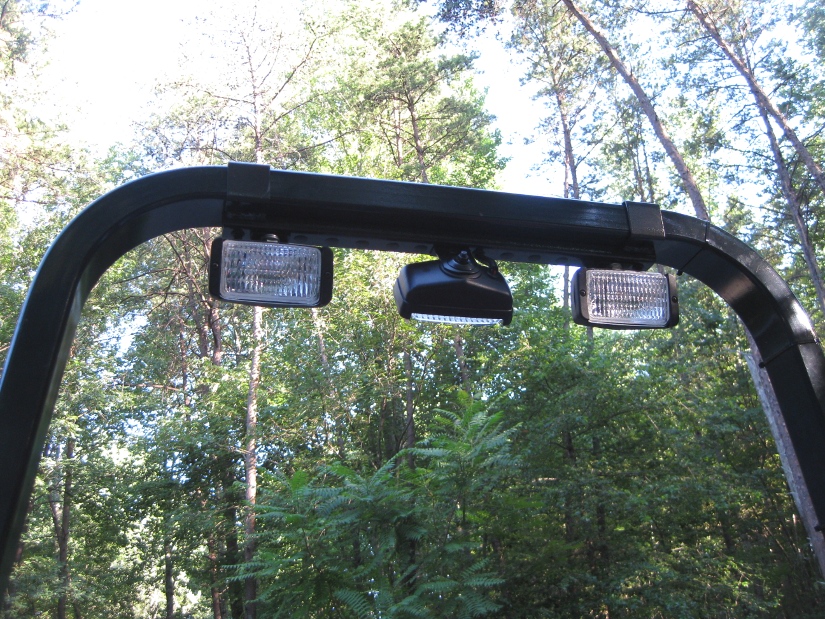

I just knew I needed one for when the loader is attached.
I used a piece of cable trough rail because it has nice round holes for grommets, plugs, and bolts...much better than uni-strut for this application.
Works like a champ!!!

Looks like a nice neat job. Good place for them too (inside the ROPS):thumbsup:
Made a big difference on mine when I did it, like night and day:laughing:

I too have mine mounted the same way, but I find them to be closer to ear warmers because of my height and the height of the ROPS. I used tie wraps for now, but like your idea. I am debating moving mine to the top of the ROPS since I don't mow under many trees. Just need to make sure it will fit in the garage that way.
