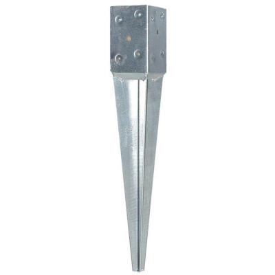

It will have a gate in the middle and will need to be about 6 feet wide. It will be painted white. Posts will be 4x4 held in ground with something like this so that it can be removed if needed:

With the drive in base that you're planning on using, I'd also put some type of cap or roof structure on it to give it more stability, the good thing is that if you use that base, then you don't have to worry about the ground contact rating.
