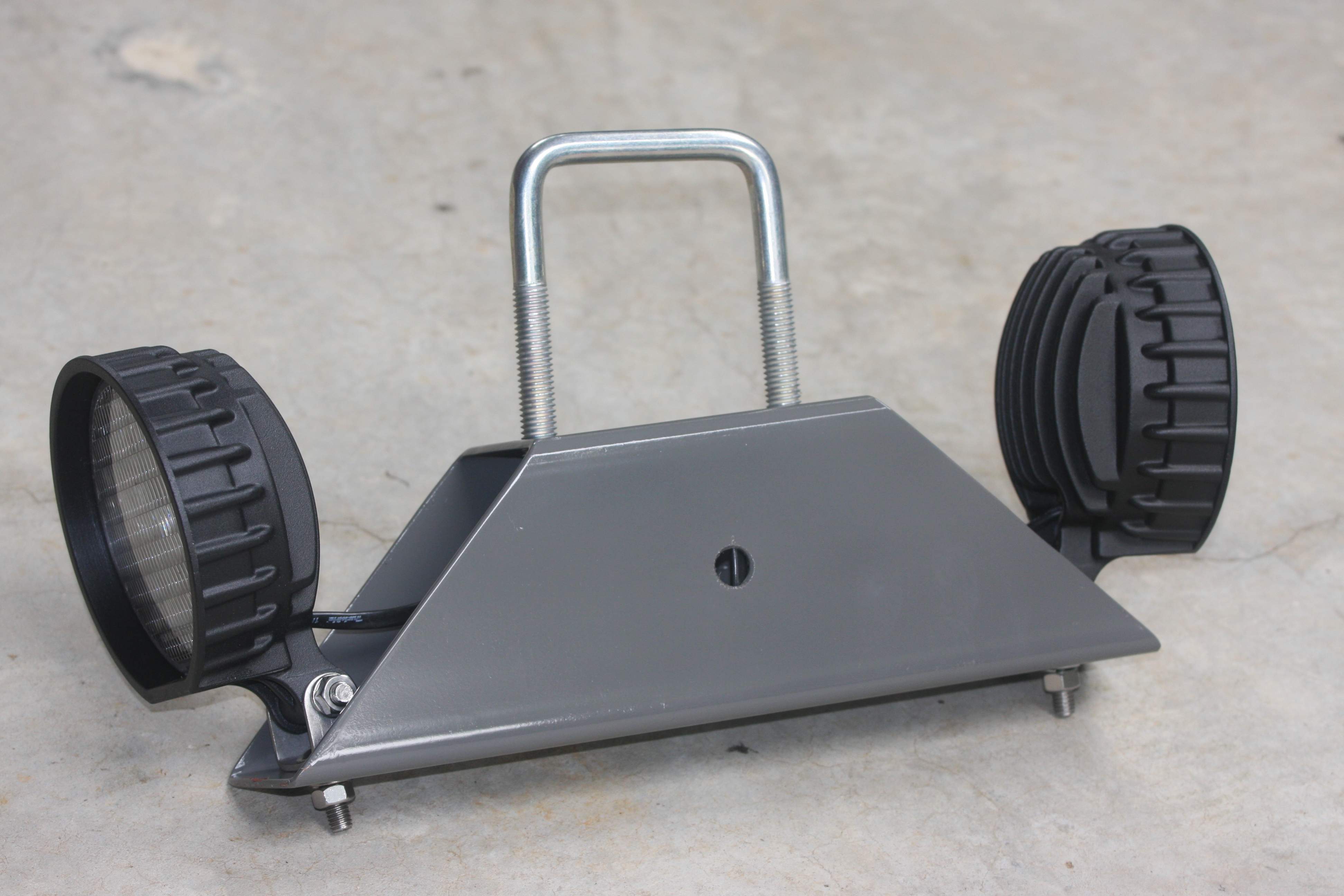

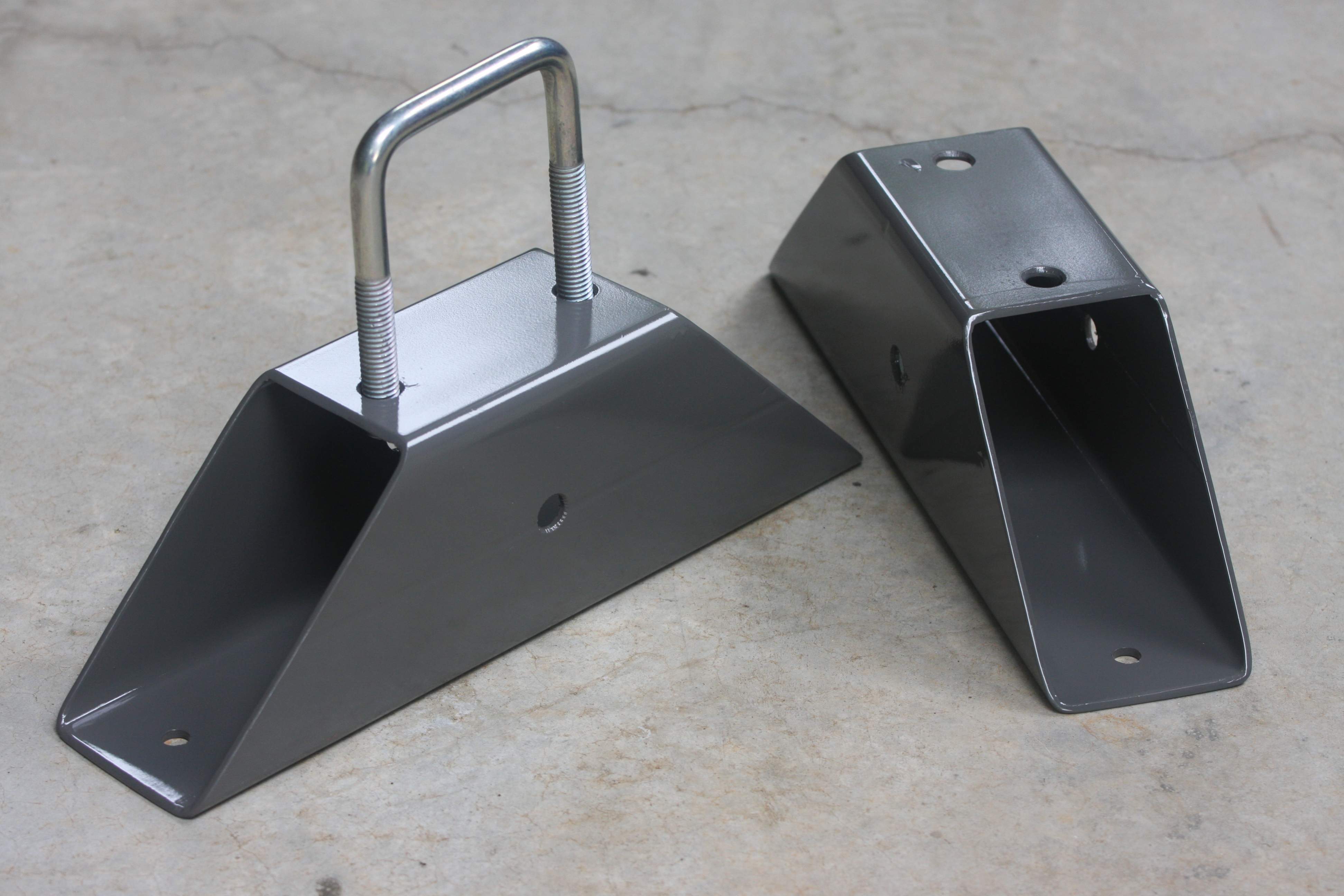

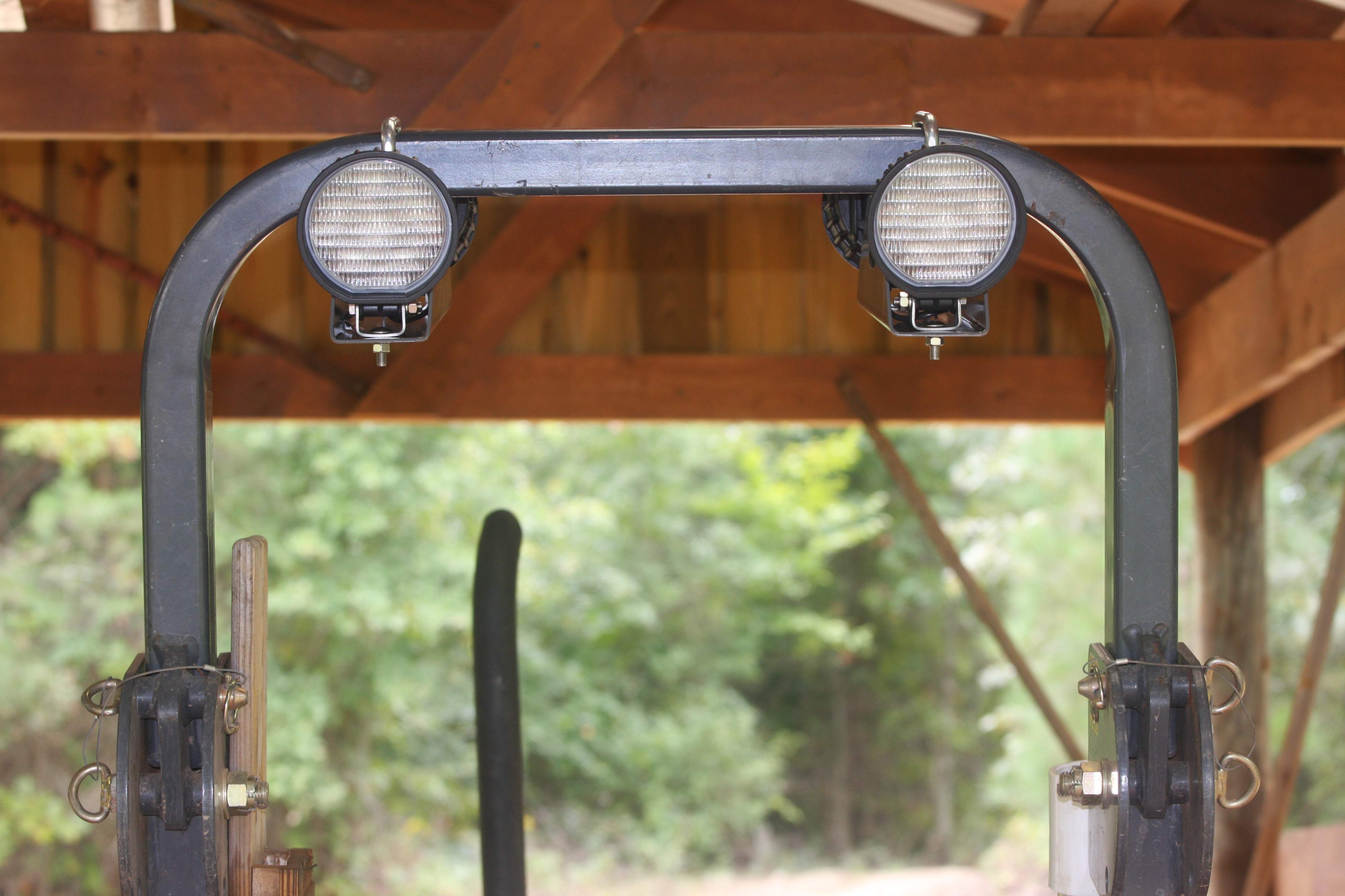

Just thought I would share pictures of my new LED worklights. Mounted two spots on the front and two floods on the back. I picked up many ideas from others posts and used the previously posted system of relays. My mounting system was my creation and it works really well. No drilling of the ROPS and they are somewhat protected from overhead branches. Hope this helps someone!

Very nice job. How did you route the wiring ? How about some more pictures that show the wiring ?

I just realized these pix were taken before they were wired. The LEDs are made by Truck-Lite, bought at Truck Pro. They were pretty expensive, over $100 each, I can't remember exactly, but I will look it up. I think the models were #81380 for the rears, and 81390 for the front. I will check to be sure. I bought two Kubota factory switches as seen on other posts from Coleman Supply, also pricey, but look factory and work great. Cuts square holes in my dash panel, to the right of my steering wheel. I like the lights because they are bullet-proof, use very little current, and need small guage wiring. I bought a multistrand trailer style wire that looks like a heavy duty extension cord, and used some of the strands. It was so tough, I ran it out the hole in the side of the channel iron, and simply down the interior of the ROPS using zip ties, then under the floor to the fuse box in the dash. I was going to install 1/2 square conduit, but decided that was overkill, as the wire was very strong. I used 2 relays and ran a wire to my battery, with an inline fuse. The wiring diagram is posted many places on this site. One added benefit is that since my shed has no power, I can switch the rear flood on without turning on the tractor and have good light, so I can see to get my gear together for those early morning hunts. It also allows me to work at night when it is cooler in the summer, as i can now easily see my rear implement. I don't even use my factory headlights anymore, as my grapple makes them worthless.

Yes the light output is great, especially the rear floods. For instance when I plow at night, I can easily see everything hapenning back there. The fronts are good for regular tractor work, of course they are not made for high speed highway use, but plenty for normal low speed travel. Of course my FEL and grapple and long hood still casts shadows but it is way better than the factory lights. Another nice feature is that when I do hit limbs overhead, the lights pivot backward against the 45 degree bevels of the housing and are supported and don't break. Then it is easy to reach up and re-direct the beams. Unlike some mounting systems i considered, you can also rotate the light left and right and up and down, to suit your needs. I thank previous posters for the wiring diagrams and switch sources. I wish I could remember their names, but I did these lights last winter, so my memory fails me.

Very nice, clean, simple, effective mounting brackets. I like them.

No, did not think about that. I guess I should have done a trail run before the final connections to see what that would have looked like. Yet my rear floods do illuminate the immediate work area and don't project too far, and my front spots can be aimed to shine around the FEL and grapple. It would interesting to see what a flood would do for front vision. Someday when I am bored, I may disconnect one and try it.
