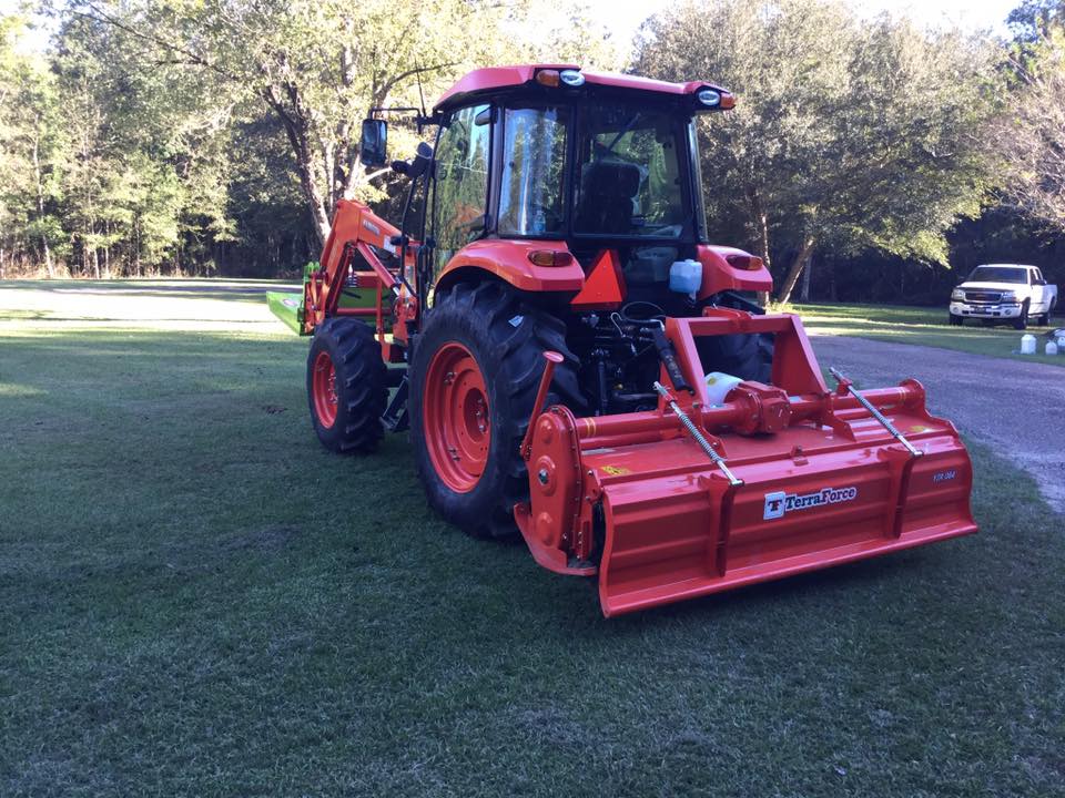

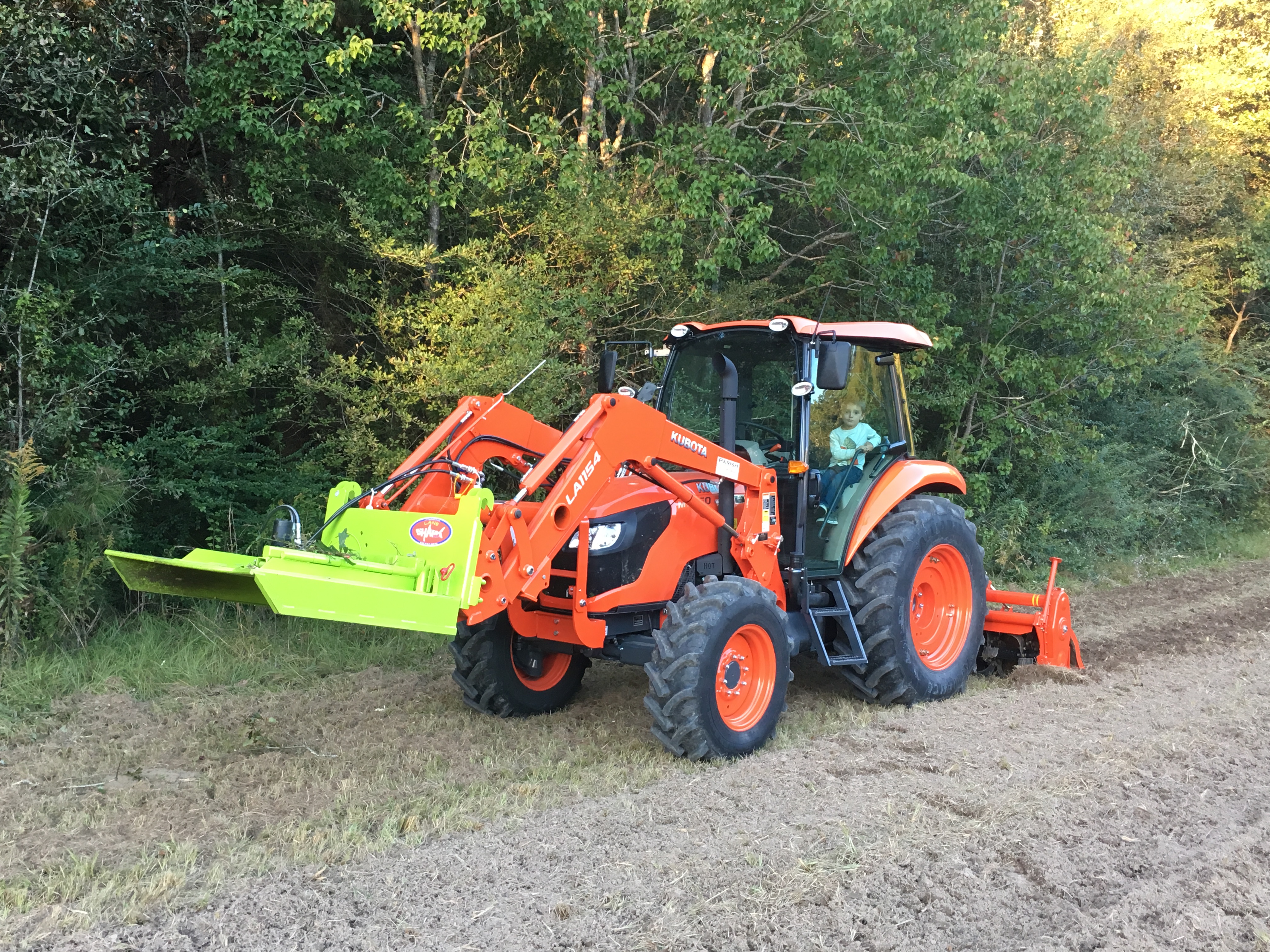

Got my new tractor today and one of the first new implements I tried out was the tiller. It is every it as awesome as I hoped. Tiller up some old hay field that had not been tilled in 30 years and one pass was all it took. Very happy!

New tractor, new tiller and a patient helper. It can't get any better than that. :thumbsup:

Its not beautiful tell the paint is warn. I have the YJR072 and love it too. If you ever need to level an area out, tighten down the back door and it will carry material with it as the works and do a bit of leveling as it goes.

M7060 and that tiller. WOW! Can't help but get things done:D

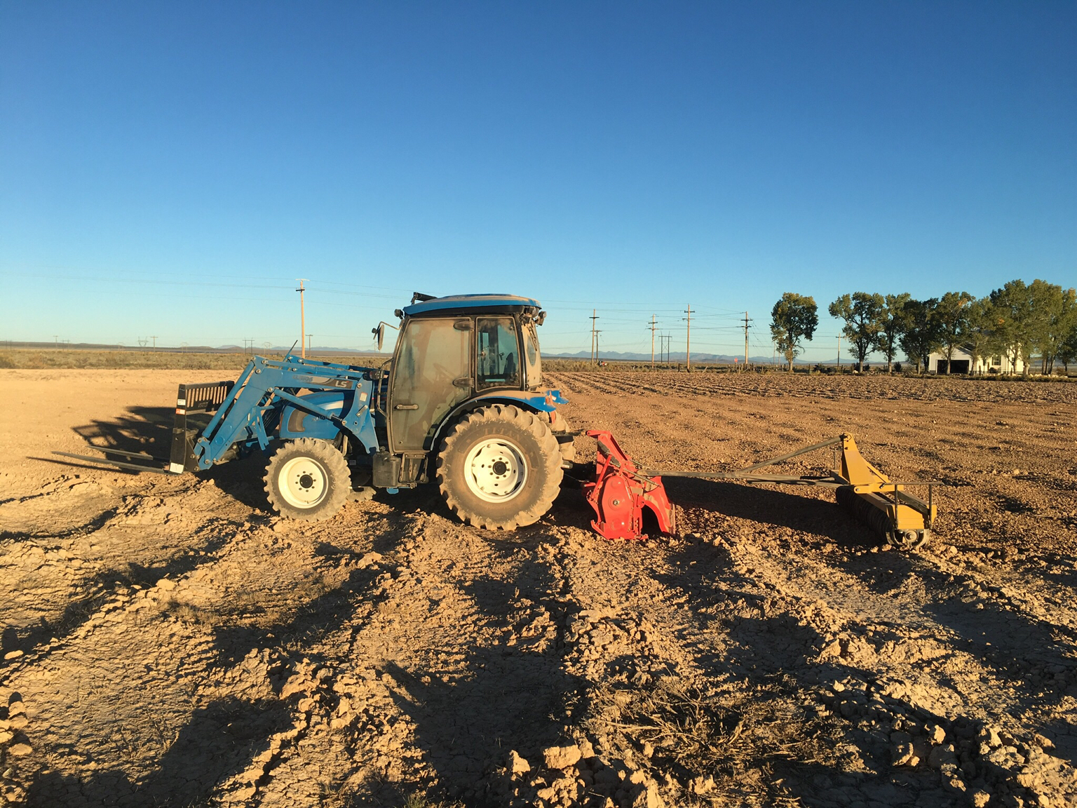

I’m still amazed how fast mine tears up my hard clay. I generally till 2 acres per hour. It can make my 68hp tractor work at bit, so I wouldn’t want to put it behind a much smaller machine. Two passes at 90 degrees offset and it’s ready to plant.
It came on a very stout pallet to which I added some 4” casters. I set the tiller on that pallet and push it into the corner of the shop.Image1509847813.114387.jpg
