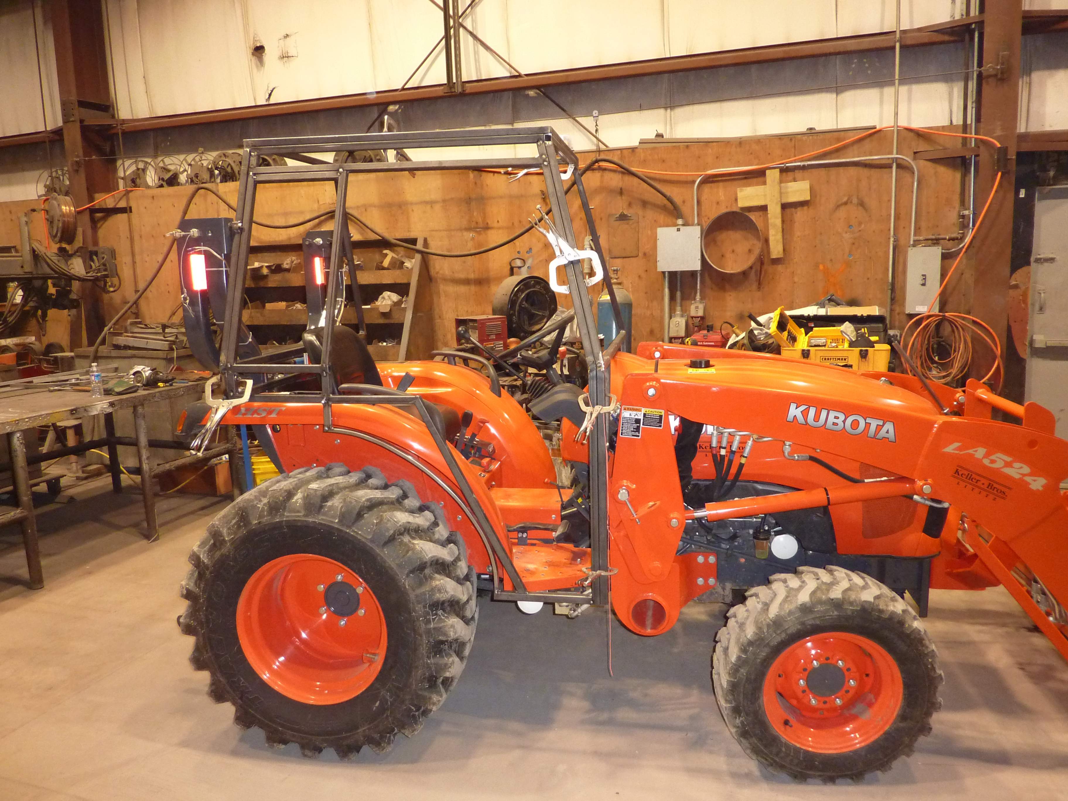

Fought the cold and flurries in the face for too long. I'm building a metal and glass cab right now. It will have heat and is being built in sections so it can come and go with the seasons. There's a lot of work left to do. With lots of luck it could be done this week. Cost will run less than $1,000 (Metal = $90, Glass = $400 est., Heater = $150, Wiper = $40, Paint = $80, cow mat to block off underseat area = $0 [had enough left from another project], plus some unforseen stuff for sure. The glass was quoted as around $10/SF for laminated safety glass. Need to have final patterns to give the supplier, but he claimed next day availability.

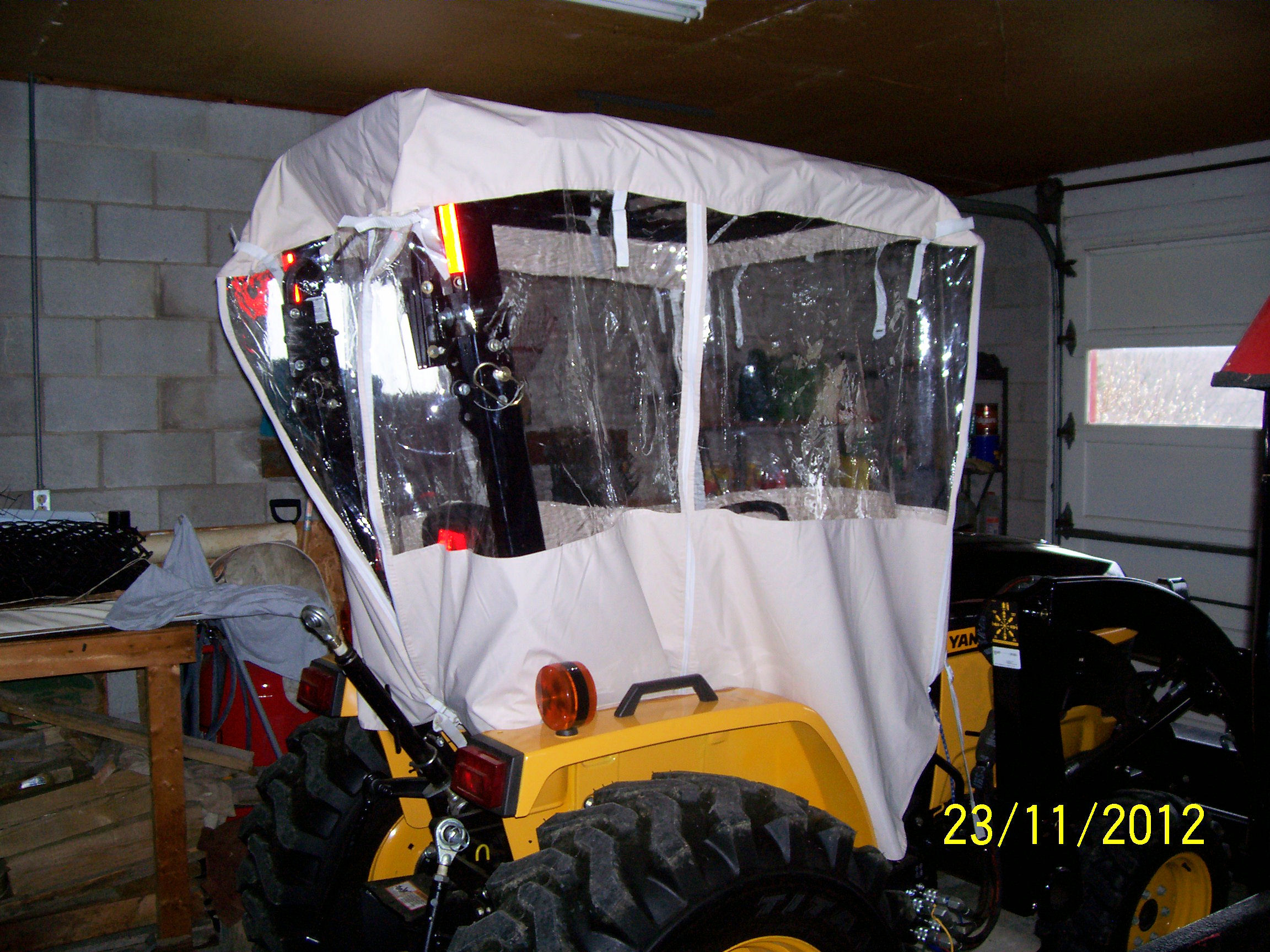

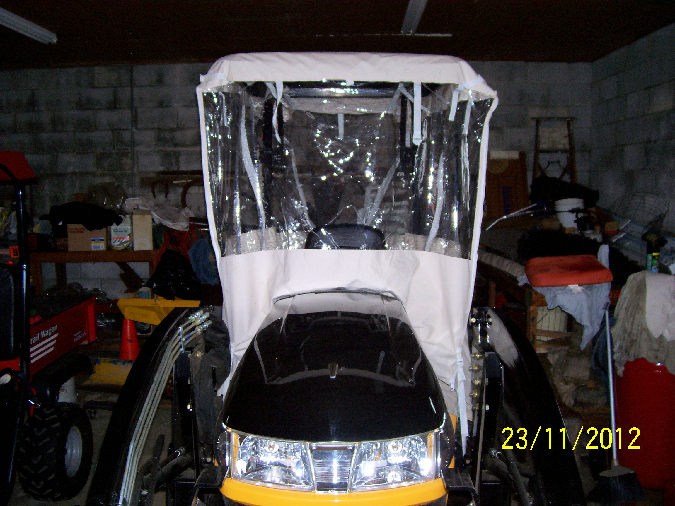

For about a $100 you can get a golf cart enclosure from northern tool and it works very well to keep you out of the wind and blowing snow. I bought one last year but only used it twice due to not very much deep snow in our area, but both times it kept the snow and wind off of me. I've attached 2 pictures to show how it looks on my EX3200 but do note, I have a tractor canopy connected to the rops the enclosure rests on so you'd probably have to figure out how to secure and run two rails from your rops towards the front for the enclosure to rest on, for your tractor, if you don't have a canopy.
Do you have a thread started on this build, and if so, please post a link to it. Thanks.
