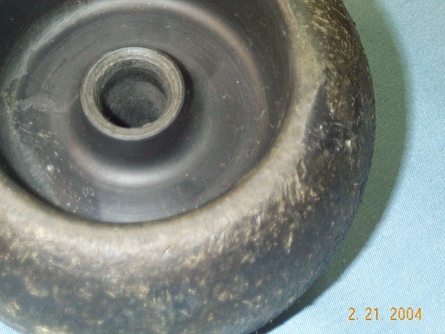

Faced both sides of wheel then drilled and reamed to 3/4" dia. and pressed in oil impregnated bronze bushings then line reamed bushings to the 16mm dia. the OEM size of the axle bolt. 2nd I drilled and tapped axle bolt to except a 1/4-28 thd. grease fitting and cross drilled a hole 1 1/4" from under shoulder of bolt which is between the 2 bronze bushings.
4 pictures, 2 of my used (about 1 1/2 seasons of mowing) wheels and axle bolts and 2 of new wheels and axle bolts up dated to my new standards. Let me know if I can help any TBN members

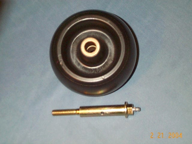

Picture 2 Old wheel with new bronze bushing installed and axle bolt with grease fitting

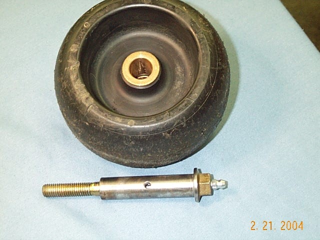

Picture 3 New wheel with bronze bushings installed and new axle bolt with grease fitting. Outside view
