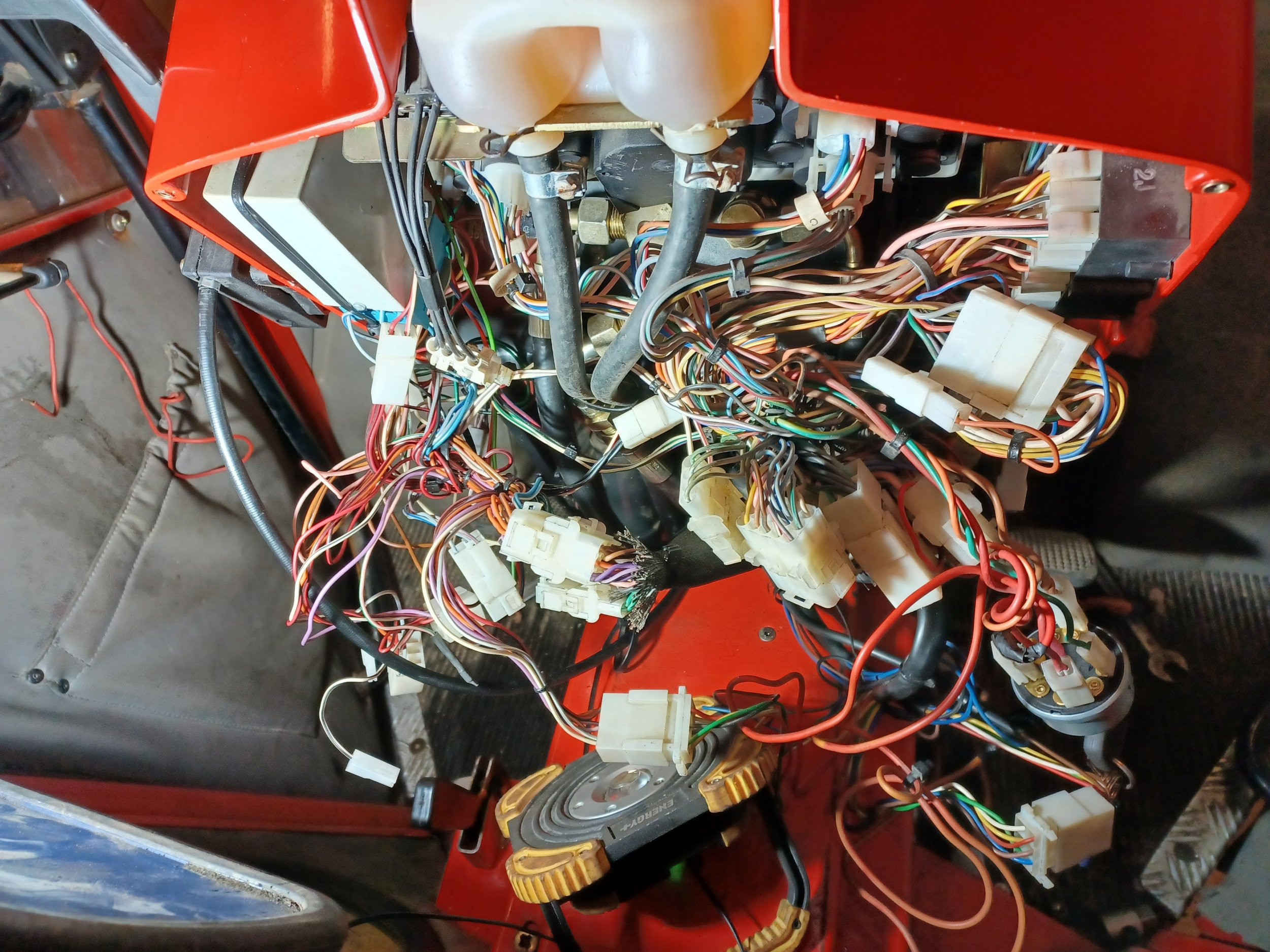

Zero help from antonio carraro. Tractor is moving, but electrics totall mess... Is there any antonio carraro service guys... ???
I need asap wiring diagram for supertrac 8400. -05.
I have service manual for 5600-7700, but wiring diagram is not correct.
Impossible to follow cables as all goes to body middle section.
In pic italian electric skills... Wires cracks at winter, no any protection against moisture...
Seems to be more hobbymachine, than professional working machine... But worst is, that ac sell expensive parts, but technical help from factory is zero.
