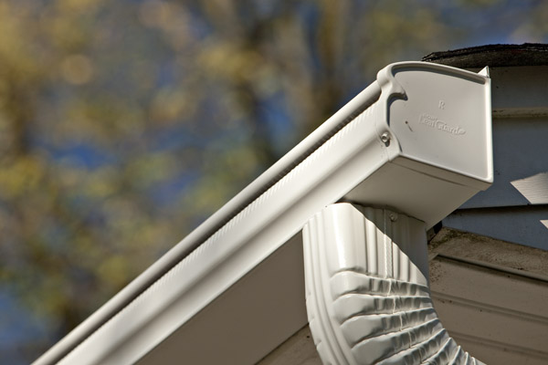

I am wondering if anyone has experience with Englert LeafGuard gutters -- these are the one-piece continuous gutter that is formed on site, looks like this:
I had some installed on my barn last week, and went with this gutter (which is about 5X more expensive than standard gutters) because we have pine trees dropping needles year round, as well as a lot of leaves in the fall. I have a traditional gutter on my home over the front porch, and it's a pain to always keep it cleaned out, so I could justify the cost jump of putting LeafGuard gutters on my barn if I never have to clean them.
The good news is that the installers did a nice job, the gutters look good, and they are staying debris free. They work well in moderate to heavy rain, as the water rolls over the top surface and drips into the channel. But what I have seen is that under all other conditions, most or all of the water just drips over the front edge of the gutter and falls to the ground. So with drizzle, light rain, melting snow, or just morning moisture on the roof, the gutters are not effective, and I may as well have no gutters in those conditions (they are just moving the drip line another 4" out).
I called the company, and they are going to send someone out in the next 2 weeks to "fix" the gutters, but I don't really see how they can do that -- seems like a limitation of the design if it needs significant rainfall to function. Sure, the bottom lip could be bent out to widen the channel and catch runaway drops, but that can't help the debris free aspect.
The company is local and family-run with a good reputation (did traditional gutters on our previous home that worked well) and I would feel bad asking for a refund, but that is my plan if the "fix" doesn't make a major improvement. These were expensive gutters, and I expect them to actually function as gutters! My next alternative would be traditional gutters with a foam insert to keep debris from collecting inside, though that isn't 100% effective, especially with pine needles.
Curious if anyone else has LeafGuard or similar gutters and has any experience.

I do not have personal experience with them, but I did a bit of reading a few years back when we had new gutters installed. From what I read, they can have a problem in two ways. Raining lightly, as you have seen, and raining very hard. In that situation, they say a bunch of rain will just shoot over, too much volume or too fast to curl around and in.
ALot of other testimonials seemed to really praise them though. Hopefully there is some adjustment they can make for you.

Well, they came out today, and the installer was very honest that these types of gutters will drip down the front if there isn't a strong flow from a moderate rain. Not sure what to think, as I would prefer the gutters to be catching everything, including those days where melting snow on the roof drips and trickles for hours and hours. I am going to watch the gutters perform for another week or so and then decide what to do. I may approach the company about either a refund or changing out to standard gutters (if they give me grief, I paid by credit card and would just dispute the charge and offer to remove and return the gutters on my own).
