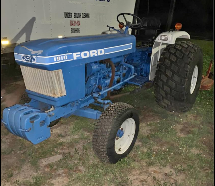

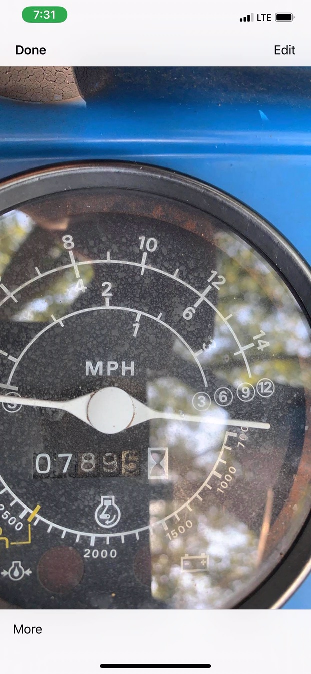

I'm considering purchasing a smaller tractor for running a finishing mower and found a '90 Ford 1910 with turf tires that I'm planning to look at (have not done so yet!) The clock has 789.5 hours on it - I assume that's not accurate on a 30 year old tractor.
Does anyone here own or have any experience with the 1910? Any advice on what to look for when checking one out before buying? And what is your experience with the tractor- are they well built? And are repair parts easily available? Any pre-purchase advice anyone can share would be appreciated!

Does it have a loader? If it does check the mounting bolts for breaks in the housing it attaches to, also check the bolts that go into the engine that attaches to the front frame.
Does it have power steering? Power steering on these models are not the easiest but better than manual steering.
Does it have synchro gears (shift lever on steering column), this are more convenient than the two sticks on trans.
If it has four wheel drive, there is a coupler on the drive shaft that tends to wear out if 4wd was used hard. This coupler is easily replaced.
The hour meter could be accurate, some of the tractors didn't see a lot of use. Ask the owner if is working. Look around the engine, if it is clean the hours are correct, you can usually tell if it was power washed also.
These are good tractors especially for a finish mower if you have an open area. Most of the normal maintenance and wear items are still readily available. Just be aware that with a tractor of that age it will develop some leaks because of the rubber gaskets aging. If you can post some pictures.

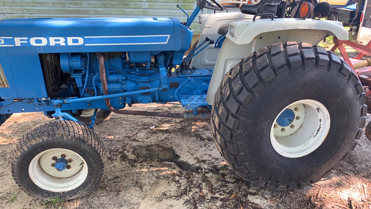

These are the pictures from the ad. As I mentioned, I haven't had a chance to look at the tractor yet.

With the replacement seat and repaint, you are probably correct on the hours on that machine. A two wheel drive without a loader usually lives an easier life.
I would recommend running the tractor for about 15 minutes, test all the gears, check brakes, three point, PTO etc. After running it for some time, see if there is any signs of engine blow by. Also it is normal to have to use the glow plugs to start the engine even on a warm day.
