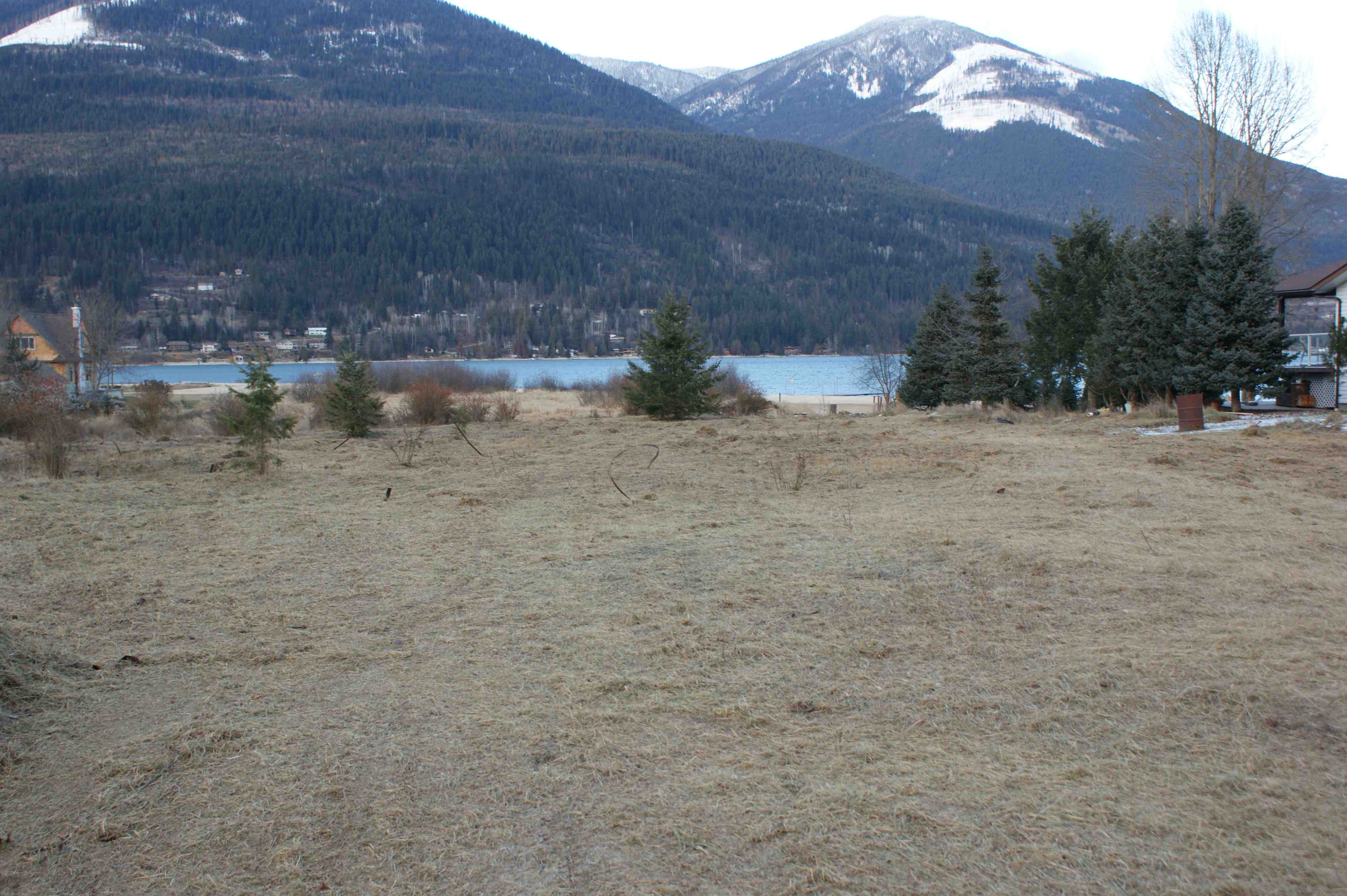

We just bought just under three acres of property. It has some log banding on
it which we are picking out as we clear it. I will be buying
a MasseyGC 2410 or GC2610 next week. I would like some advice on a mower.
The dealer has two five foot used rough cut mowers ($600 and $900CDN). He also has a Massey 54" mulching MMM used for $1200.00. I know the MMM
will be a bit of a head ache to re and re. The property looks like this.
/ Any help with this one, Please... #2
Is the whole 3 acres like that in the picture?? That lot looks like it really just needs a finish cut mower to maintain it, but seeing all the steel banding is there I might have to go with the 3pt hitch bush hog. You're gonna need something tough enough to handle the banding getting wrapped around the spindle cause it looks like there's plenty of it there. My hunt club has a 75 acre lease from a paper company and about 12acres of it used to be a wood yard where they loaded timber onto train cars for hauling to other states. There was plenty of banding left over there and occasionally when we bush hog it, we will get some wrapped around the spindle. You just have to stop and work at with tin snips to get it off. Be sure and block up the deck so it won't come down on you!! If you get the MMM, you'll probably have to remove it to clear it, then you'll have to put it right back on to finish up. Could get aggraving after a few times.
Btw, you can buy a cheap metal detector (make sure it has the "all metal mode") and go through that place and find most all of the banding and dig it up. Will take some effort but I think it would be worth it. If you get it all cleaned up, then I would most likely get a MMM mower or a 3pt hitch finish cut mower.
So, maybe the answer here is get a rough cut mower to start with, and once you feel like all the banding is gone, you could always sell it and then go get a MMM??
Btw, love that lot you bought, fantastic view there!!! What mountains are those??
/ Any help with this one, Please... #3
I would use something such as an S tine field cultivator to find all the metal bands asap (before the grass and weeds have a chance to cover and hide them. I know what you are up against as I have a 30 acre field that has lots of 5/16" round banding from the 1880's. Wrapping either of these up in a tiller, disc or rotary cutter makes for a real mess.
Another tool you could use is a boxblade with the rippers all the way down to search out all the banding, and for a small plot may make more sense.
For the rotary cutter I would go with whichever is the better of the two. I would not concern myself with a mmm until I had the place whipped into shape.

Thanks for the replies. We used a quad, brush cutter, and a diamond harrow
that my son discovered on the property to get this far. You know you have hit banding if you have a brush cutter in your hands. Hey Kebo, I think the Mnts.
are the Selkirks. Just Google Nelson, BC, Canada,then click on satelite. Here is a picture near our beach.DSC07627.jpg
As jenkinsph suggested, we will be purchasing a box blade as well. I'm still
a little confused whether to get a four or five foot though. Any suggestions
are given the highest regards...
