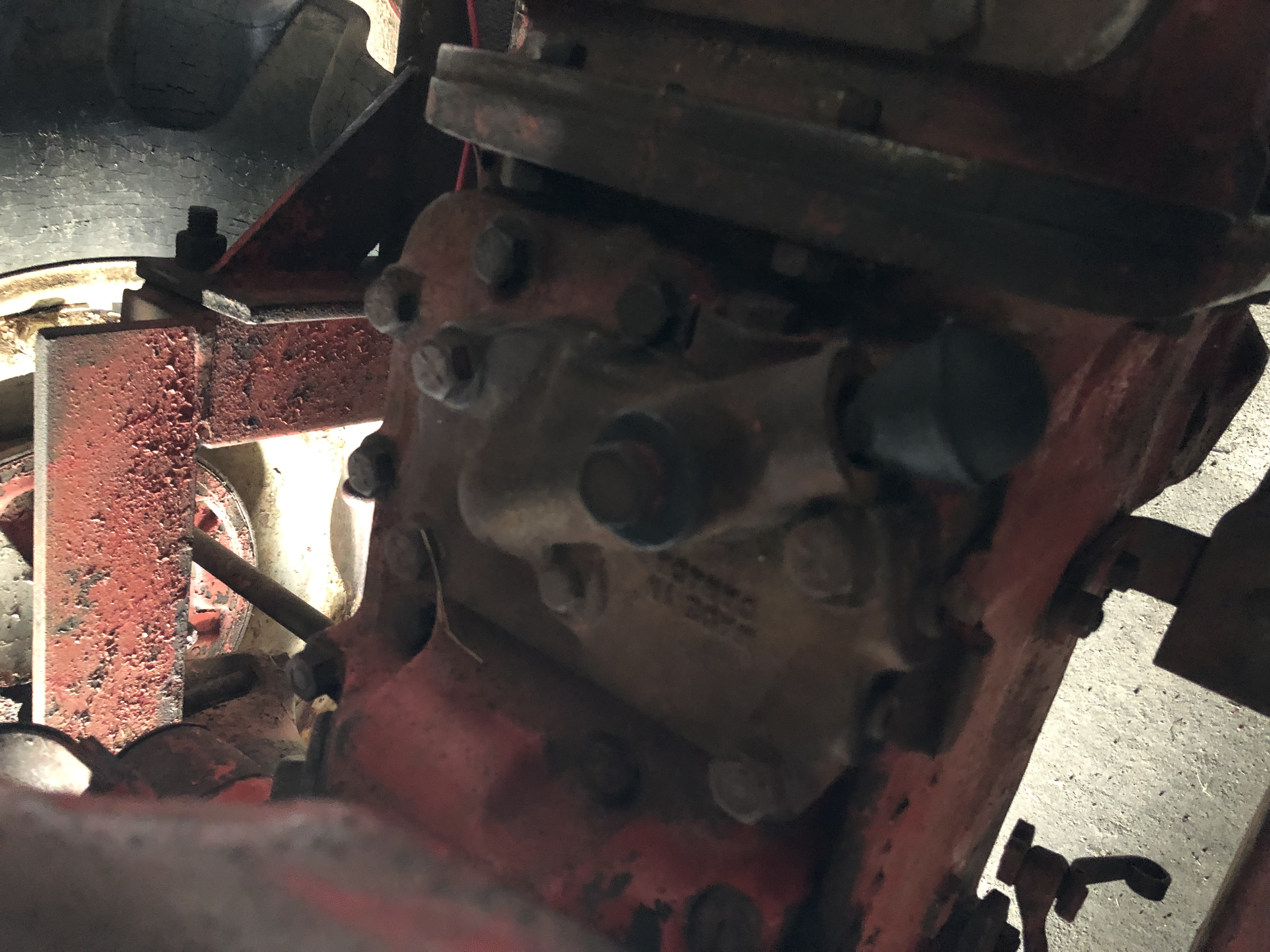

Jan 3, 2019 / Any idea what this is on my 850 #1 H Hammer850 Member Joined Nov 14, 2018 Messages 32 Location Swanton OH Tractor Ford 850 I can稚 figure out the purpose of this cover it sorta looks like it could be for a remote but there are no lines. It痴 not in my parts book and I have not seen anything like it in pics on other tractors. Stamped made in Canada. Attachments F1232F98-32E2-4EAC-B460-409D08DBE013.jpeg 2.6 MB · Views: 194 E185C876-2554-4E11-9738-912054CFDDD5.jpeg 3.2 MB · Views: 218 889932D5-E99C-44B5-94E3-99DA23DEF0C7.jpeg 2.7 MB · Views: 176
Jan 3, 2019 / Any idea what this is on my 850 #2 wmonroe Elite Member Joined Nov 12, 2005 Messages 3,542 Location Southwestern, PA Tractor 1958 Ford 961 Powermaster That’s where the valves for the rear remotes mount but they look different than that. Does that black knob move at all?

Jan 3, 2019 / Any idea what this is on my 850 Thread Starter #3 OP H Hammer850 Member Joined Nov 14, 2018 Messages 32 Location Swanton OH Tractor Ford 850 Yeah u can pull it in and out.
Jan 3, 2019 / Any idea what this is on my 850 #4 W Wilco Bronze Member Joined Sep 4, 2017 Messages 75 Location Central, MA.. Tractor CK2610 TLB Thats a Hydraulic adaptor plate for running auxiliary remotes. Last edited: Jan 3, 2019
Jan 5, 2019 / Any idea what this is on my 850 #5 Kirk-NJ Gold Member Joined Sep 20, 2009 Messages 413 It's a diverter valve. Deverts the hydraulic from three point to what you want to run. Pressure up gravity down like a snowplow or one arm loader.
