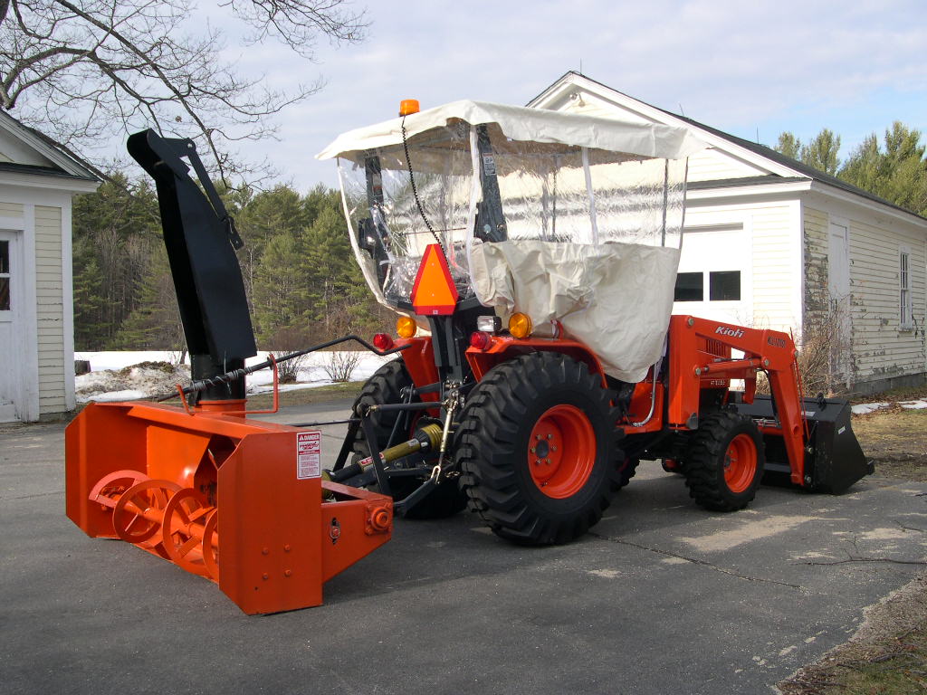

Hope some of the Kioti faithful out there can help me.My father has a 250 foot driveway he has been plowing with his honda 4 wheeler(and killing himself) and has now come to the conclusion he needs a tractor with a blower.He knows nothing about them and is looking to me for help.I have been pointing him twords a 1914 as the dealer is close to him,the price and the warranty.Anyhow does anyone have any experience using a 5 foot blower on this tractor? I dont think it has a live pto but the shuttle shift must help.Thanks for your time Jason

This is my 2nd winter (albeit very mild compared to usual winters) with my LB1914 w/ 60" JRW rear snow blower. I plow two driveways one being about 190' gravel and the other being about 260' of which 180' are paved.
LB1914 works fine regardless of snow type. You just have to adjust speed and height according to conditions. My lessons learned thus far are 1. Chute plugs occasionally (just like any snow blower) with heavy wet snow if you try to go too fast and 2. You have to release clutch gently when engaging blower or you'll snap the shear pin.
