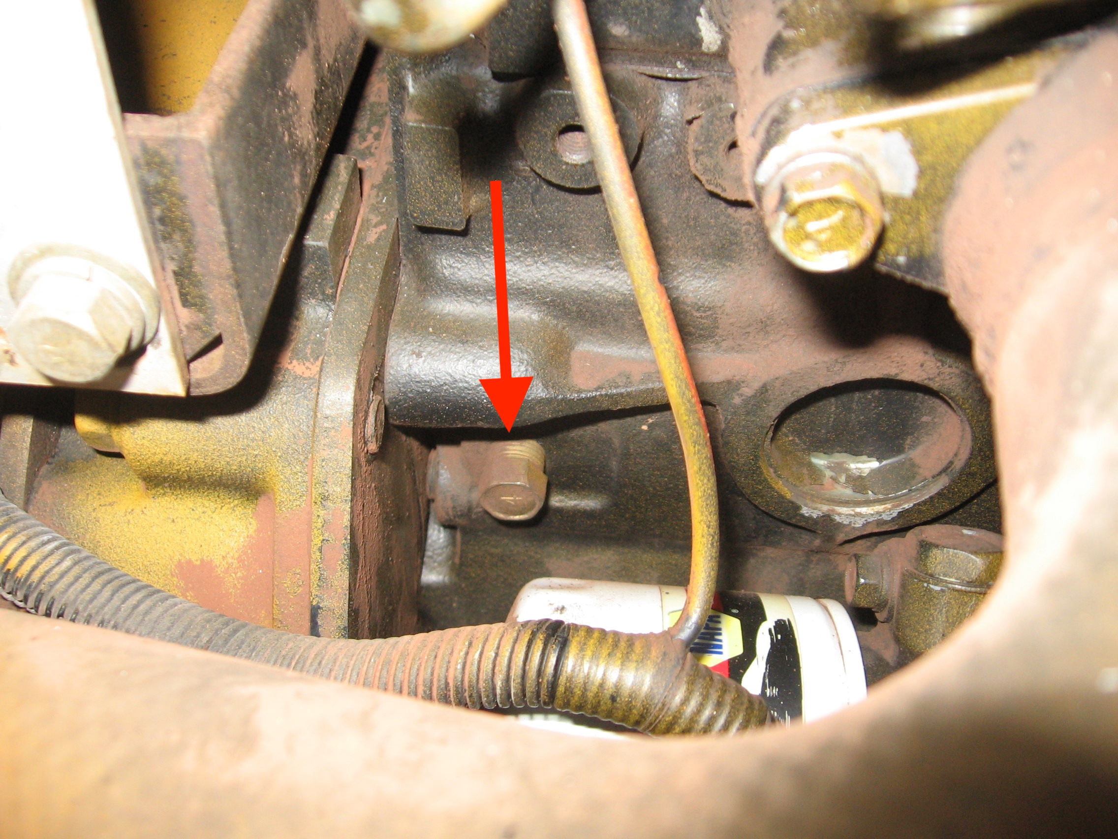

I am trying to find out where the block coolant drain is located on a Mitsubishi K3B 3 cylinder diesel engine.
Mine is so dirty and has such limited access, that I will probably never find it with out some direction.
Wish I had some manuals for this thing.
Thanks in advance.

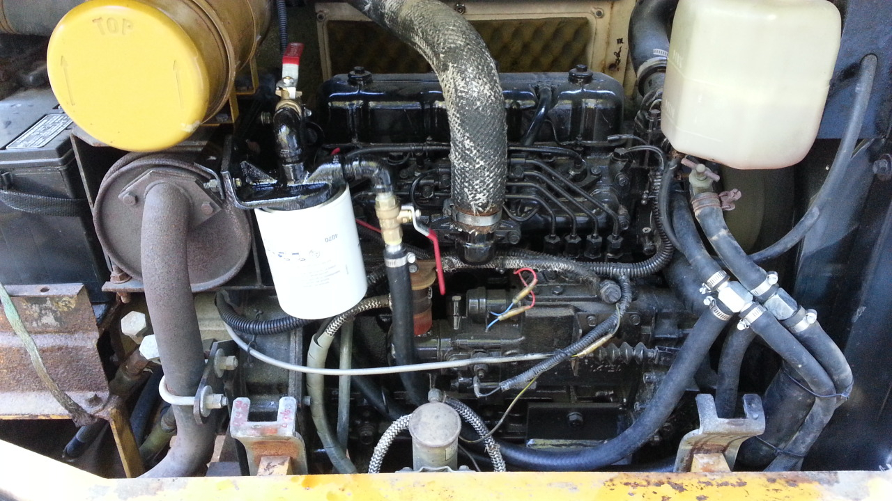

I have a K4E engine in my mini-ex. Might be similar. Block coolant drain is right above the dipstick, which is the hose you see behind the fuel line. The filter you see is a coolant filter.

   / Any Mitsubishi K3B Engine Owners out there?
With help from another forum, I found the drain. Block has been drained & flushed. It was surprisingly clean.
   / Any Mitsubishi K3B Engine Owners out there? #8
Yep. Exactly where mine is on the K4E. I installed a quarter turn valve and a hose going down.
   / Any Mitsubishi K3B Engine Owners out there? #9
K4F is the same.
