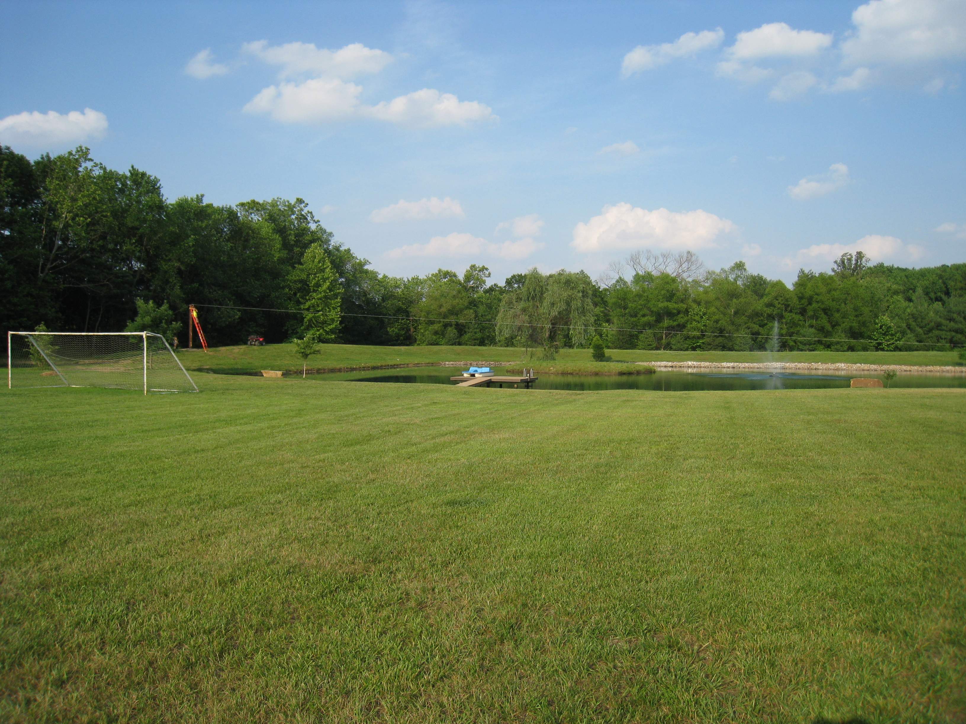

The reason I ask is because I built a zip line across my lake and used a 10' section of 1945 dated standard railroad track for the termination post. I sank 5' of it in the ground, digging the hole with a 24" excavator bucket, and filled the hole with 32 eighty pound bags of concrete mix; figuring that would give me 2 yards of concrete on the post. I also welded various 'appendages' on the lower portion of the track to give the concrete more to hold.
I wasn't planning on putting a tension wire off the back side of the short post to help hold it. Unfortunately, I think I bent the track. :eek: I'm still working on finishing the project, but it's operational and has had dozens and dozens of runs on it. The starting point is at the top of a 26' long 12" I beam with 3/8" webbing and 5" wide sides. With that I beam, it's buried 6' deep and concreted like the train track but it does have a guy wire off the back going to the bottom of a tree in the woods. The 20' I beam also sits on top of a 5' tall hill; giving me a full 20' of drop over the 350' distance of the zip line. The speed and action of the trolley seems to be just right.
I am going to start the process of building a platform around the I beam (rather than the temporary ladder that is attached to the beam) with bench seats and even a fiberglass slide off one side. I'm going to use six 6X6 posts for the platform as it will also be used to prevent the slight side to side motion I get from the beam when someone heavy gets a bit wild on their zip line ride. Anyway, it seems to be holding fine, but it looks like the railroad track has bent about 2". :(
Is that possible? I have 2 different trolleys and each are commercial models with a 14,000 pound WLL as does the 3/8" cable. Do I need to add a cable and turnbuckle to the back side of the railroad track or maybe has the cable just stretched a bit and I just need to tighten the turnbuckle on the main cable and the guy wire cable on the tall post? Thoughts?

These old arthritic hands are having a hard time moving this morning, but I'm working on building the "launch" platform as well as sinking a 8' long 6" I beam completely into the ground on the termination end so I can help the wimpy 5' section of railroad track above ground (5' below ground with 2 yards of concrete but track bends). In this pic it was just setup for temporary use for a graduation party.
My daughter graduated valedictorian of her HS class and we had a big party here and I just got the zipline operational. You get to travel 350' over the pond, over the edge of the island and, if I move it, through the fountain, as you cross the pond. Can't see much in the pic but my old hands are moving slower each day and the launch deck may take another couple of weeks to complete the way I want it; with seats on the sides and a 10' slide off the side in case you change your mind.
