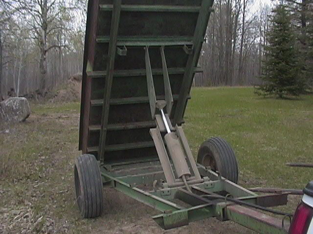

I am going to start my next project of building a dump wagon. I have reviewed all the posts over the past year and have seen a lot. I am inclined to go with a 5 ton set of Kory running gear. I have reviewed designs of hydraulic cylinder placement (the haywagon pictorial in particular), and I am interested in how the scissor lift option works. Does anyone have any closup pictures of a scissor lift on a dump trailer?

So based on my review of the pictures I have seen, it looks like contracting the cylinder expands the scissor. Is this right? If so I need to consider the pull force of the cylinder rather than the push force.

Larry, I have had several dump trucks and all of them expanded the scissor by extending the cyl. I don't know where you are but if close to central NC, I've got a telescopic cyl that someone can have

Thanks for the offer, I am in upstate NY. I was thinking about a scissor lift since it would translate the lateral force of a cylinder into vertical lift. I have looked at a number of pictures and it appears that many use a standard 4 inch bore 24 inch stroke ag cylinder, but for the bed to lay flat, it seems like the cylinder needs to lay pretty flat and when it extends it creates quite a bit of lateral rather than vertical force. My objective is to use this to build a dump wagon (say 6 feet wide by 12 feet long) on a 6 ton Kory wagon frame. The telescoping cylinder idea is a good one. How short are they or yours? The one I have on my dump truck is really big.

Here's mine a home made 5x9 I bought at auction this spring. Note cylinder is 1 way so your tractor will need a large resevoir when dumping heavy loads My JD A (3 qt resevoir) will not fully extend & dump 2 yards of wet clay. Smaller stuff is ok.

Thanks so much for your photo, that is most helpful.
