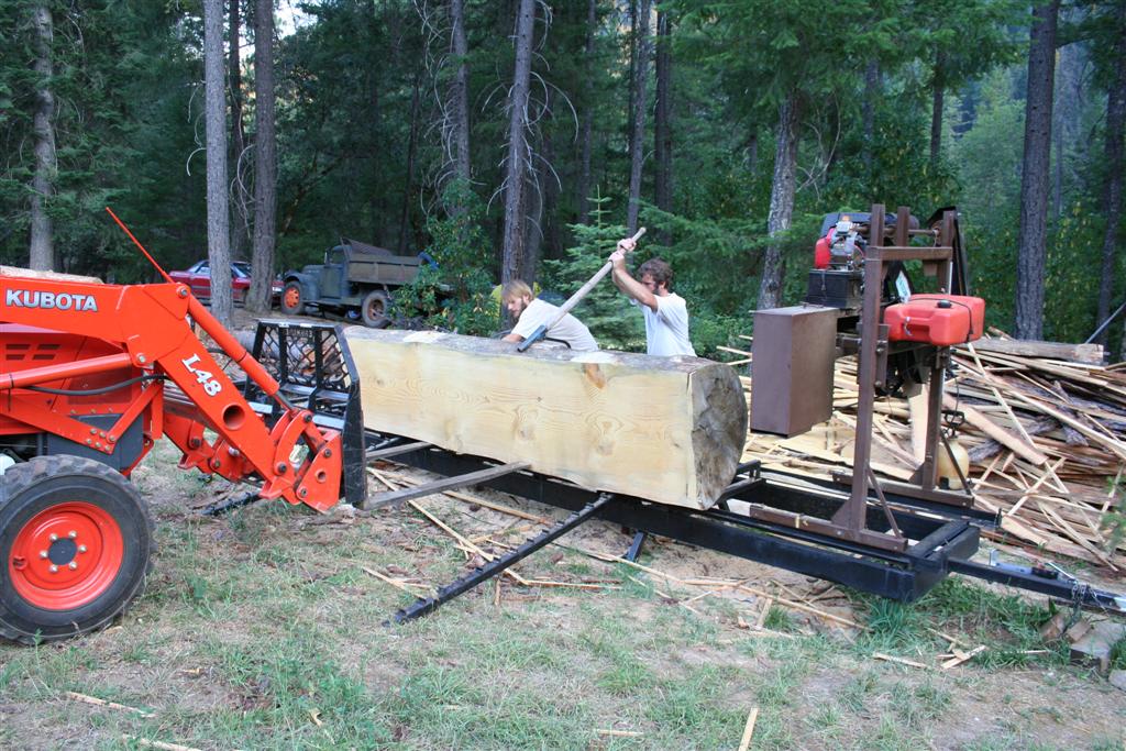

Just got off the mill tonite. Lots of milling going on this year. Today we did a mix of Alder, Madrone and Cedar. Tommorow will be salvaged fir.
When milling quatersawn we listen to the Log. But mainly saw it flat on the bandsaw and keep flipping and flipping lots of up dogs down dogs. after a while you don't even hit your knees! We decide as we go depending on the Log.
We mainly mill in beams. 6x4,6x6,6x8,6x12 4x8,4x12 and 1x. the 2x is a by product for us and 2x, 6x studs are really cheap by the truck load.
Were surrounded by tight grained big diameter 2nd growth Doug fir, pine, cedar with mixed old growth. we also have hardwoods Madrone,oak, and various other species. Milling any log over 36in is a pain in the arss.
Love the satisfaction Home Milled Lumber gives me
