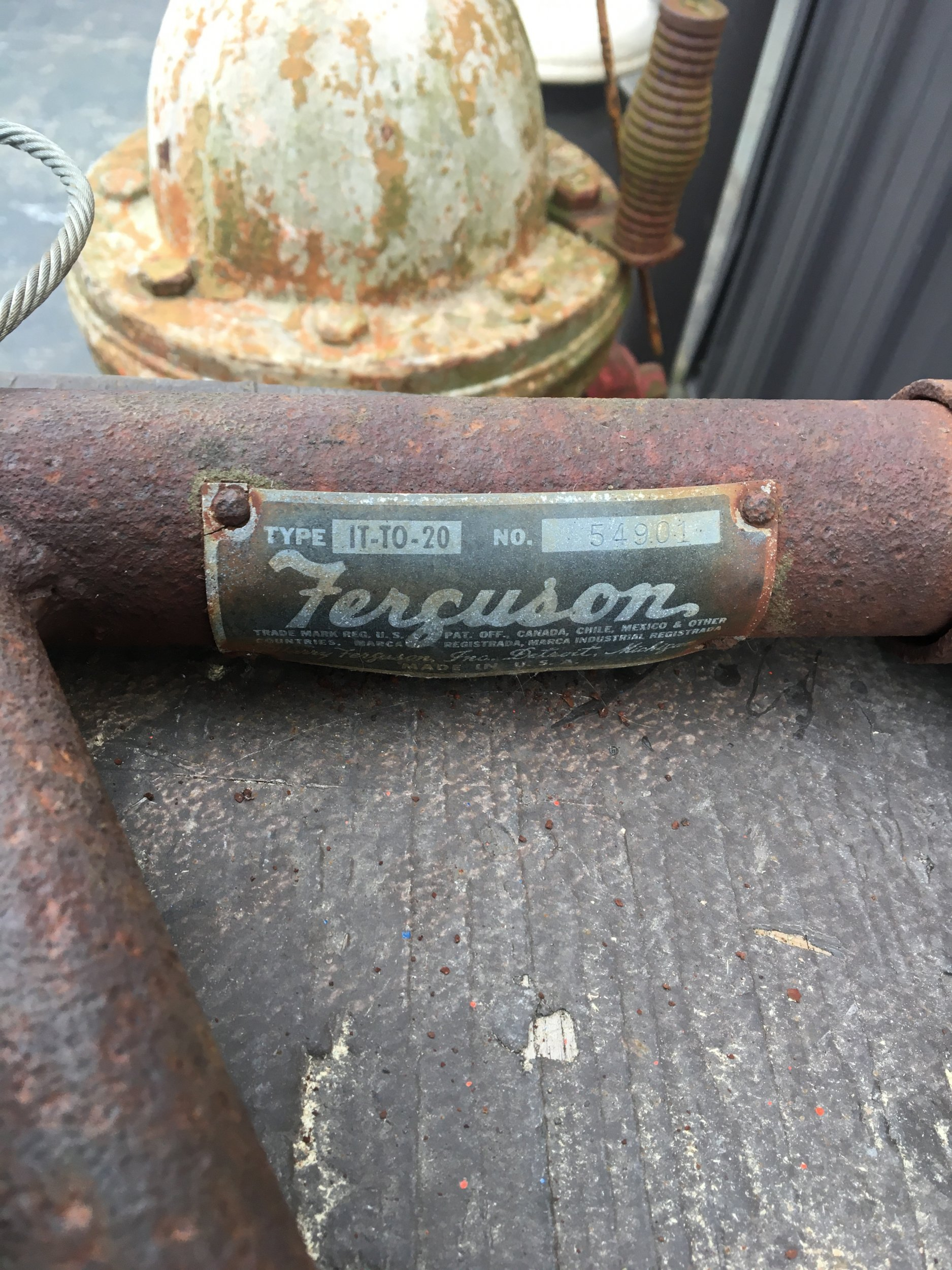

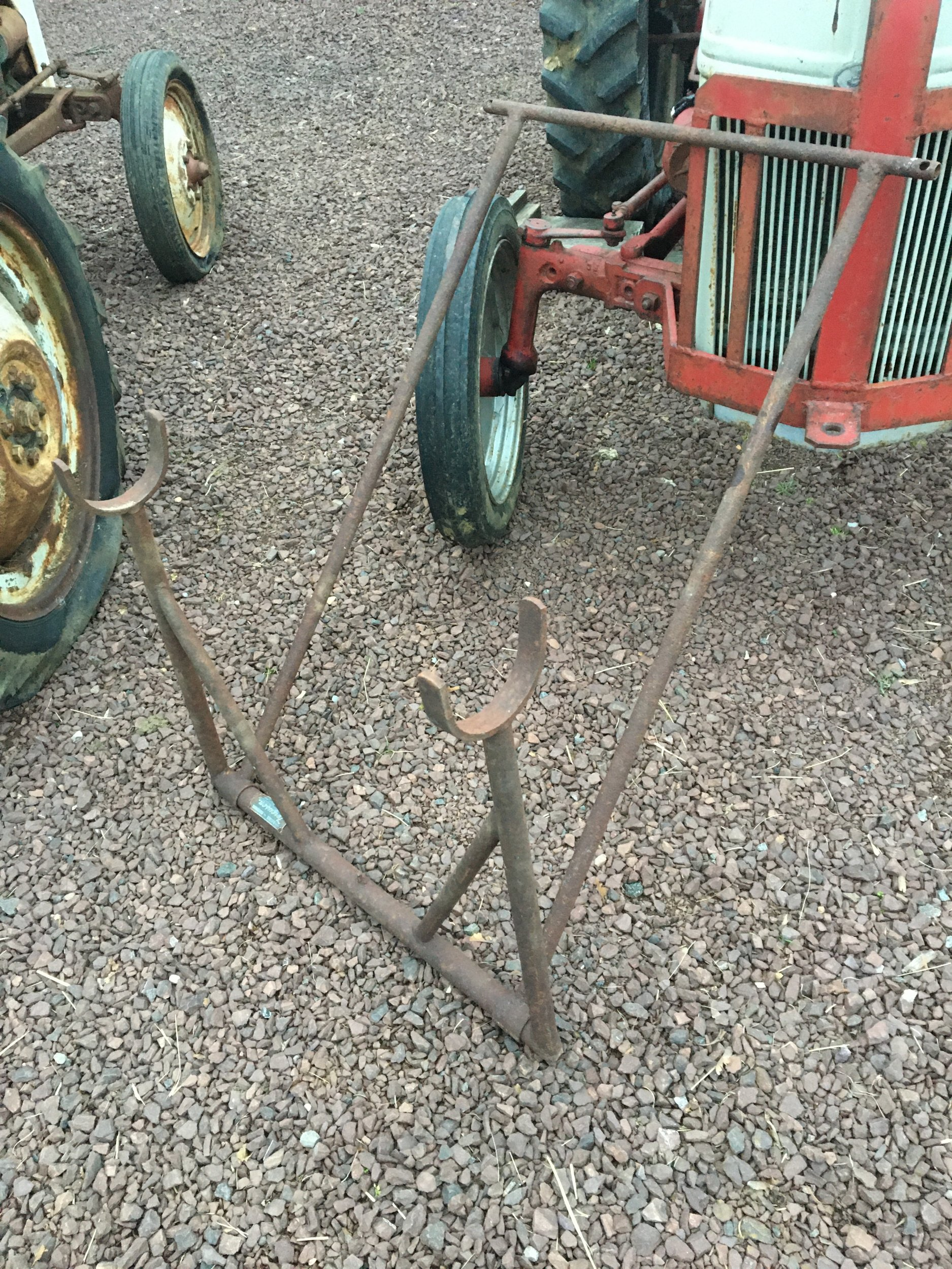

Any thoughts what this is....Ferguson type IT-TO-20 see pics...Thanks
   / Any thoughts what this is....Ferguson type IT-TO-20 see pics...Thanks #1
micster
Jun 9, 2022
2
toro
picked up a couple 8ns and this was in field with them any thoughts on what it's for tag says Ferguson type IT-TO-20 Thanks
   / Any thoughts what this is....Ferguson type IT-TO-20 see pics...Thanks #2
It's a jack of some sort for sure. For what, it will be interesting to find out.
   / Any thoughts what this is....Ferguson type IT-TO-20 see pics...Thanks #3
it's a jack that uses the 3pth to lift the tractor for tire change.
   / Any thoughts what this is....Ferguson type IT-TO-20 see pics...Thanks #4
The owners manual for my old 8N had instructions for using that type of lift.
Definitely need to place jack stands under the tractor, would never want to depend on the 3 point to hold the tractor up with the engine off!
   / Any thoughts what this is....Ferguson type IT-TO-20 see pics...Thanks #5
That's cool! Some quick searching shows there's a front piece that goes under the front axle and you can lift all 4 wheels off the ground with the 3pt. Neat.
   / Any thoughts what this is....Ferguson type IT-TO-20 see pics...Thanks #6
yes a jackstand....but for a little aside is not a stand for a 8n.... Its a stand for an original Ferguson. (Massey)
The Ferguson was a 20hp tractor made in England after the end of WWII. I think they made some in the US as well. Made for the guy who still ran horse teams but wanted to get into something more "modern". These 20hp tractors could do a ton of work!!
They only made it for a couple of years after the war. TO-20 stood for a 20hp tractor that was meant for export "overseas" (tractor overseas). Its claim to fame was one of the first tractors with hydro 3pt hitch.
Ferguson merged with the Canadian company called Massey-Harris to become Massey-Harris-Ferguson somewhere late 40's or early 50's and the company folded shortly after the merger.
Thanks for the info
