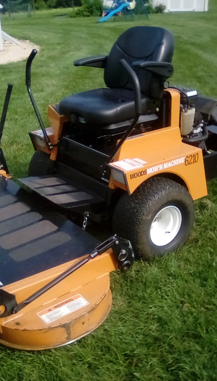

Rebuildable only means as long as they make parts for that transmission. I have one "2" in my Woods ( grasshopper) that that's rebuildable but from what I hear there are no parts available any more. Mine's 22 years old so maybe I'm expecting to much..? I forget the name of the transmissions used in this one but that's what I'm up against if one ever fails.
