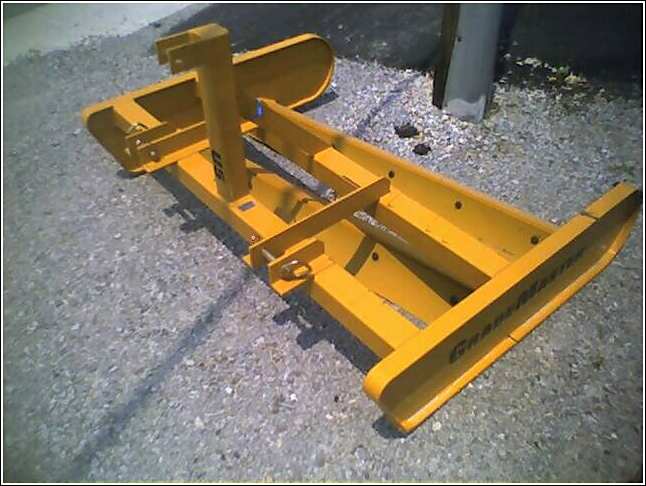

What about using a GradeMaster? It is sort of like the Land Plane but not quite the same. It is available in smaller sizes, the 5' model would be suitable for a 30hp tractor.
