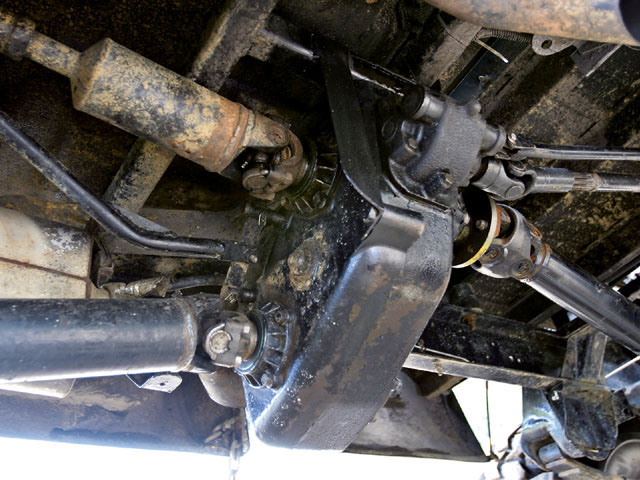

I love the idea, but please elaborate on "divorced transfer case".
   / Any truck tractors? #5
Google Uni mog, that is exactly what they are. LUTT
   / Any truck tractors? #6
A divorced transfer case is one attached with a driveshaft to the transmission. Not coupled directly to your out put shaft on the very end of tranny, LUTT
   / Any truck tractors? #7
There is a short, exposed driveshaft between the transmission and the transfer case. When"married," the transfer case and the transmission case are bolted together, or are one unit.
Bruce
Divorced:
Married:

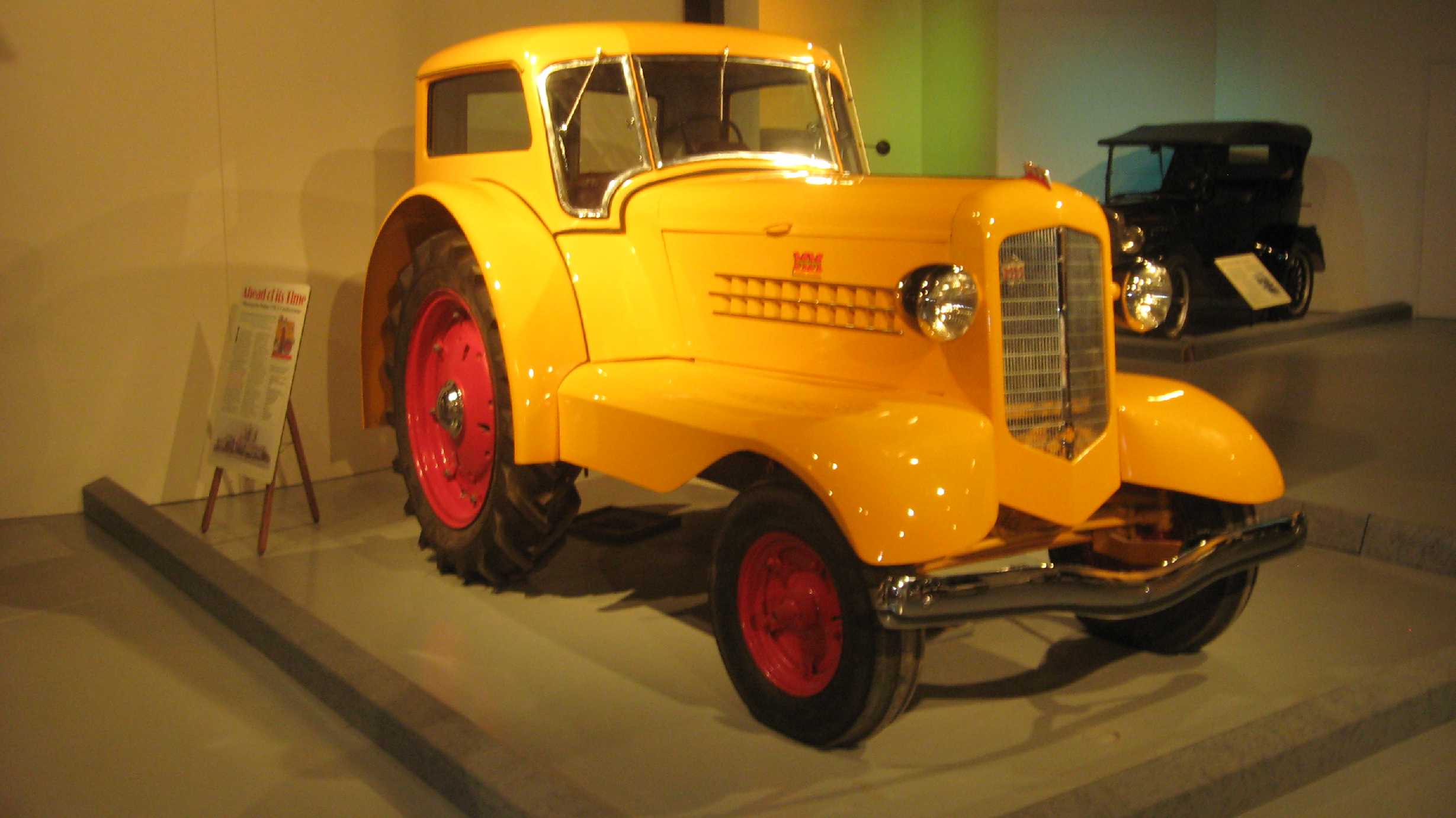

   / Any truck tractors? #10
Here is a nice one.
