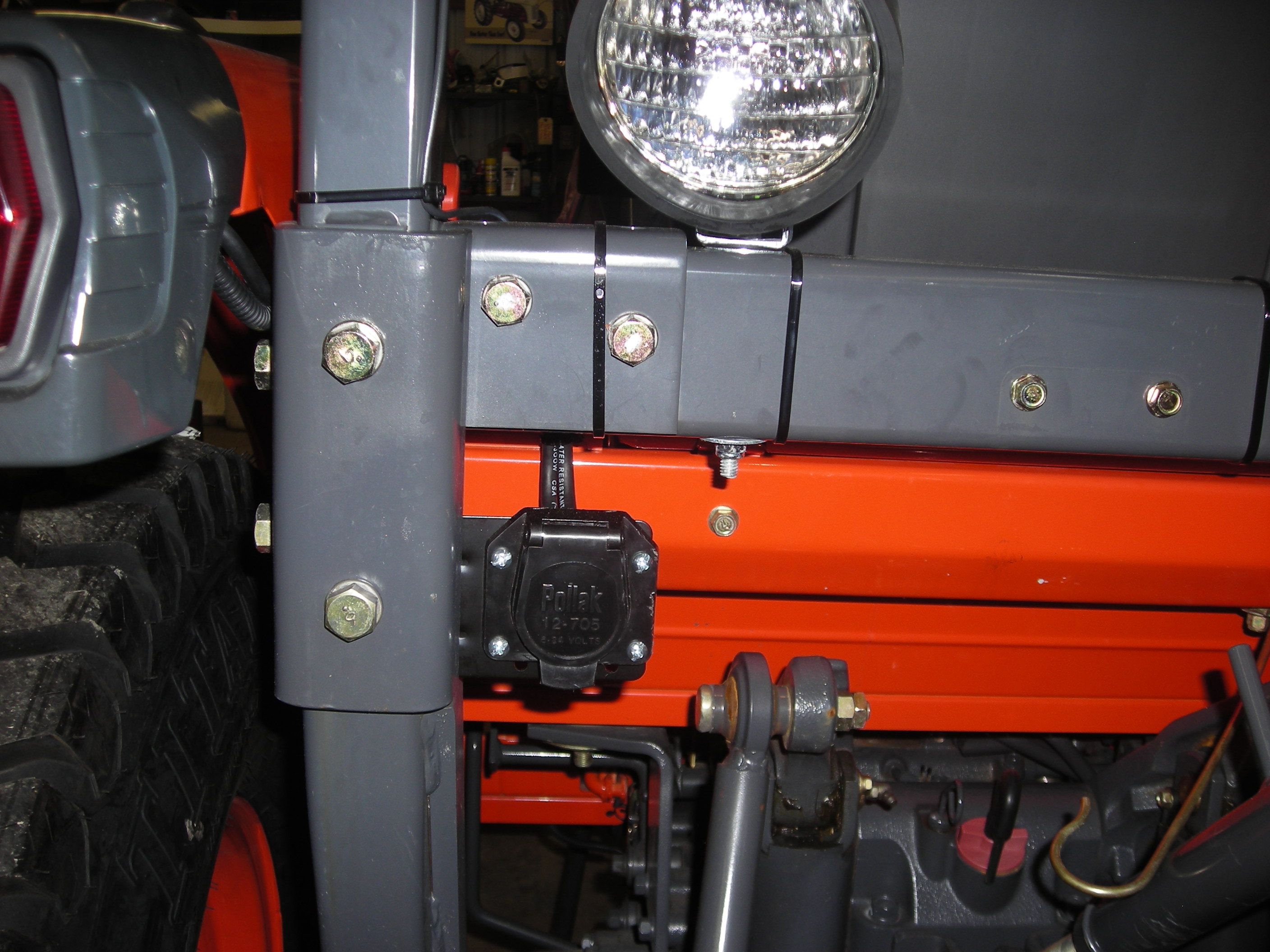

As my wife slowly replaces older implements they all seem to come with a full array of lights: brakes, flashers and turn signals. This week the new grain drill came in and it has them too. I looked through the build to order section and didn't see it as an option on the Kubota. Can one be put on a L3940, it's a big round plug with I think 7 connectors. The CaseIH 5140 already has it. With the way people drive around here these days you need all the warning lights you can get.

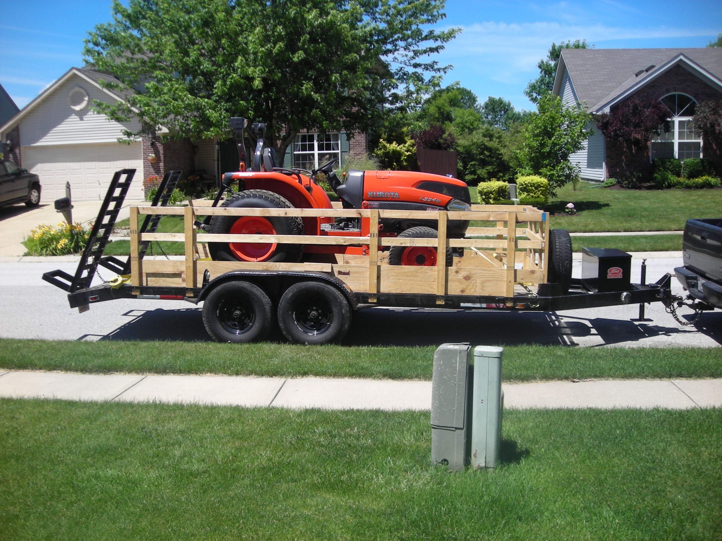

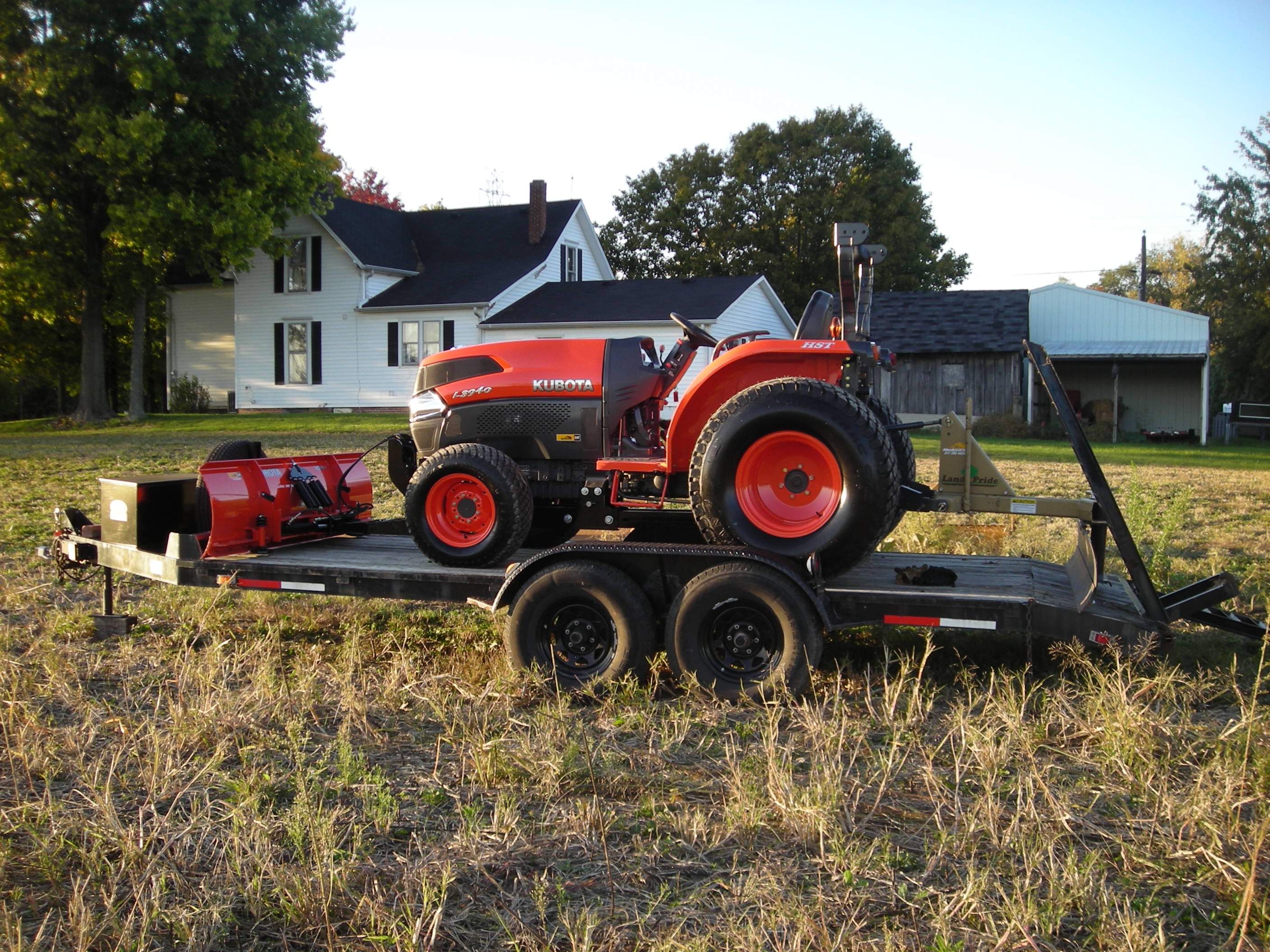

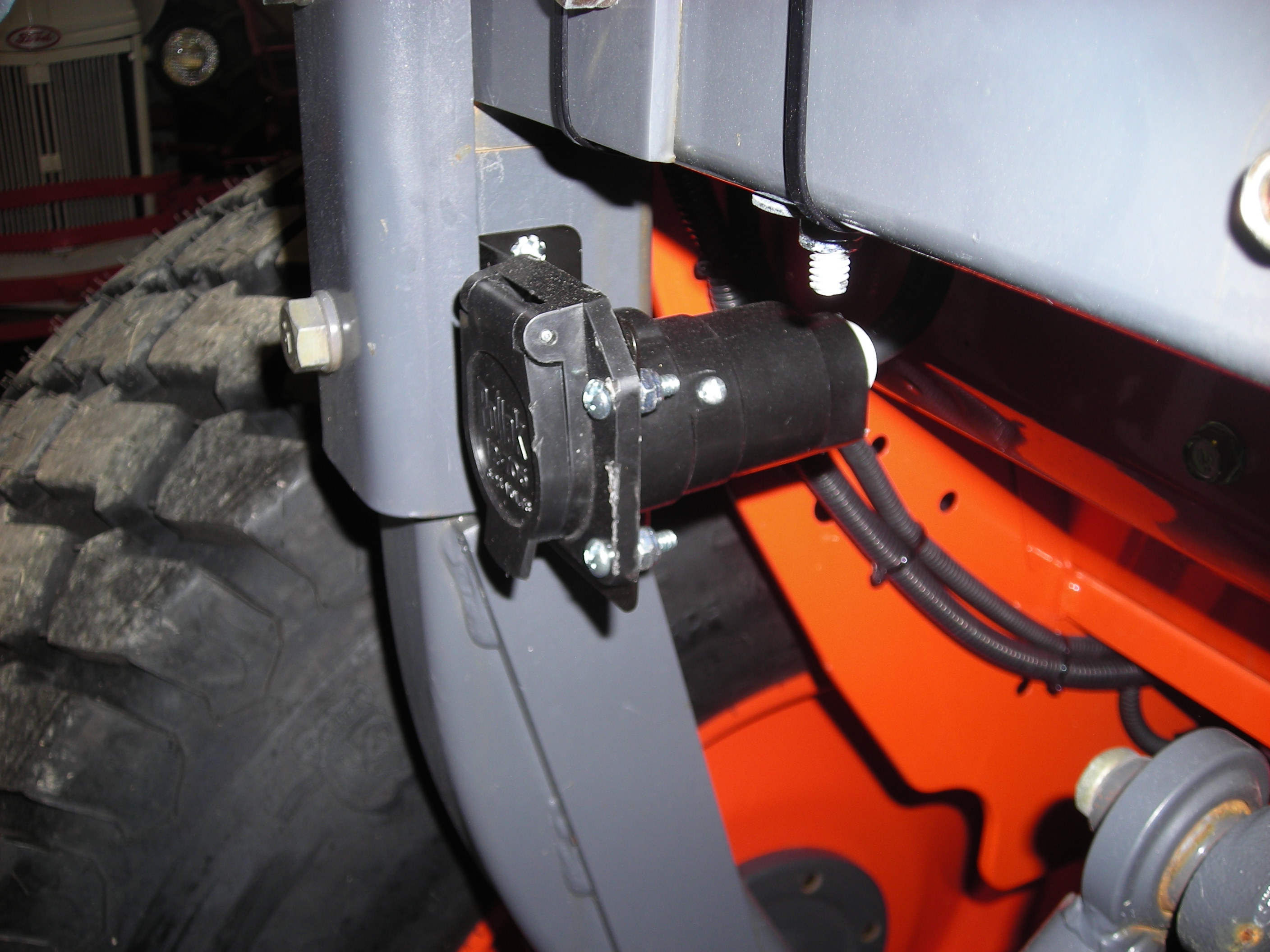

When I wired this 7-way RV plug in I just taped off the running lights, left turn, and right turn at the back of the tractor. I even have constant voltage on the 12VDC+ pin so it charges the breakaway battery. I have taken my 16' +2' trailer down the road a few times loaded with implements, and even used it in a parade. Pretty simple to wire up and no issues. Sorry, no pic of the L3940 actually pulling the trailer, have to get that next time. Philip.

Thanks Philip. That's a nice clean installation too. We're going to have a set of
hydraulic hook ups added to it so I'm going ask the dealer if they've ever done it.
