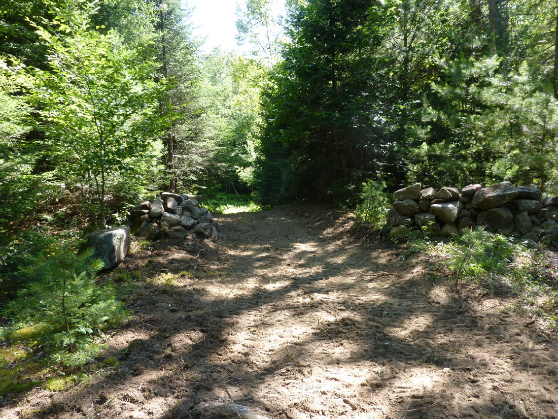

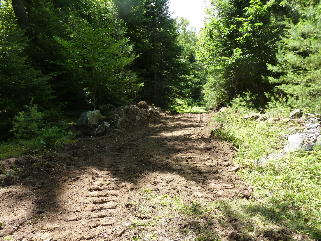

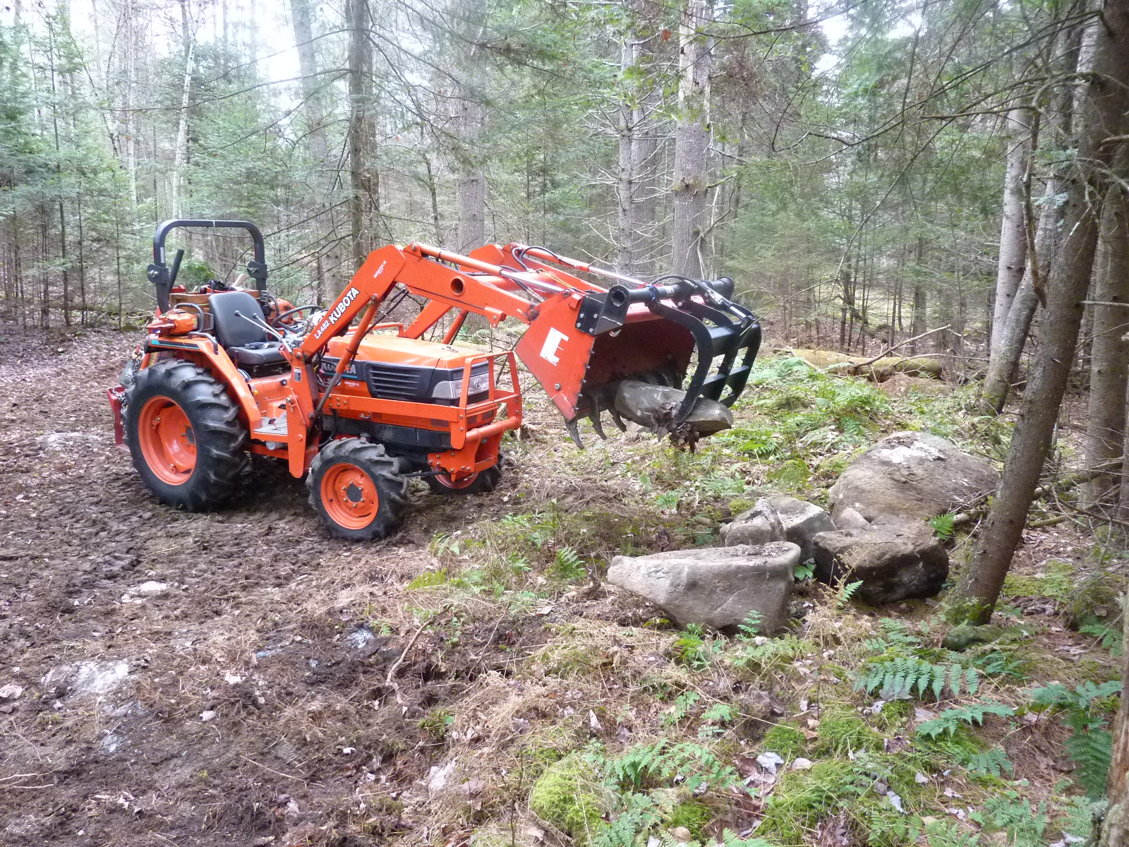

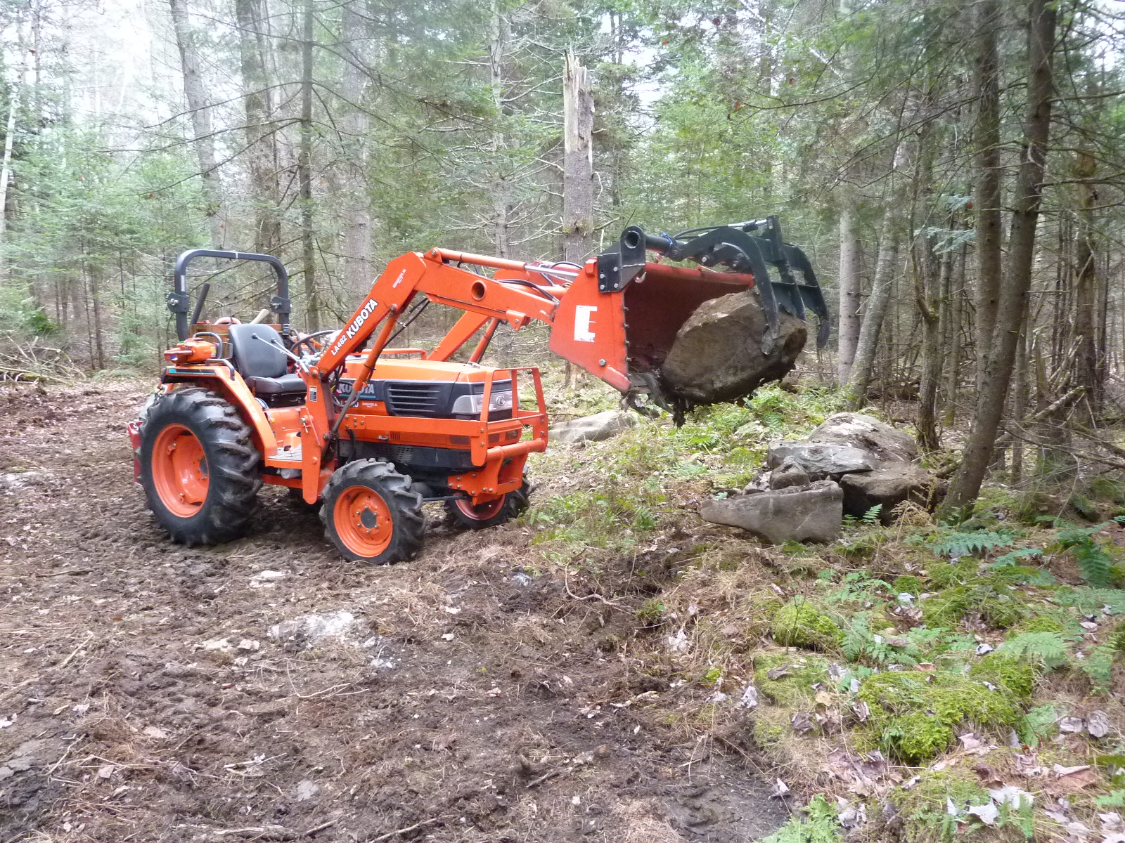

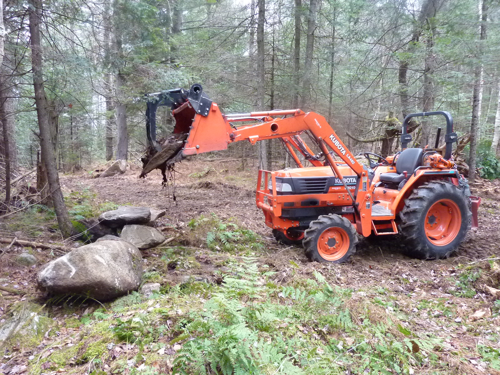

I have an ATI. I haven't seen many pictures of thumbs in use but people say they like them. You asked about moving rocks for landscaping. Closest I can come is rebuilding an old rock wall that had been broken down by a log skidder. This was before I added the tooth bar to the grapple.

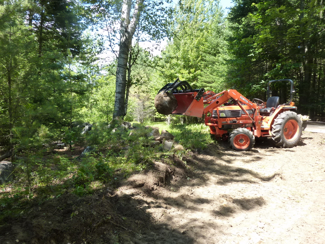

First I ran the dozer thru to make a tractor wide opening. Then I rebuilt the wall using the grapple to move the rocks.

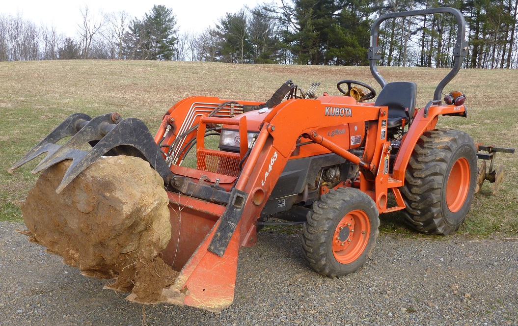

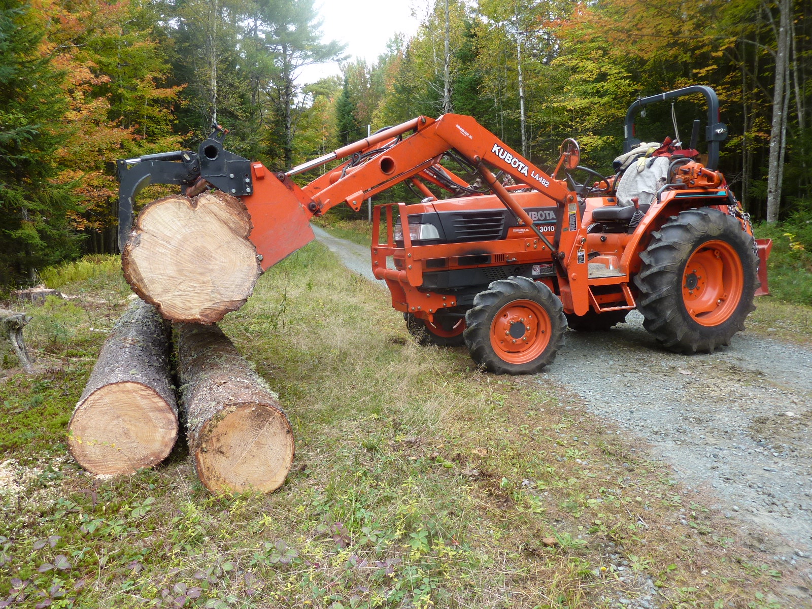

I used it like that for a long time and it worked very good. Then I added a tooth bar and it was like a different grapple.
Adding a tooth bar really enhances the grapple. When I got the tooth bar I also moved the grapple mount forward to give me a bigger opening so that the grapple surrounds and object more on a grab. I added some tine extensions too to get a tighter bite.

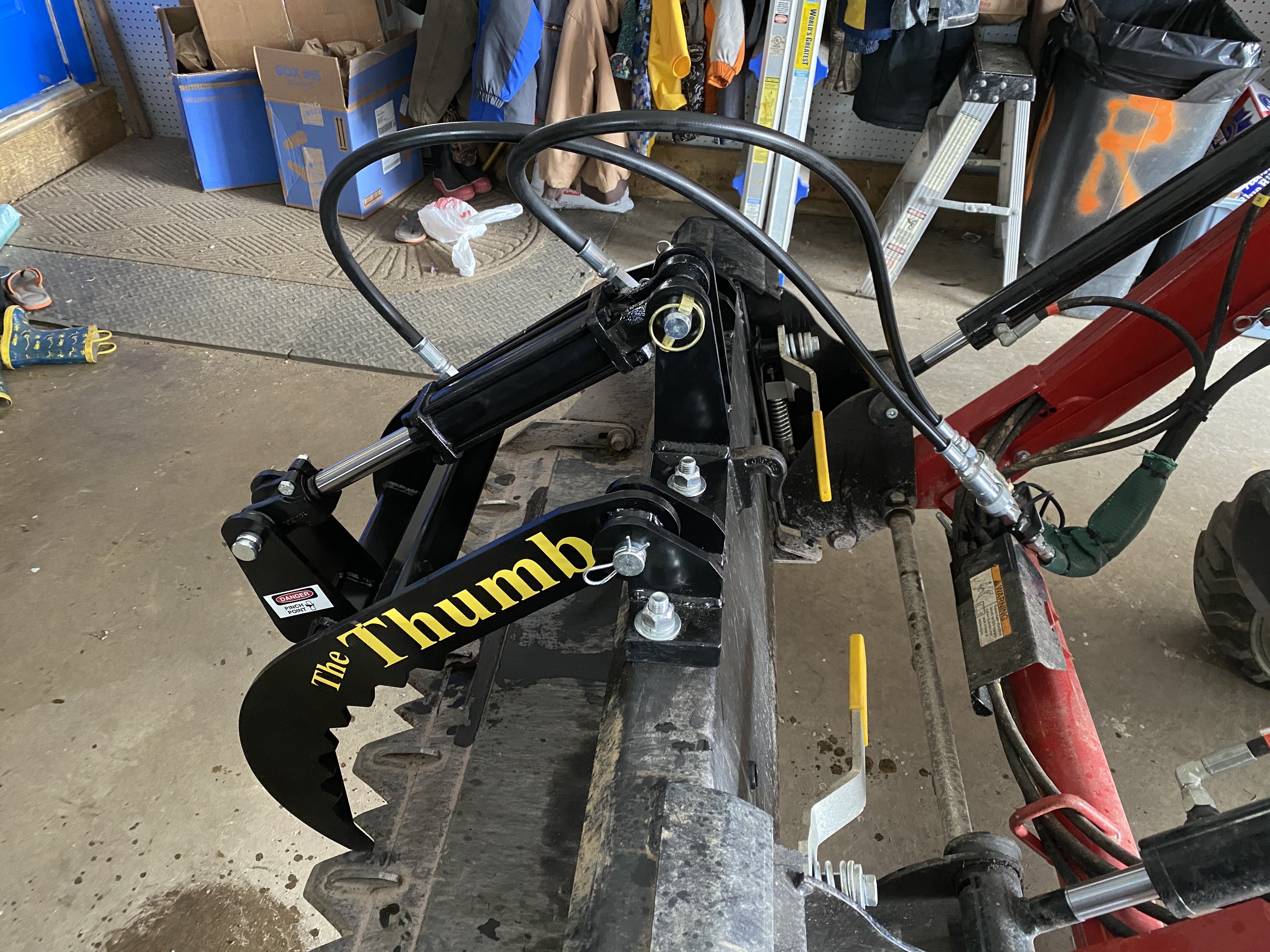

Green's machine thumb+tooth bar;best addition to mine.

I went with Greens for the portability. Plan is for extra bases on the pallet forks and brush forks.
