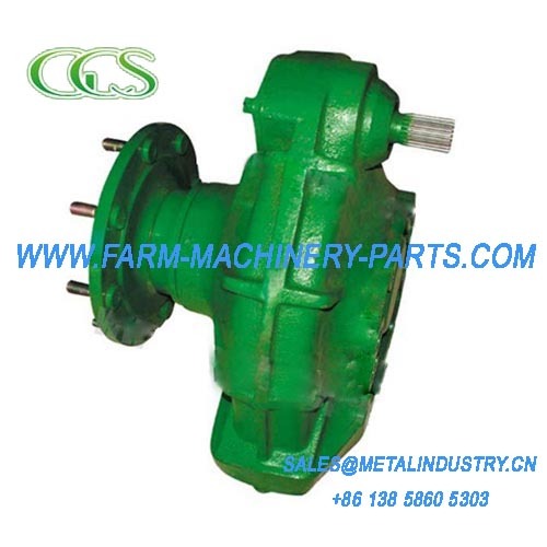

I thought about using a old combine hub reducing gear, with hydraulics one should be able to reverse it if you get it stuck, you will not be doing that with a PTO unit,

The combines I am failure with there usually a bull gear and a pinion, in a gear case,
the combine, use a lighter transmission and then the wheels are bolted to a reducing gear case, that takes the strain of the unit, Called the final drive,
my choice is that I have a old parts machine that I could use and the cost would be "Free"
picture from this site, Final Drive Gearbox for John Deere Combine Harvester, China Final Drive Gearbox for John Deere Combine Harvester, Manufacturer & Supplier

When I was considering doing this I was wanting to build a unit that would work a 24" to 36" auger for setting posts for a pole barn, (my SIL was starting to build pole barns and considered building to help him, (the power company was cheaper to hire than to build our own) so I never went much more than the planing stages, (besides discovering the seals leanking in the final drive I had would have needed to be replaced as on end they leaked, the drive was from a old MM/cockshut combine,
