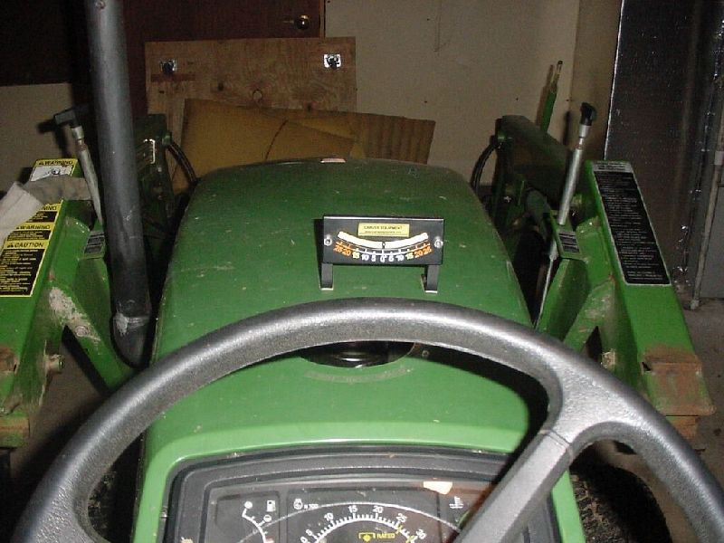

Very easy to install. First thing you'll need is a level spot to park the tractor while you install the tiltmeter.
The kit has doubled sided tape, or you can drill two holes for the mounting brackets. Since my tractor was an older model, I drilled the holes.
Install it somewhere you can easily see it.
As far as usage... I installed this shortly after getting my 670. What really helped me is knowing how small an angle some of the areas I mow were. A big help in acclimating myself to operating the tractor (my first...not the first I've operated though).
Initially, you'll look at the meter all the time. Once you've used it for a while, an occasional glance when you operating on known areas is all you'll need.
They aren't expensive...$35 or so...and definitely a value-added item for the novice tractor operator.
Just remember they're an aid..but no replacement for common sense!

GreenAcres, there are several different ways they can be mounted and locations in which they can be mounted. I mounted mine on my canopy; had two, one for side to side (most important one) and one for front to rear.

I used the double sided foam tape and mounted mine on the cowling just in front of my steering wheel. Easy to see. My ditches have some pretty good slopes in places. The meter pretty much verified my pucker factor calibration.
My meter has both the side to side and front to back indicators in one assembly.
