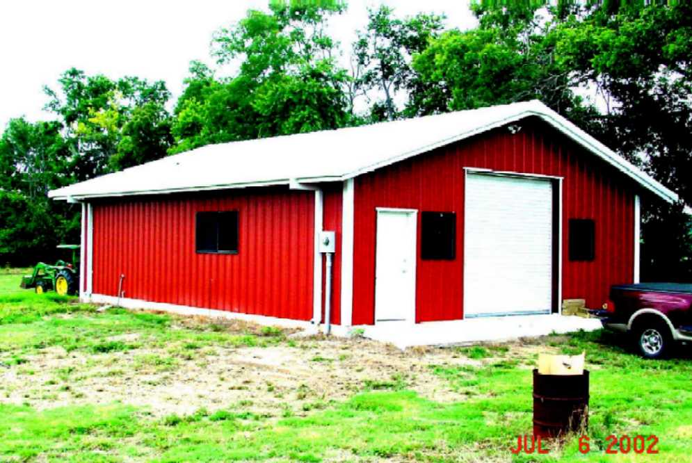

I'm moving back to Texas in a few months and will have 6 acres in Wise County.
Looking to put up a 30 x 40 (approximate) shop/Tractor shed without spending my life savings /forums/images/graemlins/smirk.gif
I ran across the Steelspan web site www.amsteelspan.com and their products look pretty good.
Anybody put one of these up? Experiences or recommendations?
Thanks
   / Anybody put up a Steelspan Building? #2
Not familiar with Steel Span. I put up a 30'x40' <font color="blue"> Mueller Steel building </font> several years ago. If you are into doing it yourself, not a bad way to go. Mine came as a bolt up kit. You can also get weldup kits. I had a concrete contractor do the slab. Had some friends help with the main beams and the roof panels. Then did almost all the rest by myself. You can get a basic 30'x40' for around $7000 I think. I got a lot of options such as insulation, extra doors, gutters, etc. for around $9500, but that was 5 yrs ago. See attached picture.
