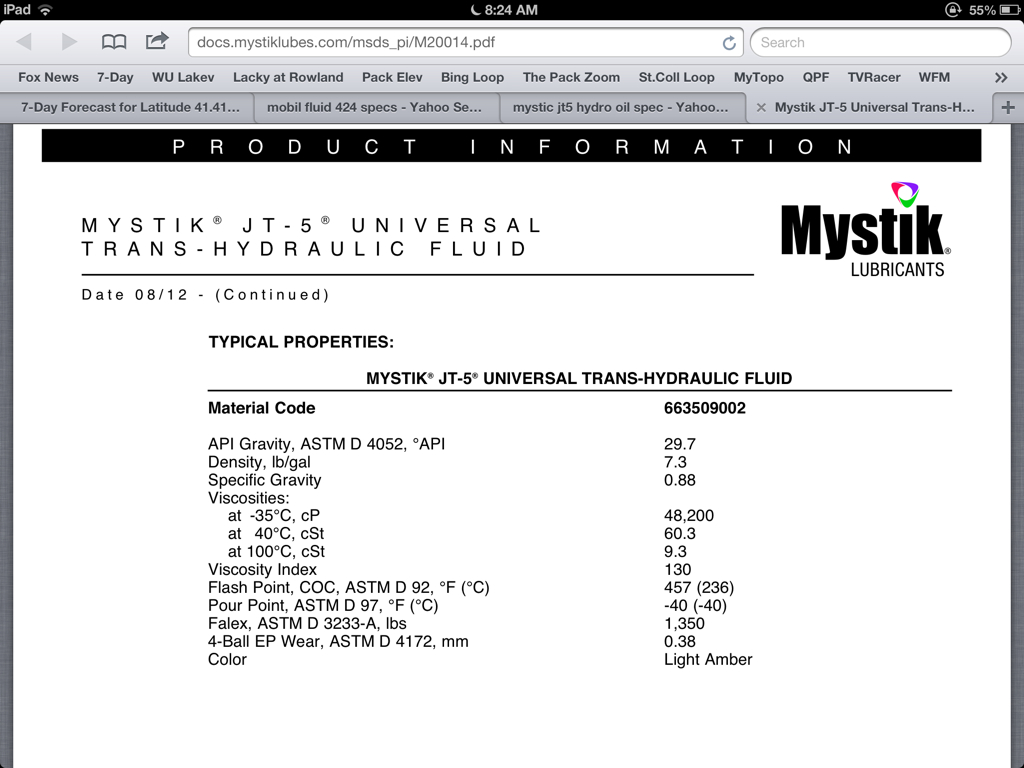

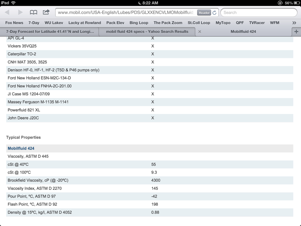

   / Anybody running MyStik JT5 instead of Mobilfliud 242? #7
Eric, here are the Mobil and Mystic specs. Their -40*C viscosities are very high, Mobil does not even show it. Neither of these are a colder climate rating. I am assuming that since you are in Minnesota that this would be a consideration. I am having to dump the fluid in both of my machines after only 50 hrs. because I am not at all happy with the performance after the dealer did the 50hr. hydro fluid change. In the summer the tractor is sluggish and in the winter, 30 min. warming up at 1500 rpm with pto spinning the snow blower just to get it sluggish.
This fluid will be in your tractor for many hours don't be to frugal.
I don't want to start another hydro oil debate, just giving Eric some info to look at.
