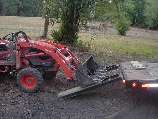

As promised, the rest of the story with pics!

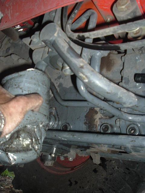

So here is a pic of the damage, #1. See how the filter pole vaulted off of a three foot cedar branch fragment on the ground. The branch was laying flat when I went over it. The nipple for the filter snapped and the rest of the mount is fine.
So then after a brief pondering I decided to get the trailer as close as possible to head on and near the tractor. Luckily this went pretty well though the trailer was much higher than the tractor which means the ramps were pretty steep.
Then I retrieved the trucks scissor jack to raise the bucket enough to get a chain under it and also to curl the bucket enough to prevent the bucket teeth from hanging up on the ramps.
Pic #2 is after I ran the (Grade70!)chain around the nose of the tractor frame and began winching the tractor onto the ramps with a come-a-long. A 2-ton cheapy model that performed adequately for this task. Note the lumber for skids and also I discovered that as the bucket goes up you must relieve the hydraulic pressure to allow the bucket to raise without the front end of the tractor also raising. As I winched the machine towards the trailer I had to steer the wheels by grabbing a tire and turning it. Thank goodness the tierod keeps them aligned. Also note the bent rear rubrail since the chain links would grab as they slid over the steel at that point.

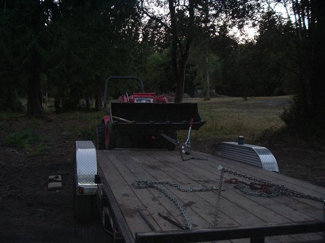

Pic #3 is a trailer deck view of my winching setup. This manual winching is work. Note how when you are winching that you are very much in harms way if a chain or cable were to break. I reset the winch three times as I ran out of cable and needed to take another bite.

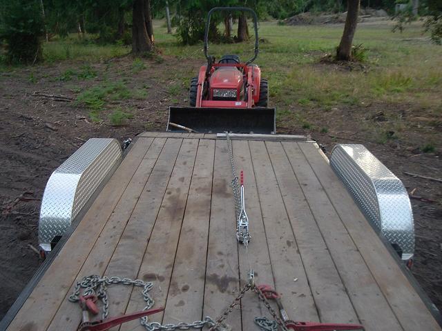

Pic#4 shows her coming up and about to break over the top. I had to be sure to let the mower go up as high as it could which happens at the same time the rear tires hit the ramps. Then I locked the 3ph drop so that the mower would stay up and not slow the climb down. Note that it is getting dark here and I was running out of beverages.
Pic #5 shows the tractor up on the deck and about to be tied down. Thank goodness for the LED headlamp I keep in my pickup. It was dark, I was thirsty.

So has anyone changed the filter mount? Is it hard? I have new O-rings and the parts blowup looked real simple. Maybe I should have bought two!
