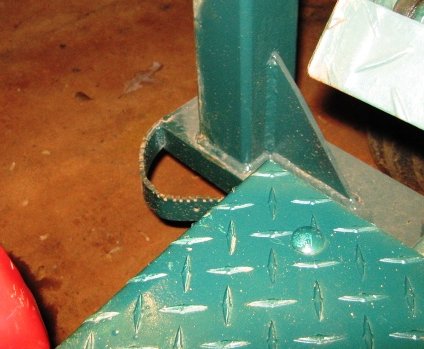

I though all yanmars had a step.I have 1 that is like a ring step that hangs from the bottom of the platform

I made this from a surplus switch panel.

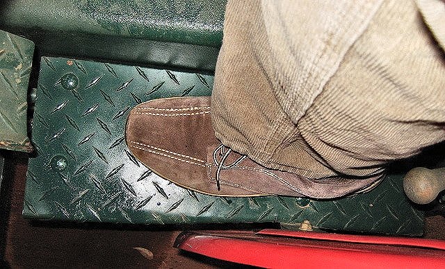

California, I'm sure this give you a good size step,:thumbsup: Have you ever considered installing larger foot-boards? It can be done, Not only does it provide more foot room it helps to prevent things from coming up onto the foot-boards from the ground,;)
Story: Once back when I had my Kubota and working in clearing the badly covered underbrush and vines on our property the tires picked up a vine wrapped around the axle and happen to wrap around my foot and the foot-board, luckily my foot was resting on the clutch peddle and when the vine tighten it pulled the clutch in stopping the tractor, I put the tractor in reverse to try release the tension enough that I might pull up my foot, but could not, so I shut down the tractor got out my ol-pocket knife and cut the vine away, This along with the size 12 foot was one of the reasons when I got the Yanmar I needed to build and change out to larger foot-boards, They are now from against the axle and go 2" closer to the clutch and brake peddles, I also made them wider from against trans housing and notched them around the fenders, In other words there are no gaps left anywhere at the foot-boards for anything to get up through, it was an easy conversion, and still looks factory from using diamond plated metal,;)

Have you ever considered installing larger foot-boards? It can be done, Not only does it provide more foot room it helps to prevent things from coming up onto the foot-boards from the ground)
I never thought of making larger footboards but you're right, the way they are attached it would be easy to make replacements.

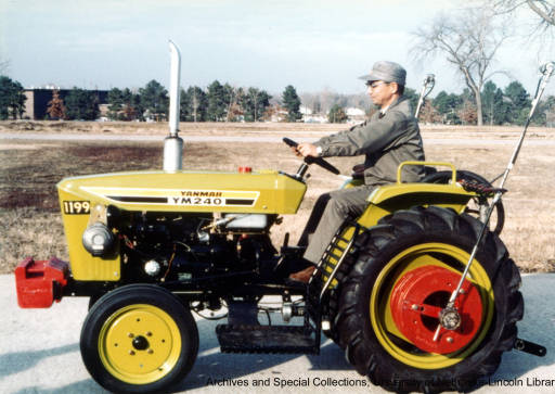

Check out the factory side step on this ym240 from 1976.
