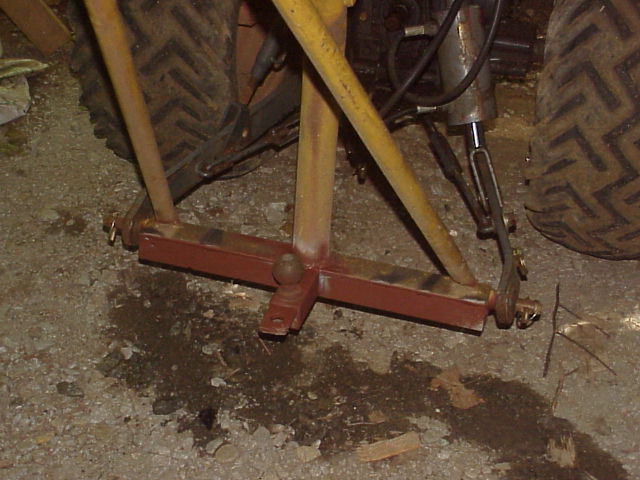

The "hitch" I'm making is located at base of the boom where it connects to the 3ph arms...not much different than my draw-bar hitch attachment...

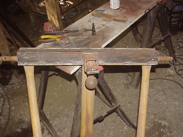

Here's what I did...this was really a simple mod that will save me untold time...the pictures are not the best...They seem to make it look a little off but everything is square and true...the existing tang is a little off...I did ream the (chain hook?) hole big enough for a shackle pin though...
...A boom pole is not the most conveniently configured piece of equipment to manipulate around in a confined shop area...especially considering that most of the work was with it upside down...!
The original base of the boom pole was a single piece of 2.5" x 2.5" x 1/4"...I had the section of 2"x2" x 3/16" sq. tubing with the ball and tang already bolted to it (salvage)...I welded it into the existing base angle...then I took a piece of 2"x2" x 1/4" and cut a 2" tab/notch out of one of the flanges...with the notch I made fitting around the 2"x2" square tubing I welded it up...basically creating a 2"x2" bar that is now the base of the boom pole...

Lookin' good, Slash.
Just be careful crossing any abrupt obstacles - humps, swales, etc.
You don't want the front of the tractor pitching up and the overhung boom pole giving your trailer a smack-down.
I see the tilt cylinder in your photo - if you have a top cylinder, too, you can avoid that situation by shortening the top as the nose goes up.
T&T comes in handy in so many unexpected ways!
The added weight of the boom pole should also help prevent any lifting of the 3pt if the tongue gets light.
