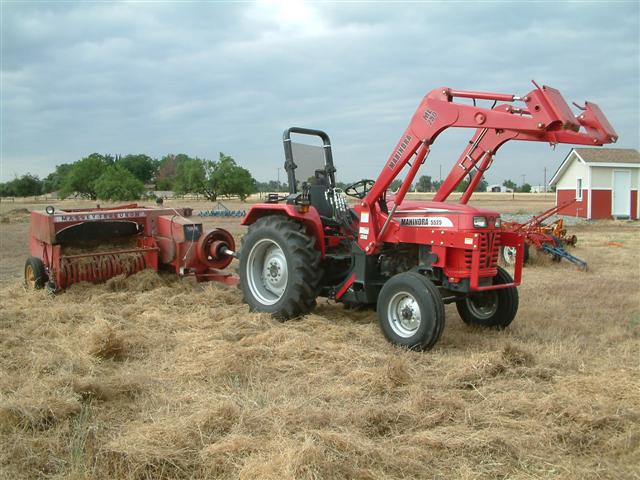

You're down a little on pto hp for a small square baler like my Massey Ferguson 124 (two-twine, small squares) that has a recommended 35 hp (min). But your tractor would handle my 124 without much problem. Here it is behind my Mahindra 5525
Balers this size have been operated with much smaller tractors, like the Farmall Super A in this video that has less than 20 hp (pto)
