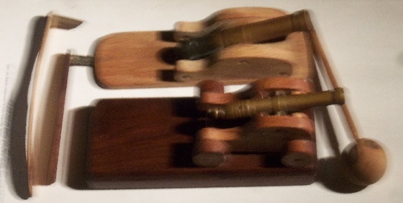

Pictured are 2 little guys that I made several years ago.
The smaller one on the dark base (Walnut) is about 1/4" bore and total length of the cannon is 4.5".
A cigarette filter is a perfect fit in the bore. 1 Small scoop of "4FG" black power and its a little louder than a 38 Special hand gun.
It was used several times on 4th of July & New Years. Then retired and put on a nice looking base.
Larger cannon has a 3/8" bore and is 5" long. What worked out best for a load was 2 of the small scoops. A plastic packing worm was used to pack the powder. It was louder than a 12 gauge shot gun. Had a pretty good kick when hand held.
I think to be completely legal the bore would have to be partly blocked. Enough to prevent a projectile loaded. Personally I would never load any type of projectile in either one of them.
Sorry about the fuzzy picture.
