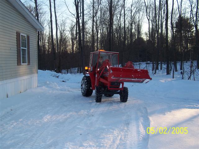

   / Anyone built a tractor cab? #7
I made a reasonably cheap one for my tractor out of angle iron and plexiglass. Not the best but enough to keep the blowing snow from hitting me in the face.
