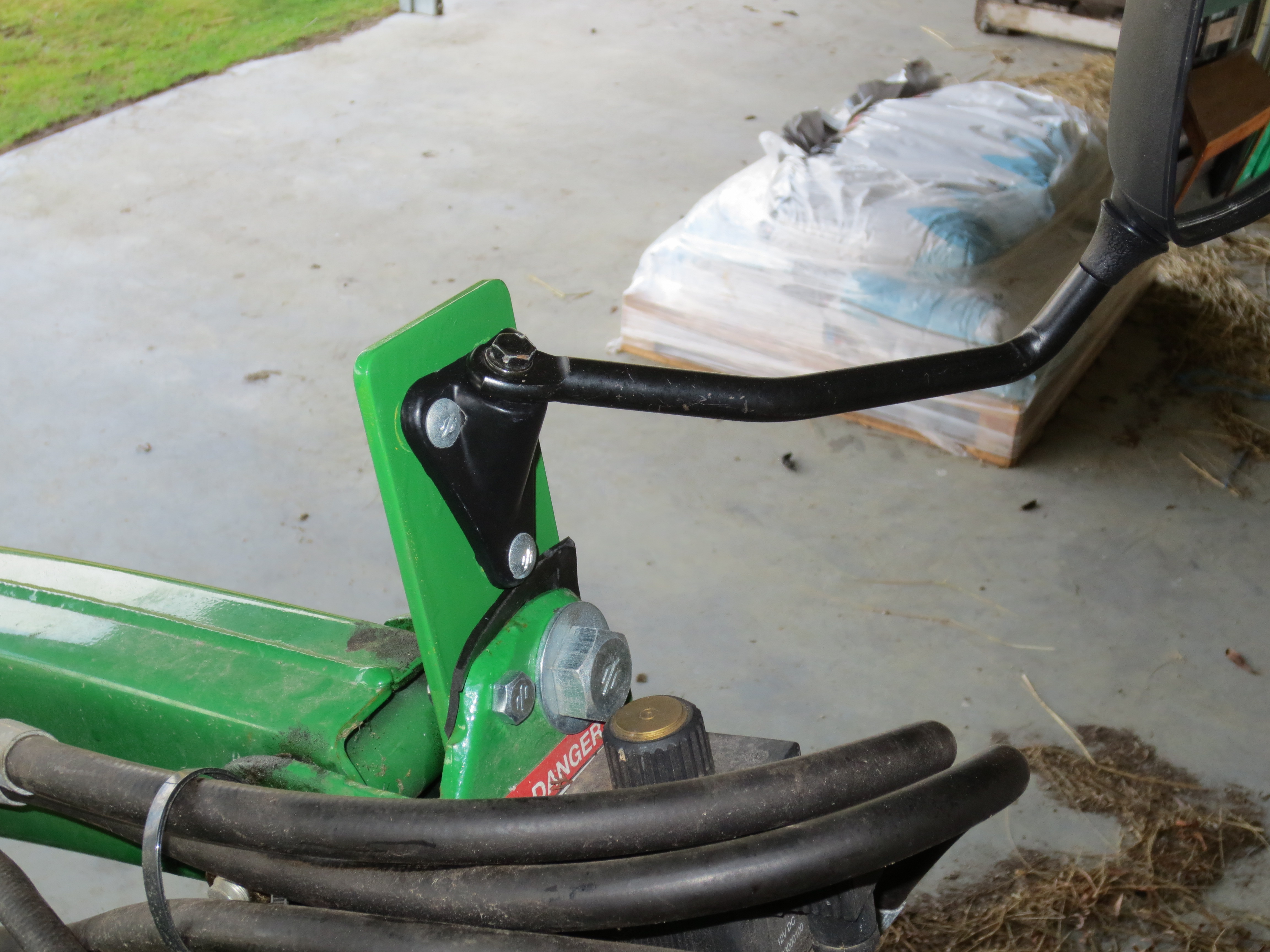

Checking to see if anyone has come up with a way to reduce side view mirror vibration?

This on your tractor?
Where mounted presently?

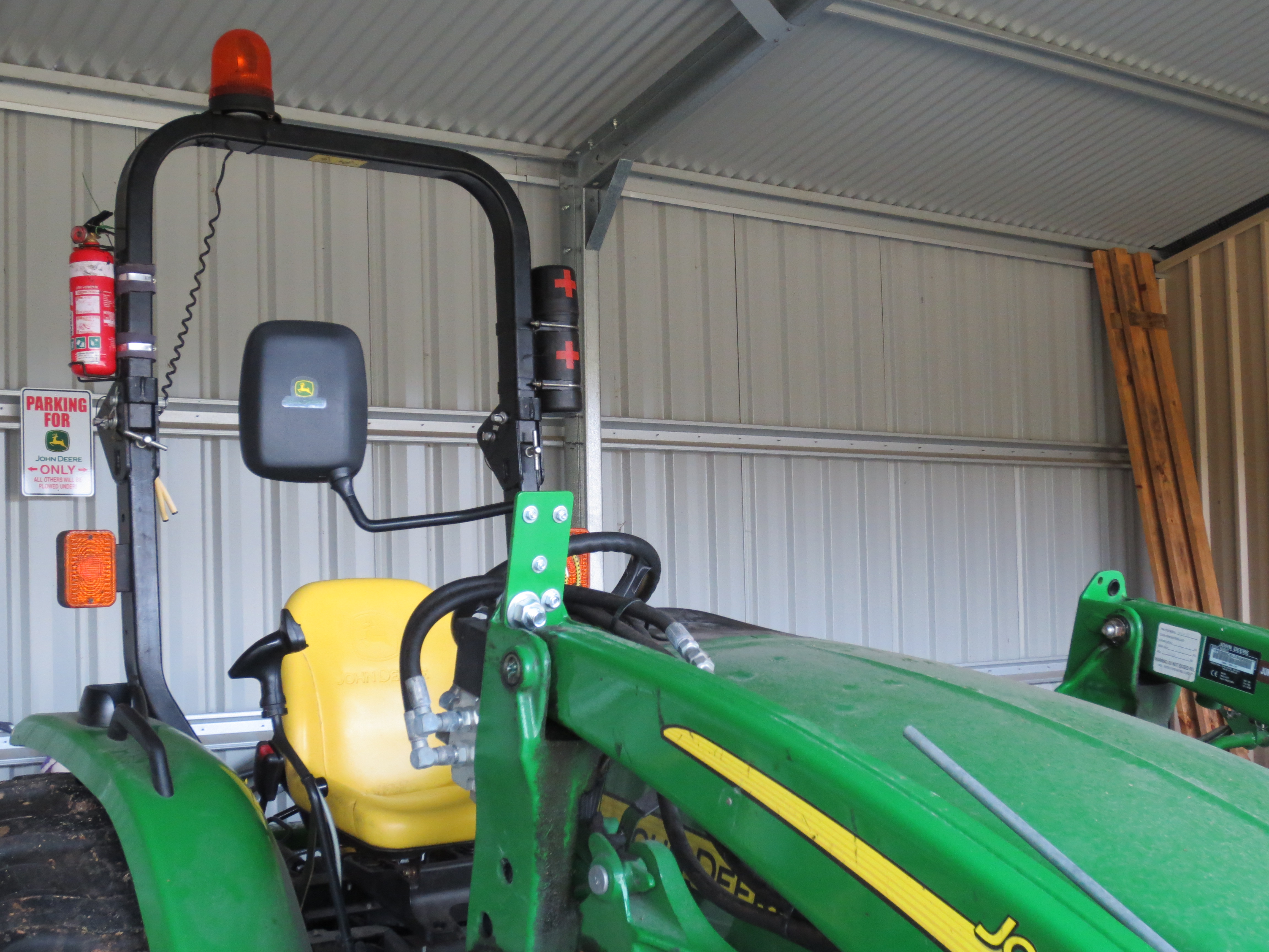

Generally a mirror needs to be attached to something solid like a roll bar or FEL post.
On a fender or on the engine hood expect vibration.

A layer or two of rubber where it's mounted will dampen the vibration effect.
The first picture better demonstrates what I did; a gasket cut from a rubber floor mat = zero vibration on my mirror. (despite the green paint-job & JD logo, this is a 'jury rig' mirror)

You need to change the resonant frequency to something that doesn't match a oft-used engine speed. Sometimes a little weight attached to the mirror is all it takes. I've shot foam into the cavity behind the mirror and that has helped.
   / Anyone come up with a way to reduce mirror vibration? #8
Might add that the longer the supporting arm is the more likely vibration will occur.
The arm length vs the RPM could possibly result in harmonic vibration as well.
