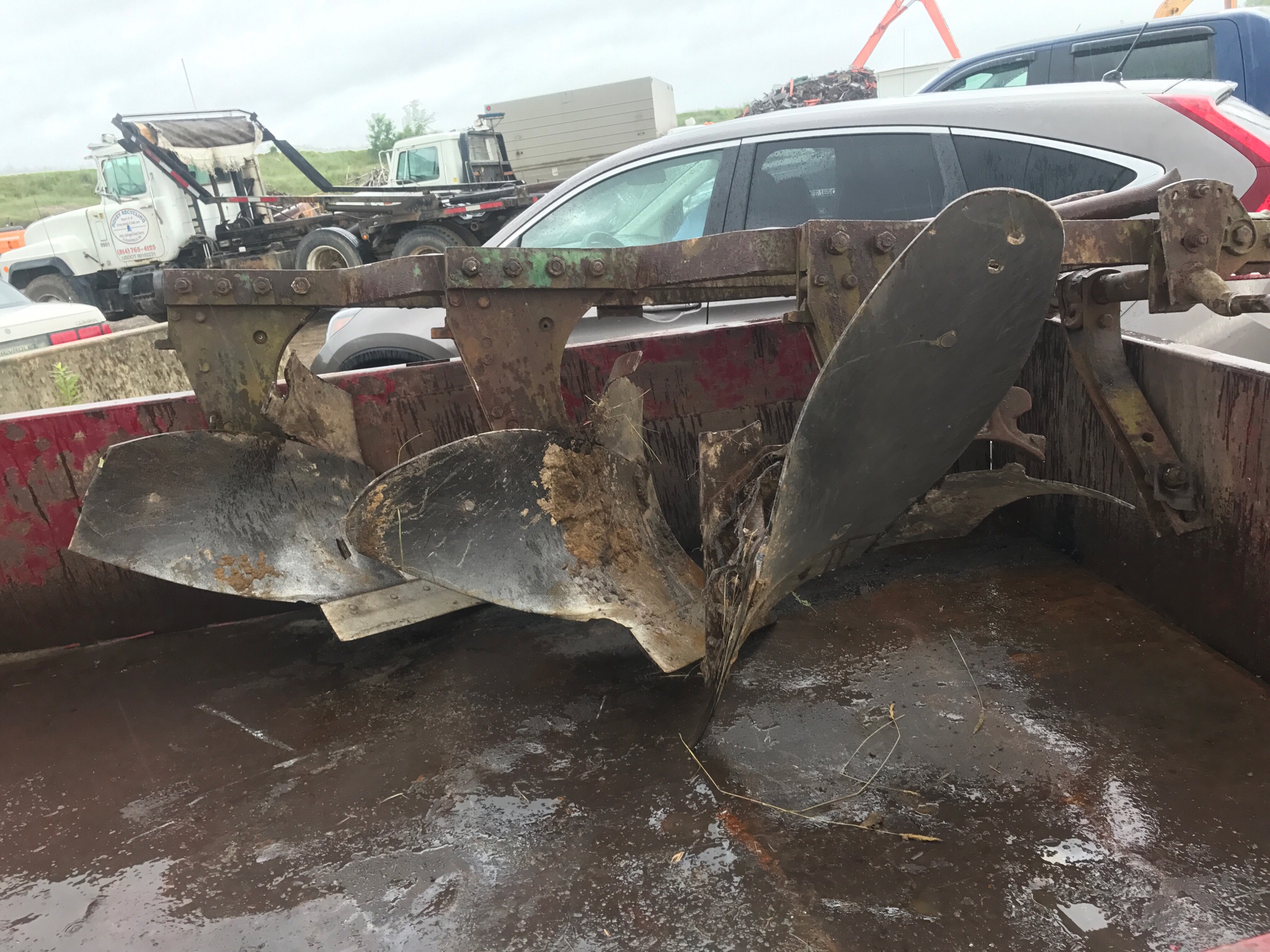

I was at the scrap yard this morning and a fella was throwing out a 3 bottom plow. Upper arms need refab'd as they are bent and stabilizer arms are broke up to the top link connection. But the plows are in good shape. It's a heavy set. Too heavy for my L-35 but I grabbed em anyway. Thought about taking one plow off, anyone ever do that? If it doesn't work I will just fix and sell or trade them. IMG_2581.JPG

Plowing is an advanced Three Point Hitch skill.
I doubt you can rehab that mangled plow so that it will function satisfactorily. "Close" does not usually provide satisfactory service.
   / Anyone ever convert a 3 bottom plow to a two bottom?
Actually other than the top arms that come up for top link and the corner of that mold board it's all straight. The front plow is just tripped.
   / Anyone ever convert a 3 bottom plow to a two bottom? #4
Yes you can remove the rear section and have it function as a two bottom
That's what I was thinking, thank you LD1! I got the plow to reset and now I'm searching for scrap to make the upper arms from.
