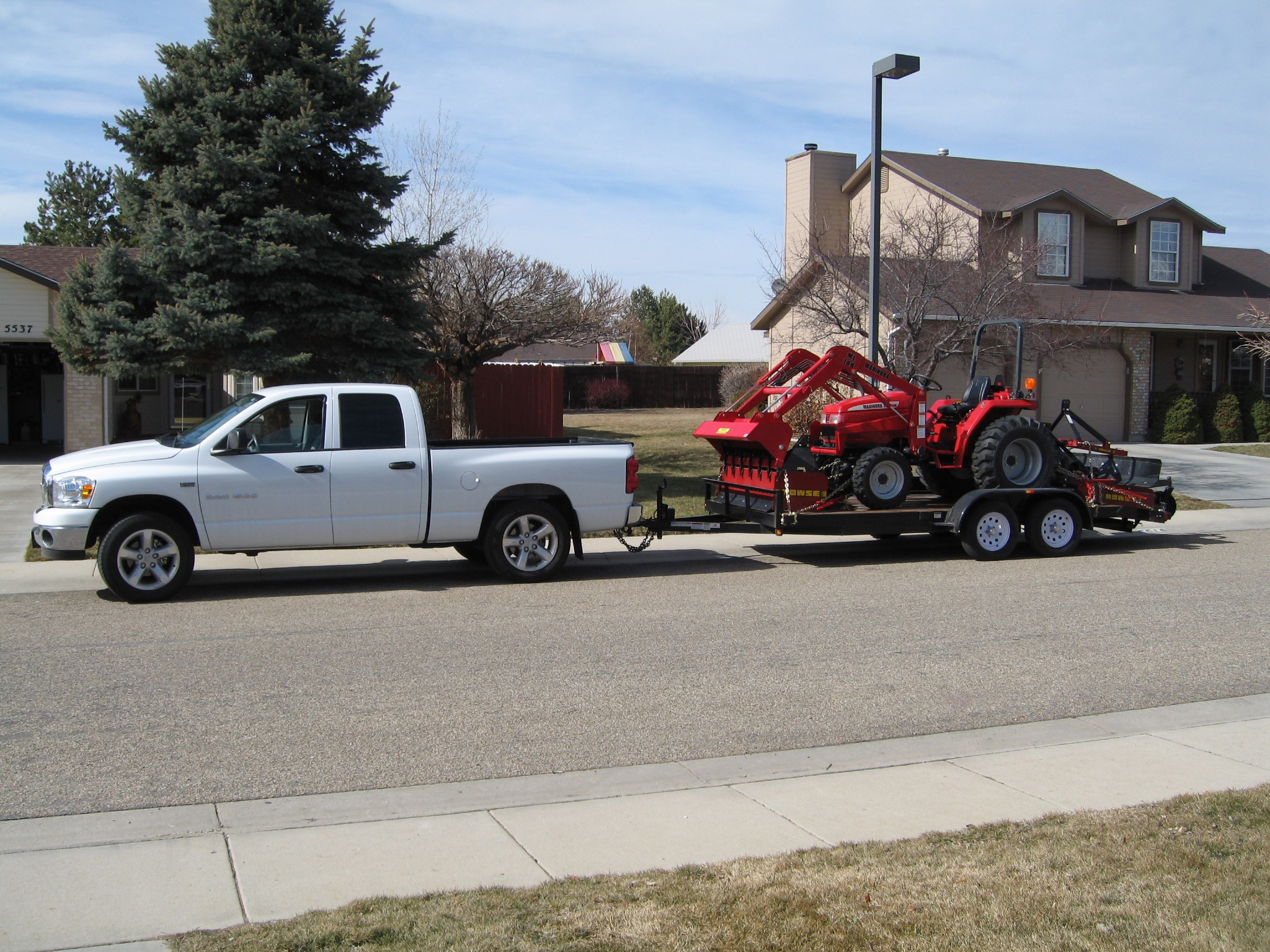

I couldn't even find a trailer to rent in my area. Either they are to small or to big. The larger ones require a 3/4 ton. I bought a 7500 GVW trailer to move mine (and for other needs). Here is a picture. It's a 16'. I have the box scraper, brush hog, and the blade stacked on top of the brush hog.

That box blade looks very familiar! How many pounds to you estimate you are hauling in that picture? Looks like your Dodge 1500 is handling it well.
We tried to put our 3525, box blade, auger, single row plow and 6 ft shredder on our 18 ft trailer, but it just didn't look like it was safe. It was really weighing down our 05 F-150 too.

About 4200 lbs with the tractor and implements. Trailer is about 1800 lbs so I'm at about 6000 lbs with a 7500 lb GVW trailer. The 1500 1/2 ton Hemi is rated at 8000 lbs and it has a class 4 hitch, so I'm good to go. Grunts a little, but, once I get it to my cabin, it's there for good. You should hear the 50 Delta Flowmaster hummm under tow...lol
Welded d-rings on the trailer last weekend and 2 d-rings to the underside on the front of the tractor under the loader frame. Added 2 grab hooks to the available swing arm holes on the 3 point. Grade 70 chains and every implement is locked down with binders. It's not going to move a bit. The brush hog is over the end of the trailer about 3 feet (tire and tire mount) on the 16' trailer which will be fine. I have 4 ratching binders and 4 of the regular kind and I used all but 1. Harbor Freight grade 70 20' chains cut in half.
Also welded a 3x2x1/4 59-1/2" angle iron to the top lip of the bucket and 2 grab hooks. Looks good. Made 2 pallet forks that attach to the bottom lip of the bucket as you find on e-bay. They attach with load binders. Need them to move material being shipped in to build my cabin (generator, etc.) and to lift trusses etc.

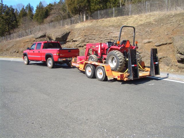

Try Home Depot Rentals. I borrowed my friends trailer which he purchased used from a local home depot rental center.
