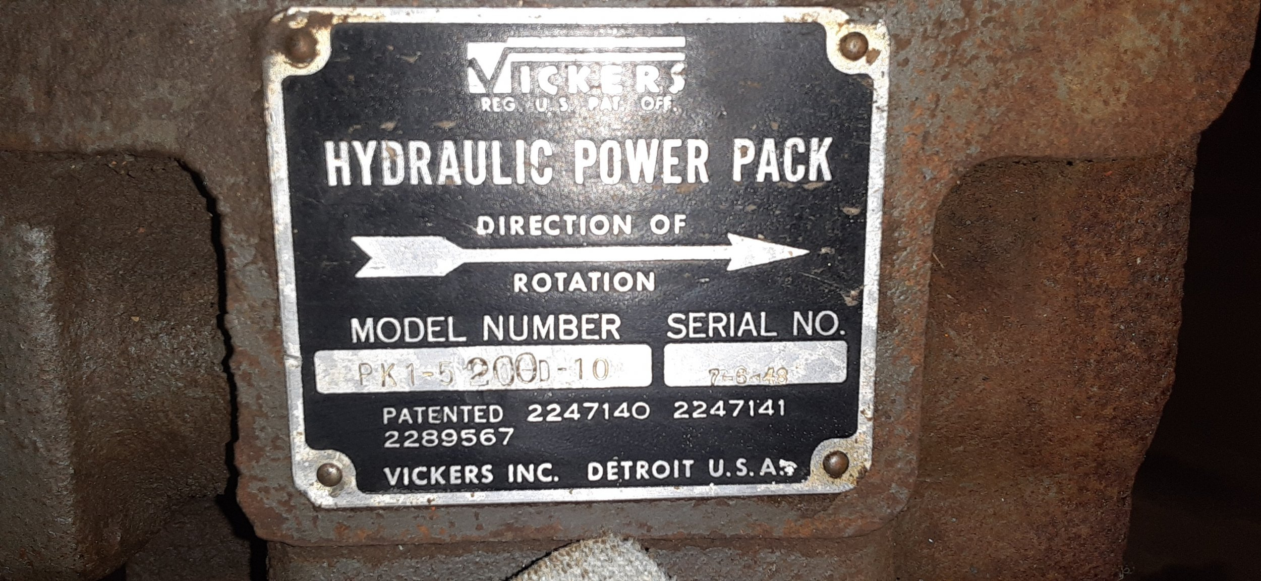

I'm looking for any info you might know about this:
It says Vickers Hydraulic Power Pack. Model number PK1 1100 D 12.
The tag also has a 74 stamped in the top left corner.
Also has a bunch of patten numbers but that's it. Thanks for looking.

I think these are semi obsolete. I am going to try and attach a data sheet on them.

Thank you very much for the help. It sure is the info I needed, exept the GPM. Thanks again Mitch
   / Anyone ever hear of this Power Pack? #7
Based on the model code of PK1 1 1 0 0 I would say 1 GPM at 1200 RPM since Vickers vane pumps where rated in GPM flow nominal at 1200 RPM.
PK1 = long tank
1 = 1 GPM at 1200 RPM
1 = single acting valve
0 0 = no other valves
D = relief ste at 1000 PSI
12 = design series
Suspect right hand rotation (CW) since the Left hand was optional and is not noted in the model code you provided.

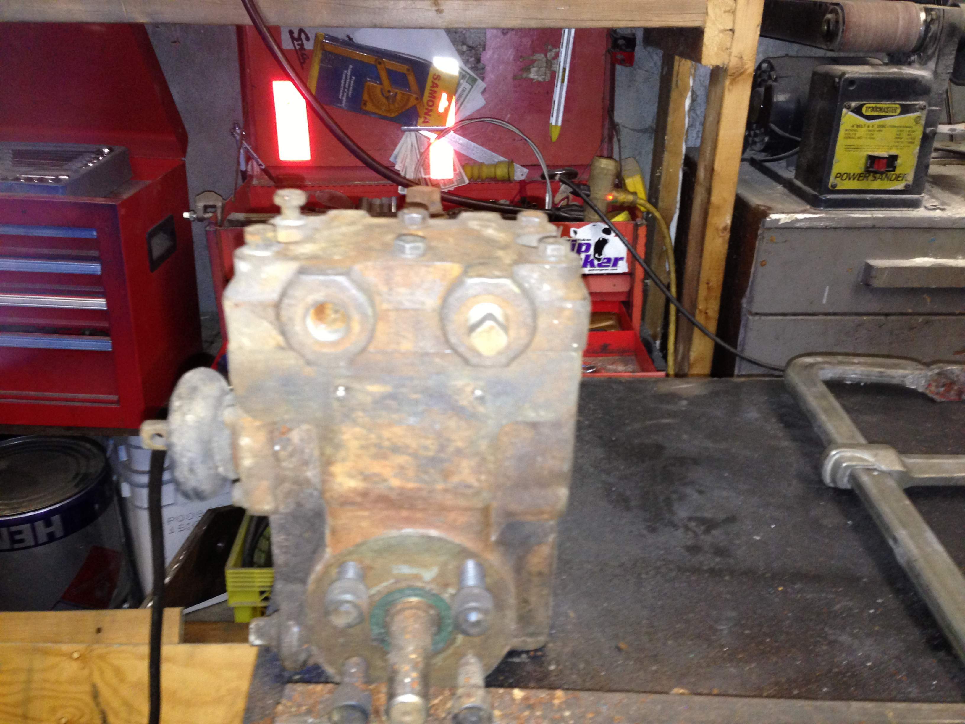

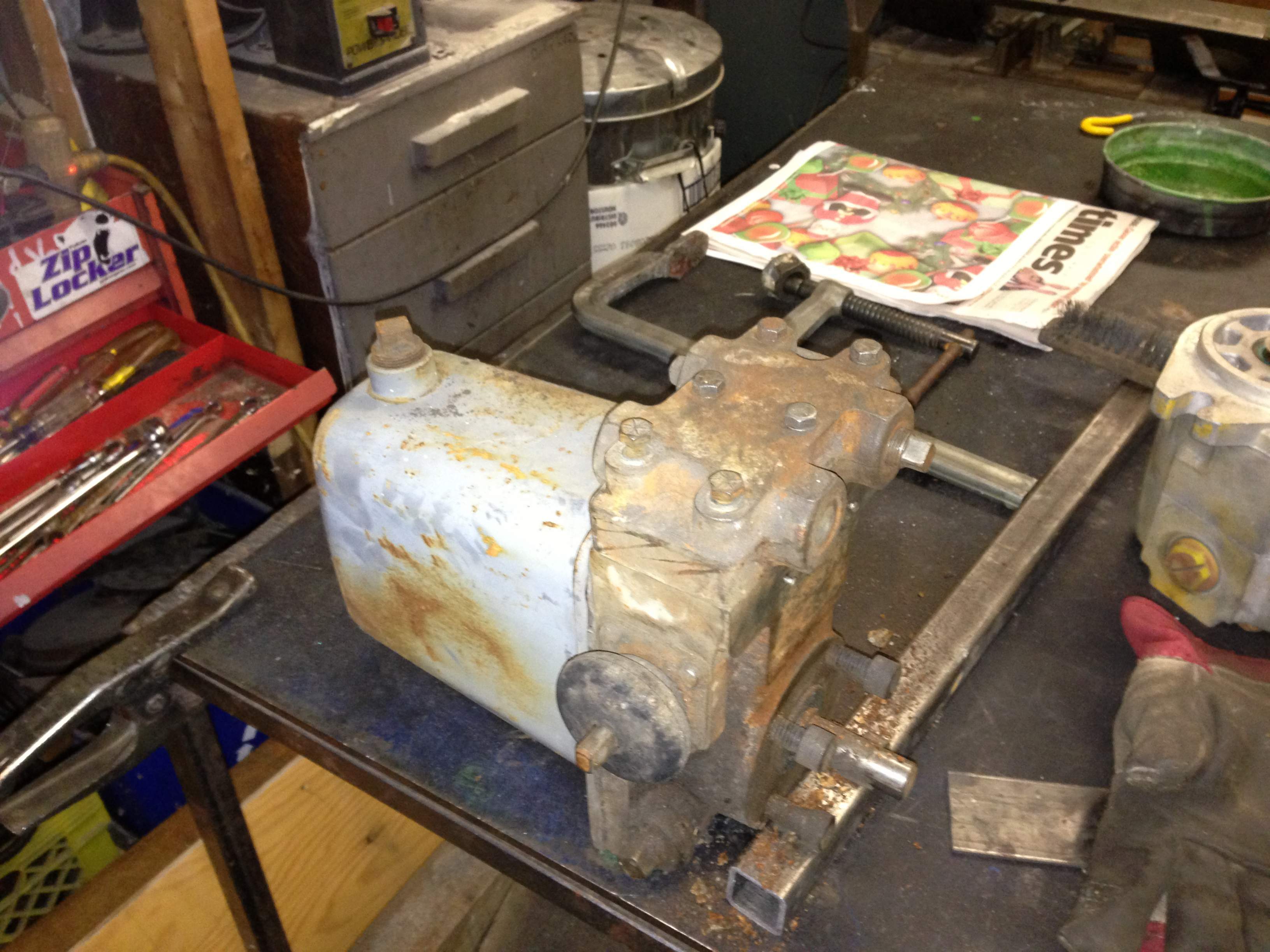

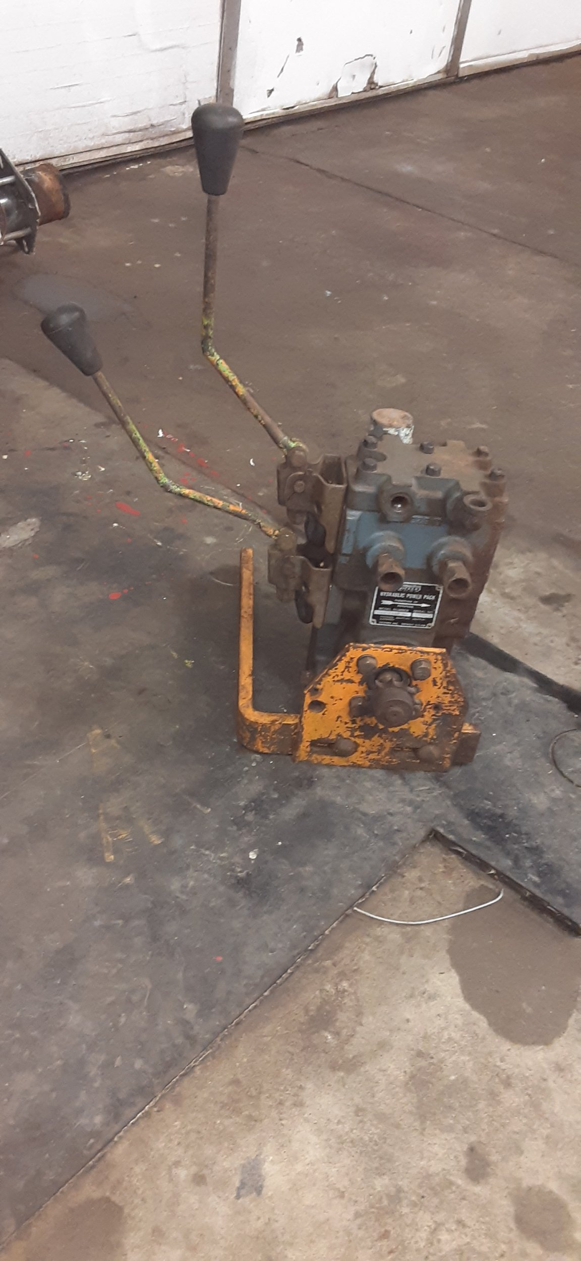

I cleaned out of building and this was in with the stuff that I had to leave I know nothing about it but it's similar to what you have
