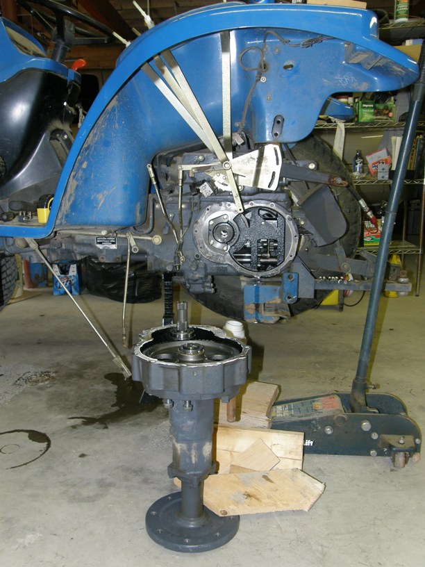

I once did it on my 1720, and I think the setup is the same. If so, you'll have to pull the axle housing, which other than the 20 or so nuts, is not a huge job. Once inside the housing theres a little more work to get the seal out. I can't recall if I had to pull the stub axle but I think I did. Must have been easy because I don't even recall that part. You will have to be extra careful on putting the new seal in not to bend it. The 1720 had a special seal that had its own race. In other words, it did not directly seal to the axle. All in all I think it took me most of a day by the time I resealed the housing back onto the differential case with the SuperBlue and retourqued the nuts. You'll need a jack on wheels capable of holding the housing so you can pull it off and set it down to work on.

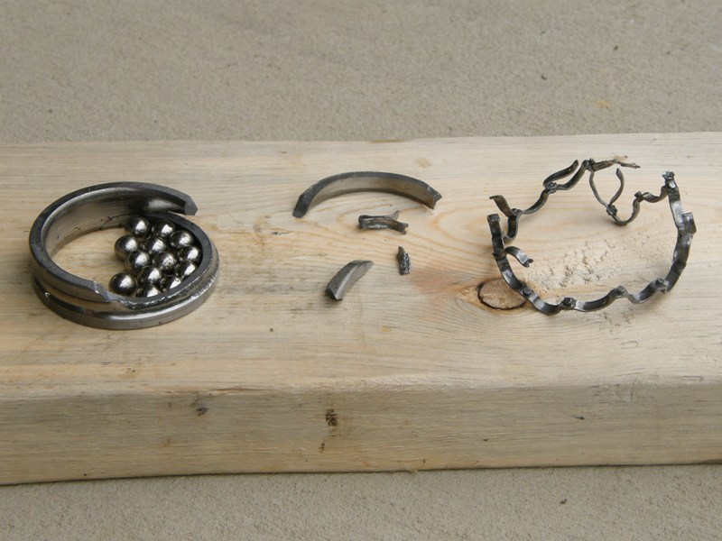

Thanks djradz. After I started this thread I realized I would be needing a new bearing as well, as there was a lot of play in the axle. I finally dove into it yesterday. A lot of preperation disassembly involved; ROPS, linkages, etc. Not knowing how heavy it would be, I used a floor jack. It turns out it weighs 104 pounds. I could have gotten it off unassisted if I had to, but the jack will absolutely be neccessary to get it back on.
If anyone is interested, the first picture shows the axle dropped. The second picture is the gruesome remains of the bearing. Not for the faint of heart!

Wonder why that bearing failed under 1000 hours? Low fluid level, flaw in original bearing, rollover?? Any theories?
Jim
   / Anyone ever replace rear axle seal on a TC? #5
Wow! That bearing is scary.:eek: Otherwise, it looks like you have this job going very well.
It was low fluid level. I was doing a big backhoe job when one of the hoses started to leak. I kept working untill I was mostly done. I replaced the hose (PITA) and went back to finish the job. Apparently I lost a lot more fluid than I thought.

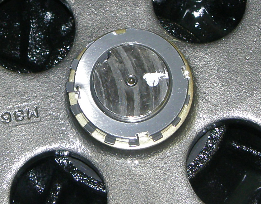

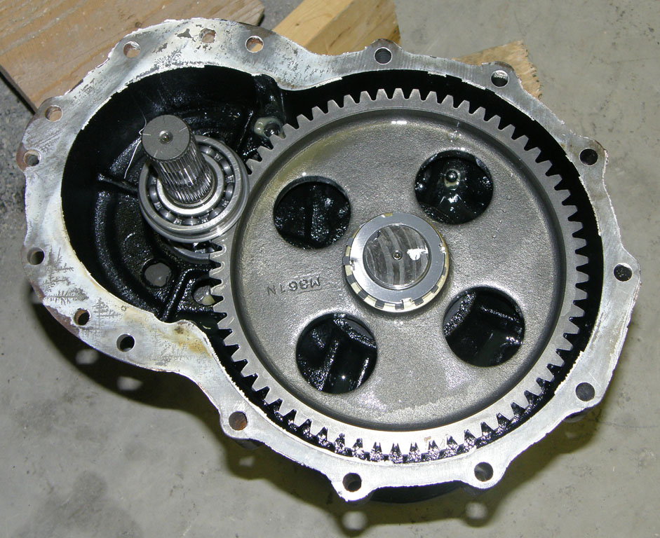

Question: Does anybody know what the bolts that attach this assembly to the gearbox should be torqued to?
Interestingly, I found that the factory never bothered to lock the washer to the nut. Although the nut was still quite tight, I wonder if the other side axle is going to fall out someday.
