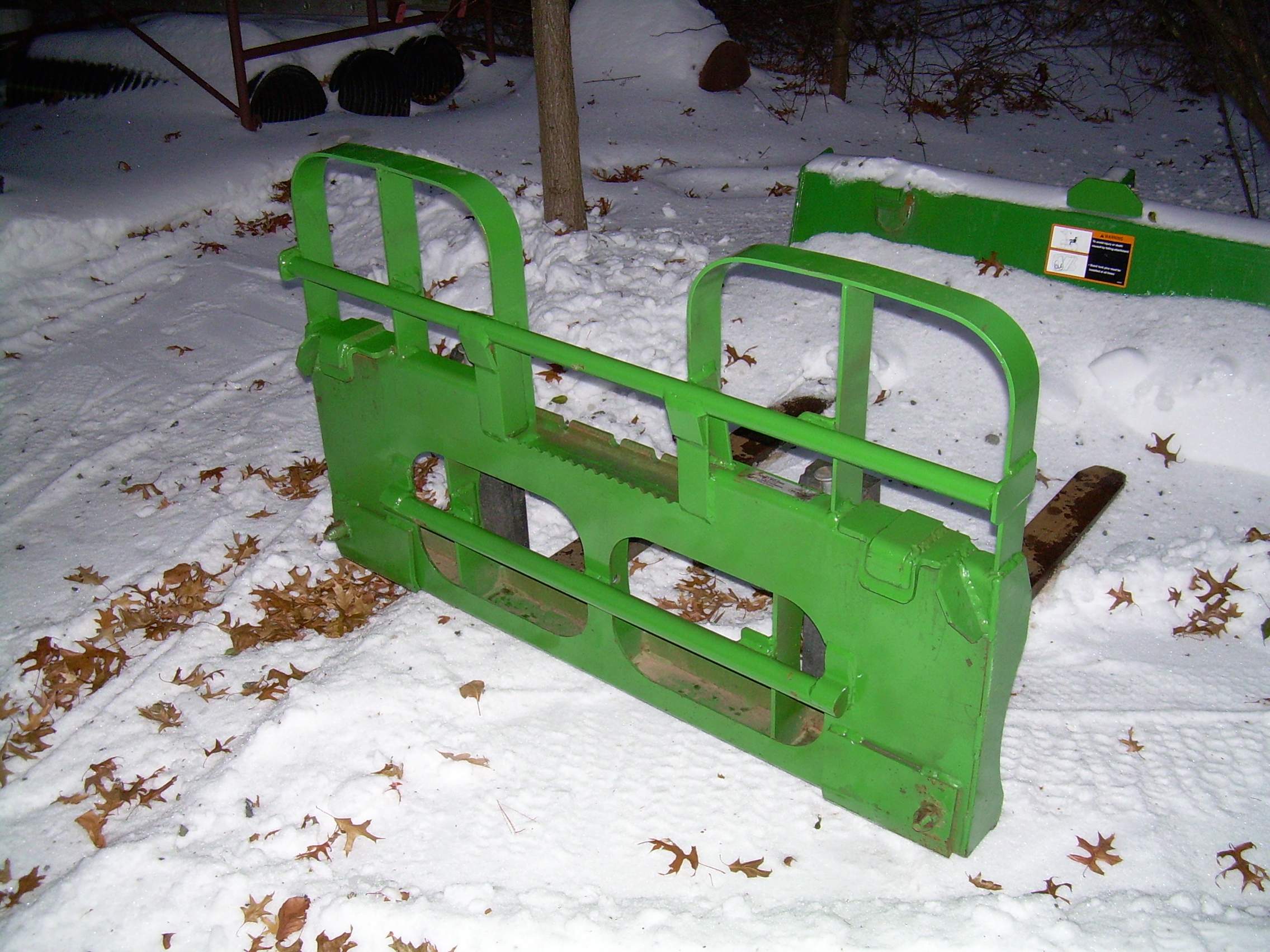

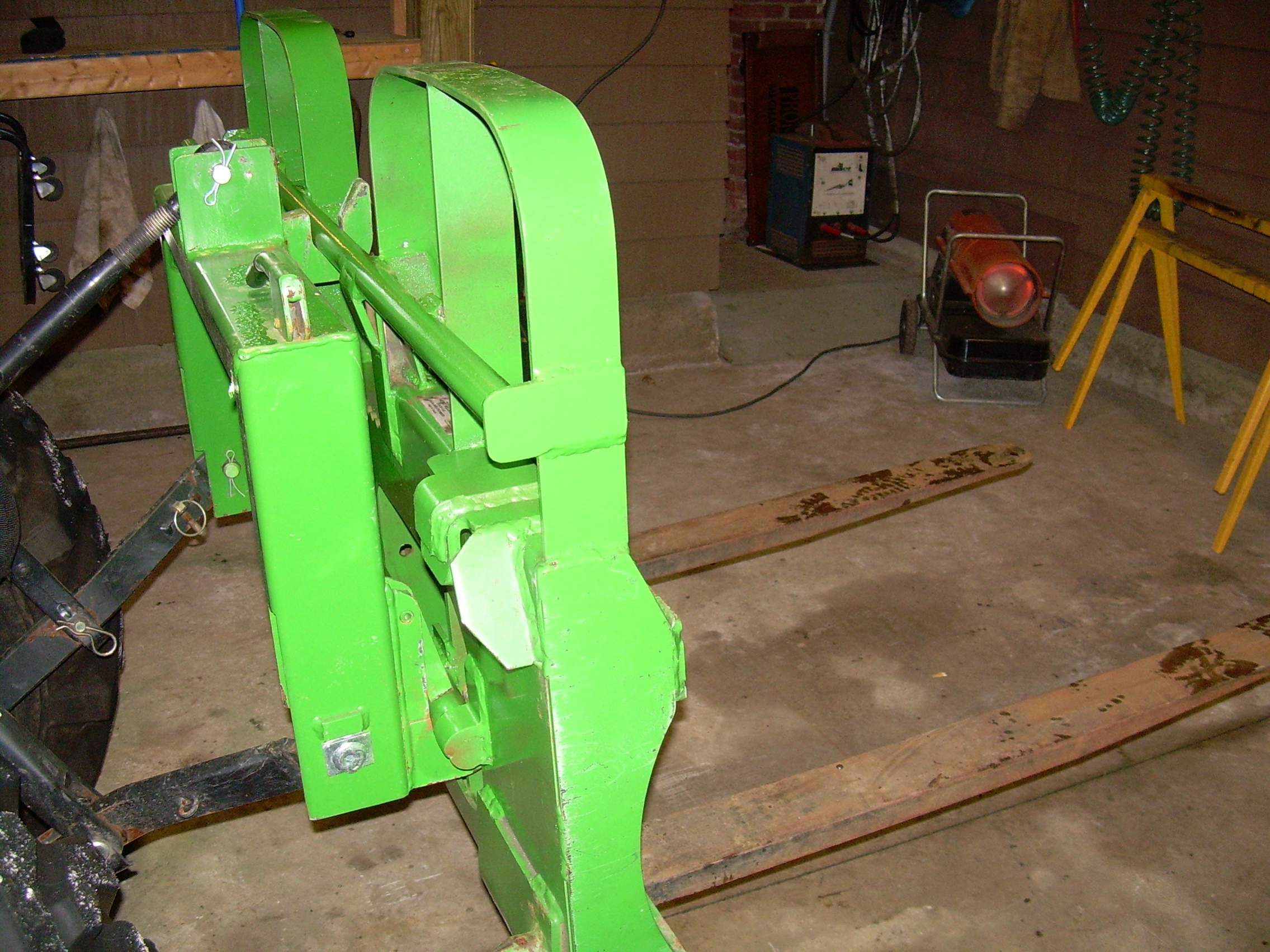

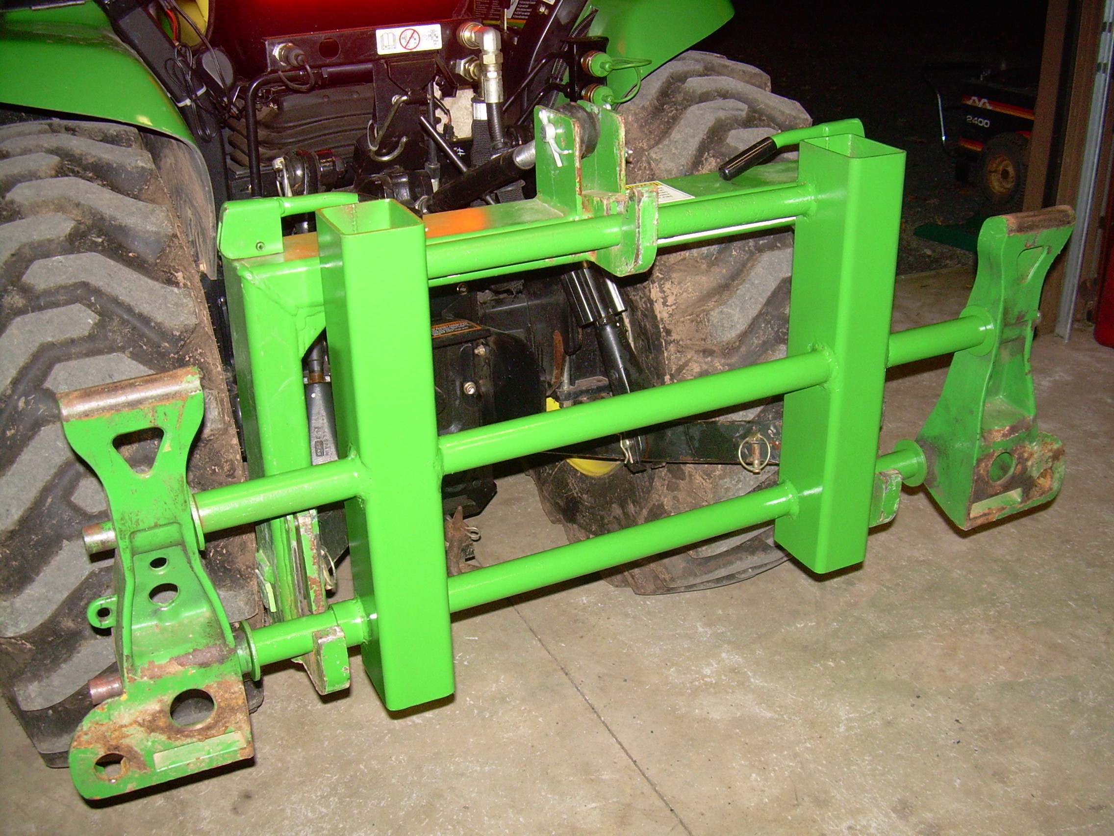

I just modded the fork carrier with some right sized solid steel bar.
I also made a 3pt to front implement carrier, but that's JD specific.
JB.

That's a nice custom build JB, the reason I don't build my own is that the latching mechanism for the universal QA is too complicated for me to built; I would have to purchase a set of latches that would run at least $400, so it was simpler just to buy a premade unit.
