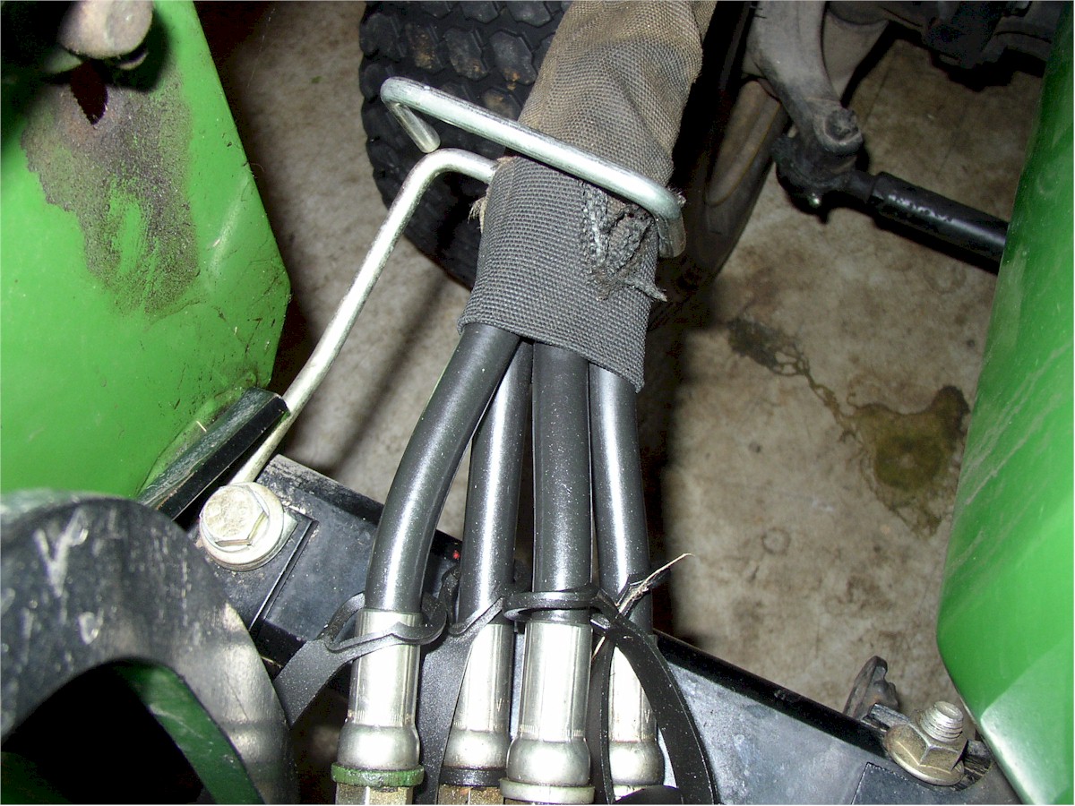

The hydraulic hoses for my 70 loader on my JD 790 rub on the front wheel at times, wearing through the hose guard. On Deere's online parts catalog I discovered a hose support that my loader doesn't have, so I ordered one figuring that it might help.
I picked it up on Saturday - it's a length of round stock formed into a rectangle with a stem. But I have to admit it's not entirely clear where it's supposed to mount and in what orientation. :confused: It doesn't help me that the loader is currently off while I'm replacing a bucket cylinder.
If anyone has something like that installed, could you offer any advice or a picture of it??

On my 790 (with the 419 loader) the support was attached to the left hand mast (since the hoses go with the loader when it's dismounted). I thought it was bolted in place, but it's been a while since I sold the tractor). The support wasn't painted (cadmium or zinc plated, I believe).
The hoses and protective sleeve would also rub the front tire. I got tired of yanking them away, so I used two wireties. One tie "choked" the protective sleeve, the other was used to tie the first wiretie to that bracket. Minimal movement after that.

I have an 855 with 70A loader and have that bracket. It does its job very well. Look at where your loader mast attaches to the horizontal bar (piece of square tubing) mounted on your tractor. There is a bolt on that horizontal bar immediately to the right of where the loader mounts. That bolt holds the bracket you have. Hose bracket should be mounted so that it points forward and slants in an upward direction. I know, I know- a picture is worth a thousand words. But I'm terrible with technology and trying to get pics on here. If you get stuck, let me know and I'll have the Mrs. help me get a pic up here. Hope this helps!

A thousand word attachment...

Wow that's simple. Must be about $100 From John Deere. I have a strap with velcro that I run around the mast and the hoses to keep them off the tire. $1.00 or $2.00 at a dollar store.

Part Number: M117022
Part Price: 26.79 USD
On Hand: 0 Check Other Stores
Description: SUPPORT, WIRE HOSE /70A LOADER KIT

Hmm, the joke's on me because mine doesn't have any holes in the loader mast square tube. Maybe it's just for the 70A but not the 70, contrary to JD's online parts catalog.
