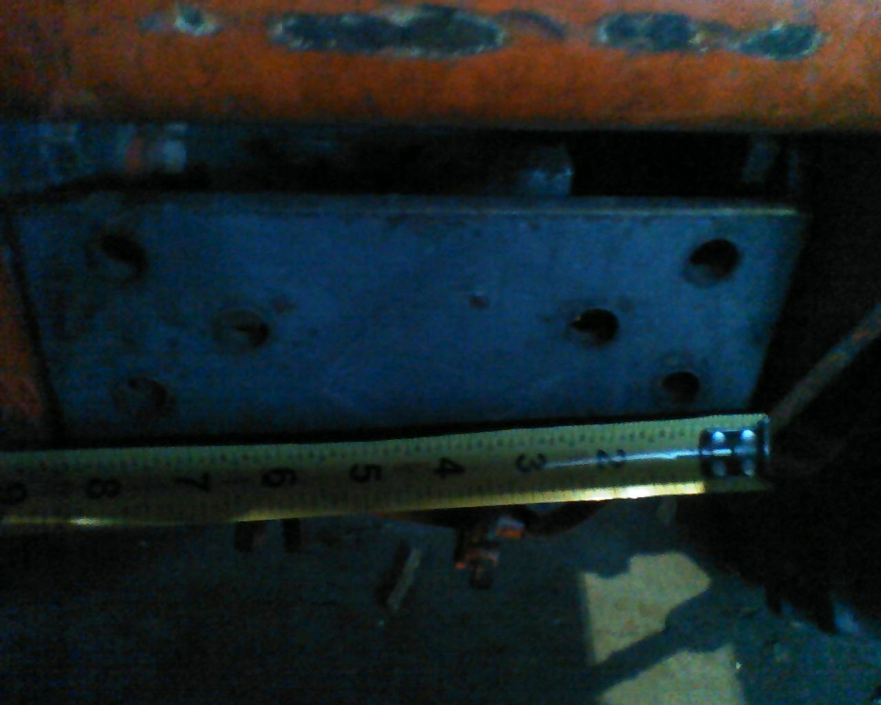

Anyone who might know, how similar, dissimilar is the bolt pattern/spacing of the front frame? Those 6 holes, specifically, for attaching grill guards, weight mounts, etc. Thanks
   / Anyone have a BX and a B? Front Frame Question #2
not sure- but what do you got in mind ?
Simple question really. Would a grill guard, or weight rack from a B bolt on to a BX or vice verse. I may go take a pic of the six holes, but these six hole are in in the front "bumper" or frame member, on the face of the front frame.
Please pardon the glare in the pic, it is very sunny today!:)

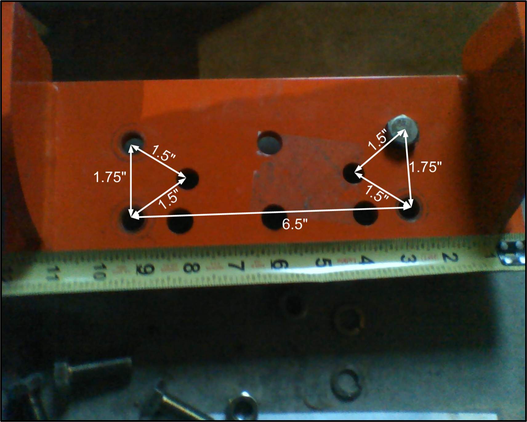

We just happen to have a BX2660 brush guard in the shop (it had to come off for the the front plow to go on) and a B7510, I will see if I cam take a picture after work (and see if I can superimpose them being as we have a loader on the 7510).
Aaron Z
   / Anyone have a BX and a B? Front Frame Question #5
BX2660 Brush Guard:
B7510 mounting holes (the spacing is the same as the holes marked on the brush guard):
Aaron Z
Aczlan, a million thanks.
If I can find a picture, I will post what I have in mind. I didn't want to bother with the expense, unless it can move from my BX to a B, which could be in my future. Again, so very helpful.
