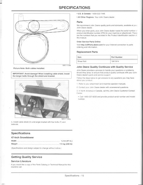

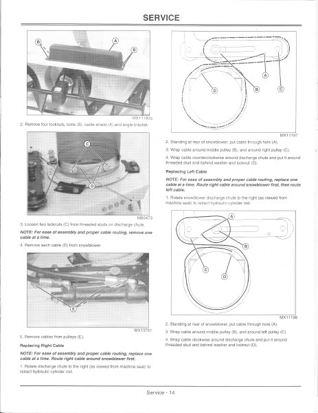

Hello - Does anyone have a diagram showing how to replace the chute cables on my 47in. snowblower with model number starting M0147?
They both broke but I don't know how to properly restring them. Thank you for your time.

Don't know about model number differences, mine begins with MO47S...
Scans are from operator's manual.

Thank you very much! I really appreciate the help! I didn't get a manual for the blower or the deck when I bought the tractor, deck and blower. I only received the tractor manual so this was very helpful.
