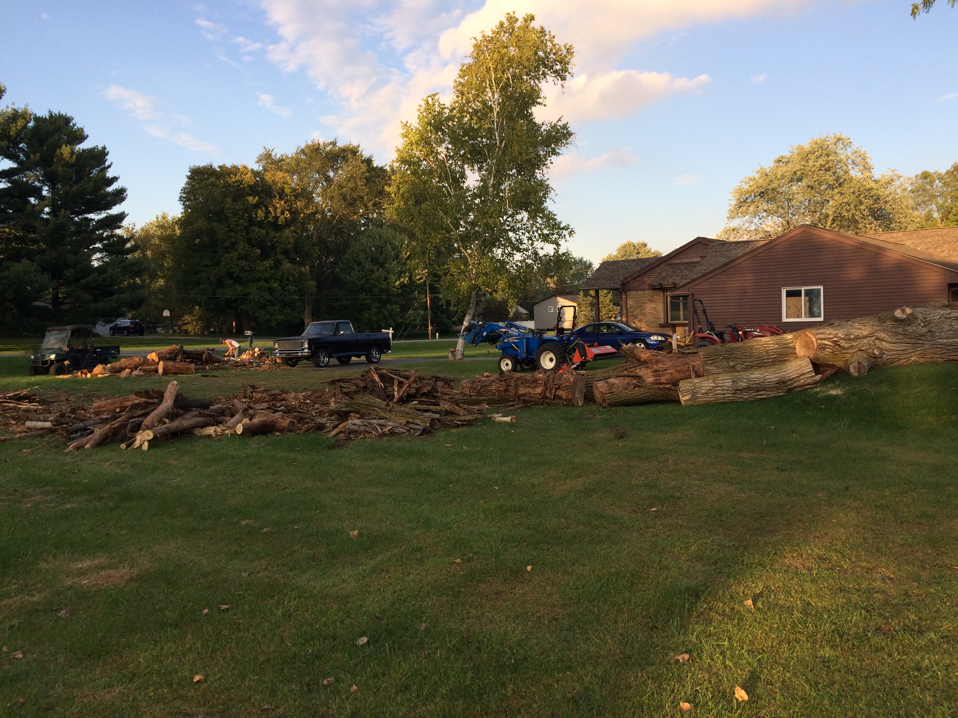

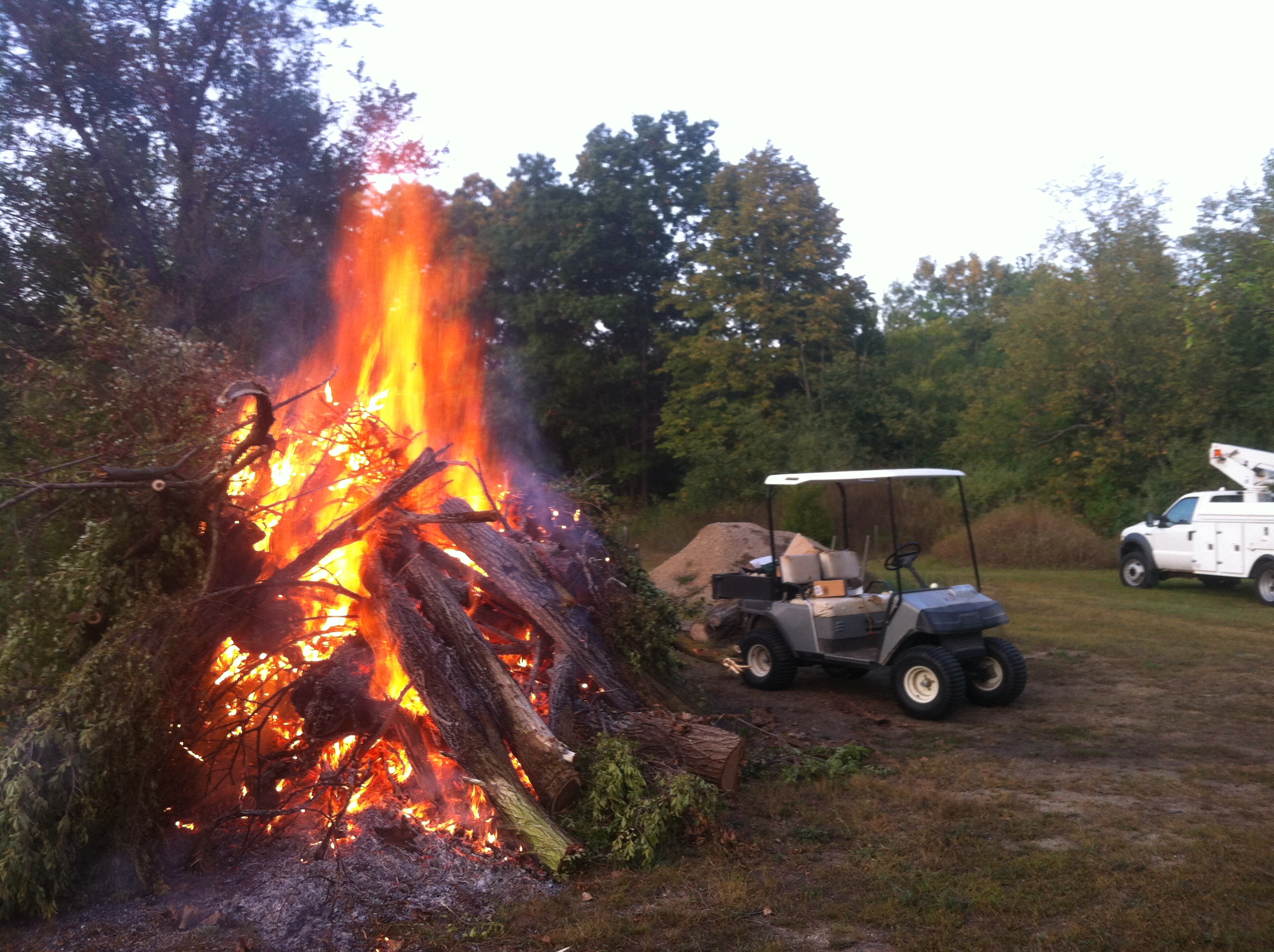

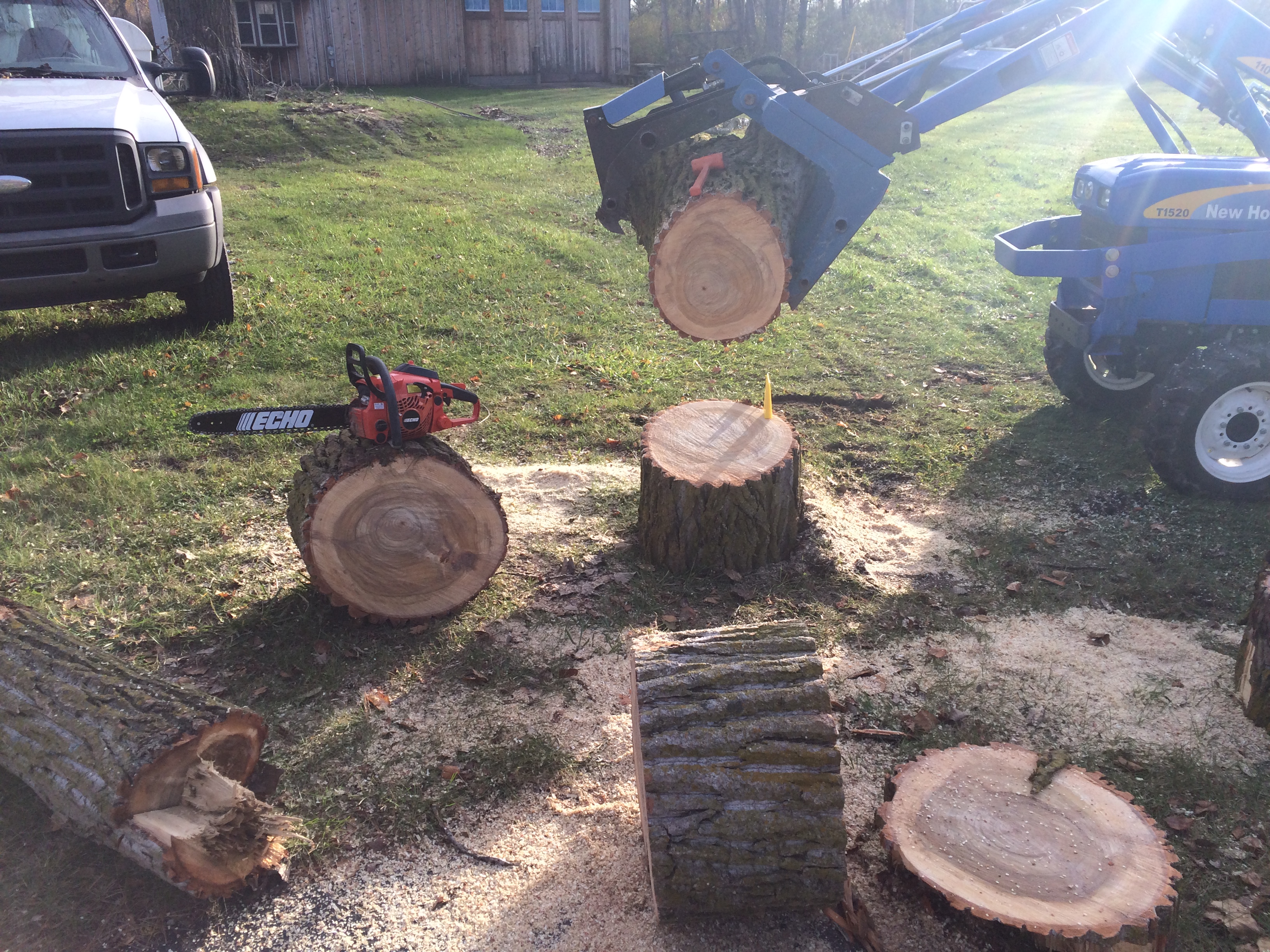

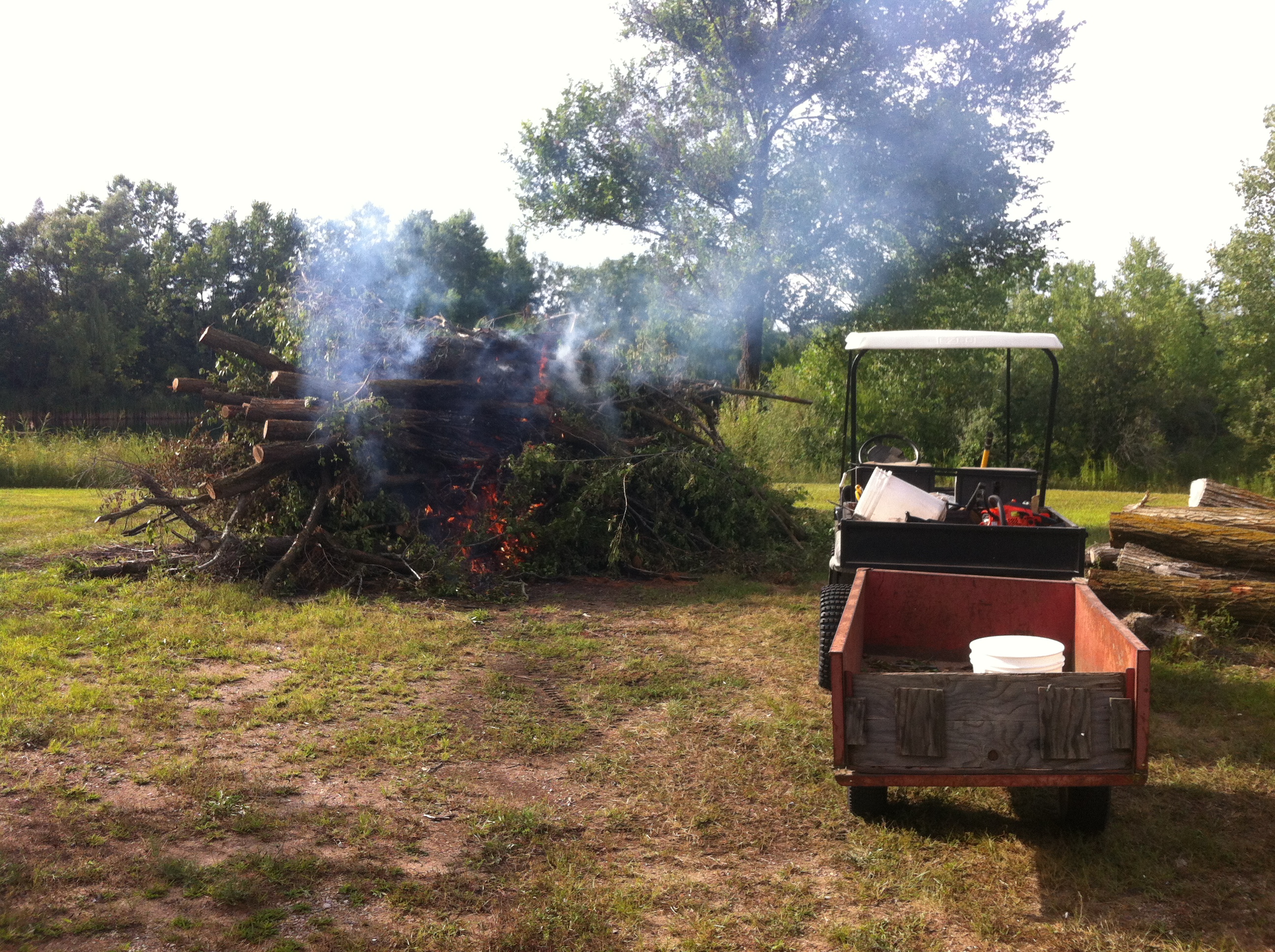

I'm still here and still can't dent or ding my MIE grapple after 4 years. It's cold and dark right now, and I'd love to show pics of why the details make it shine. Of note is that the lid cylinder mount will not be broken off, and other bits that make it durable compared to some others. I kept weight down by ordering 48", and sometimes a load will hang pretty fr off center at first grab.
Here's some little jobs I've done with it, first two pics taken 16 min apart. Last two are campfires I set up with the grapple and my 18" Echo CS400.

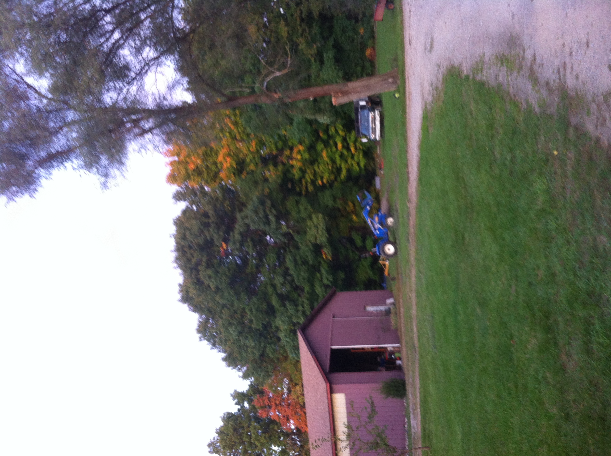

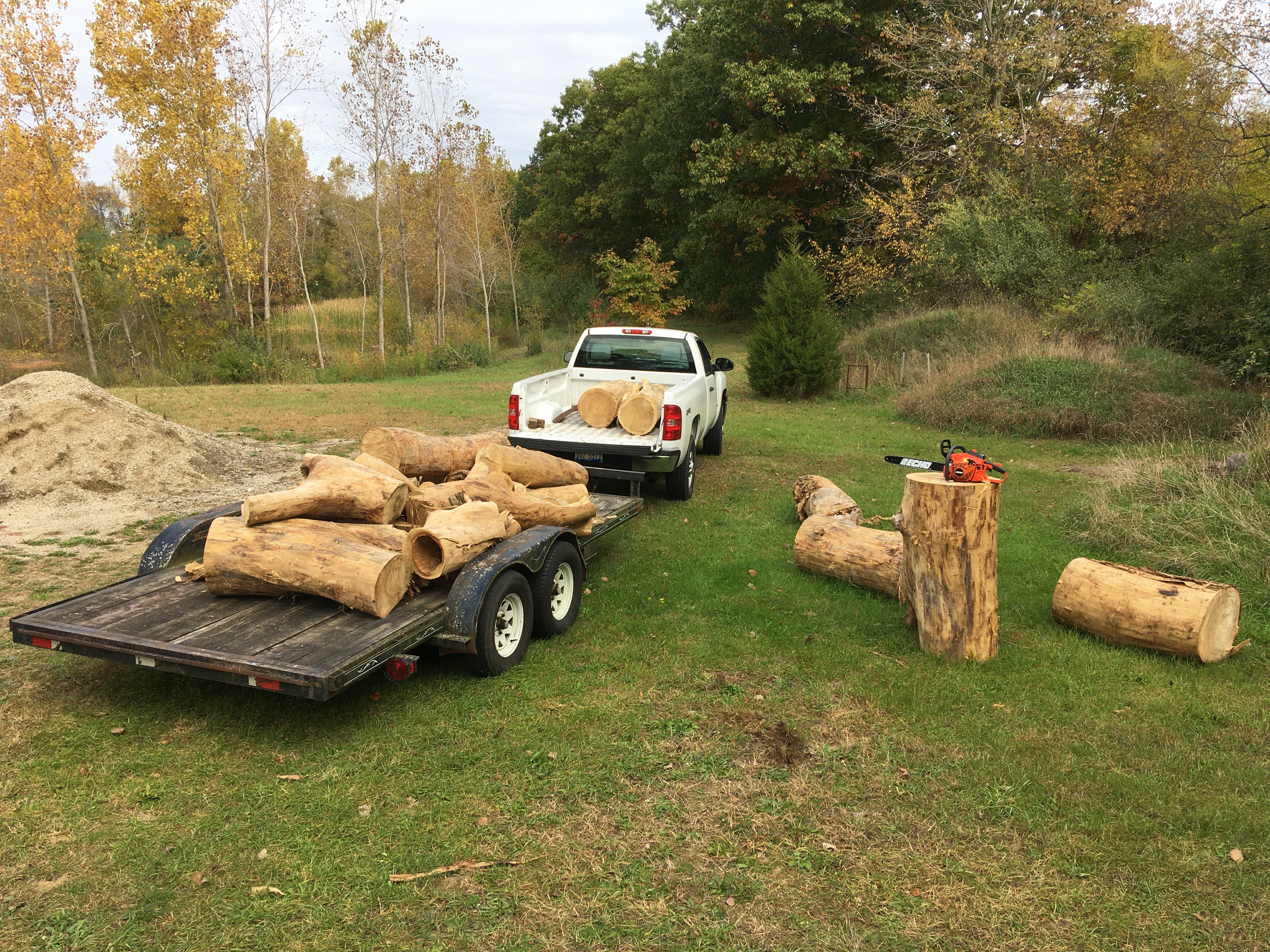

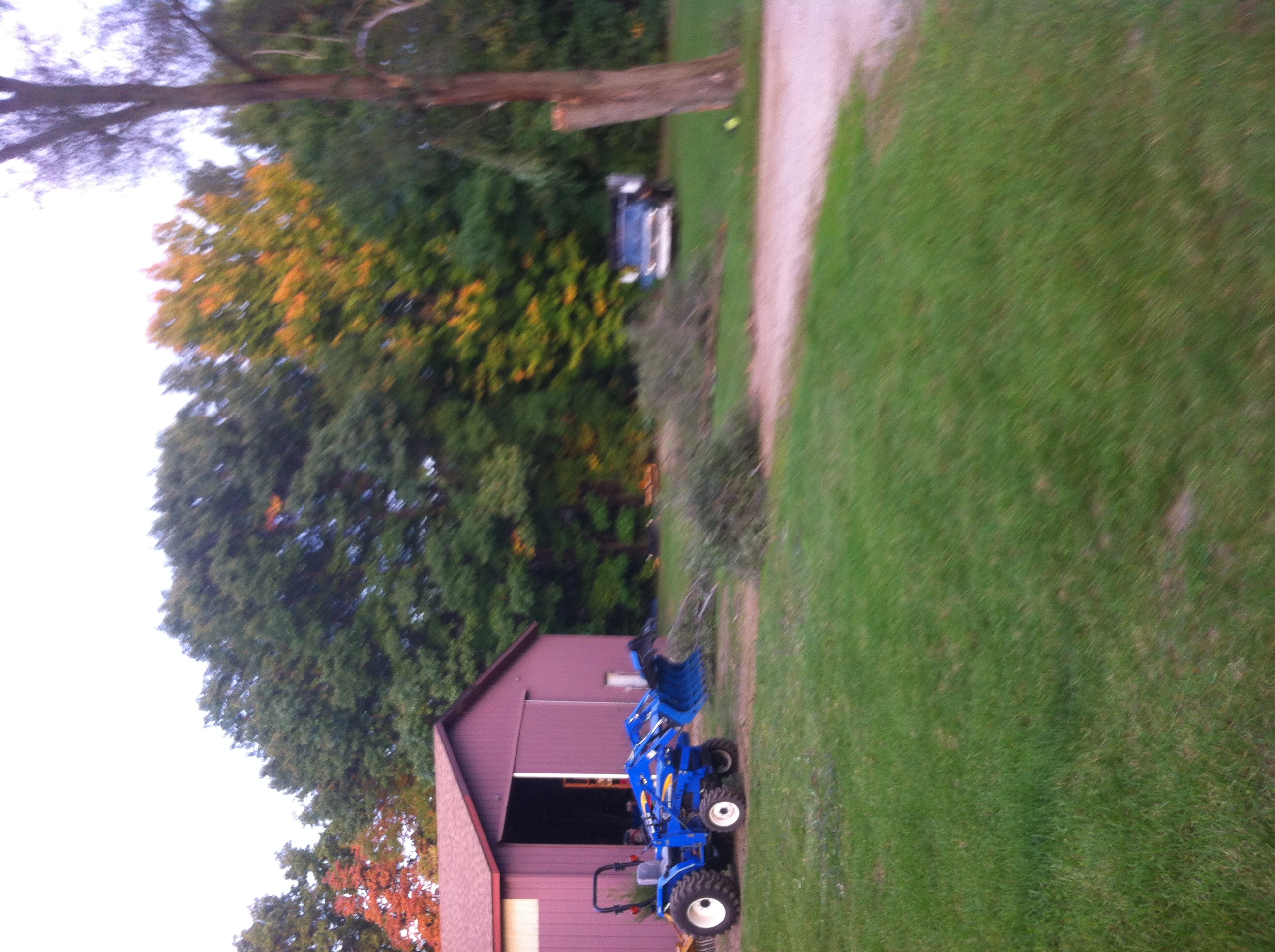

Pics of a giant poplar .. one piece at a time
View attachment 653436 View attachment 653437 View attachment 653438 View attachment 653439
View attachment 653444 View attachment 653445 View attachment 653446
