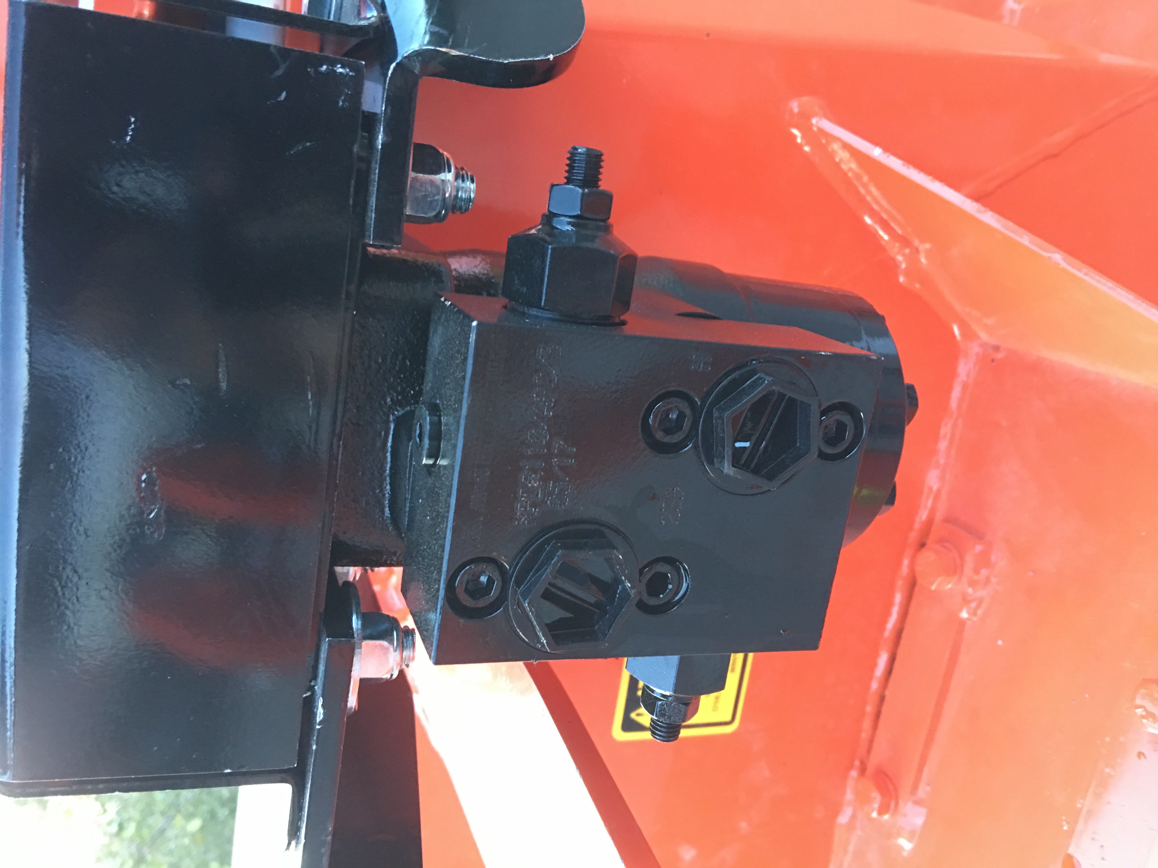

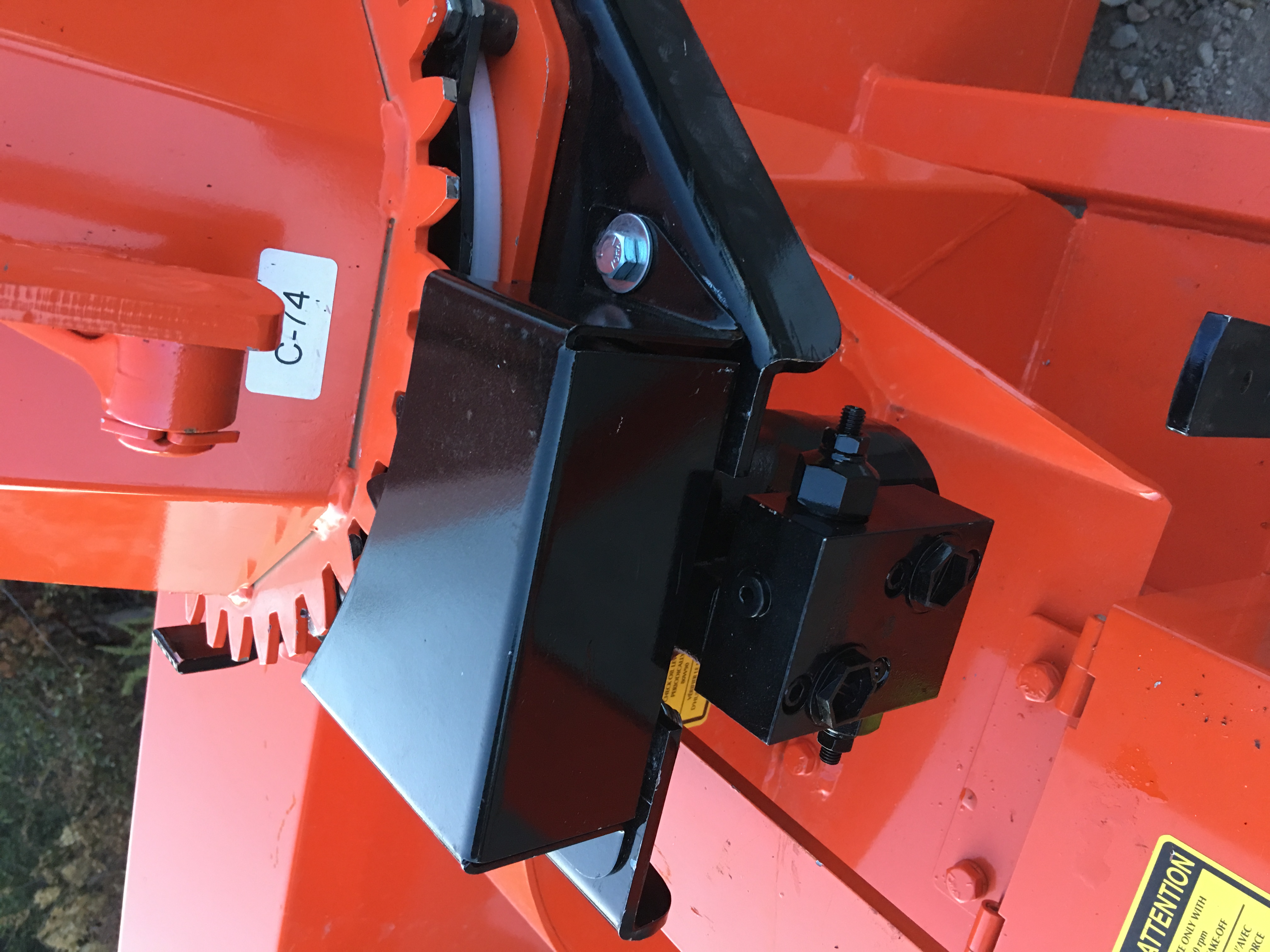

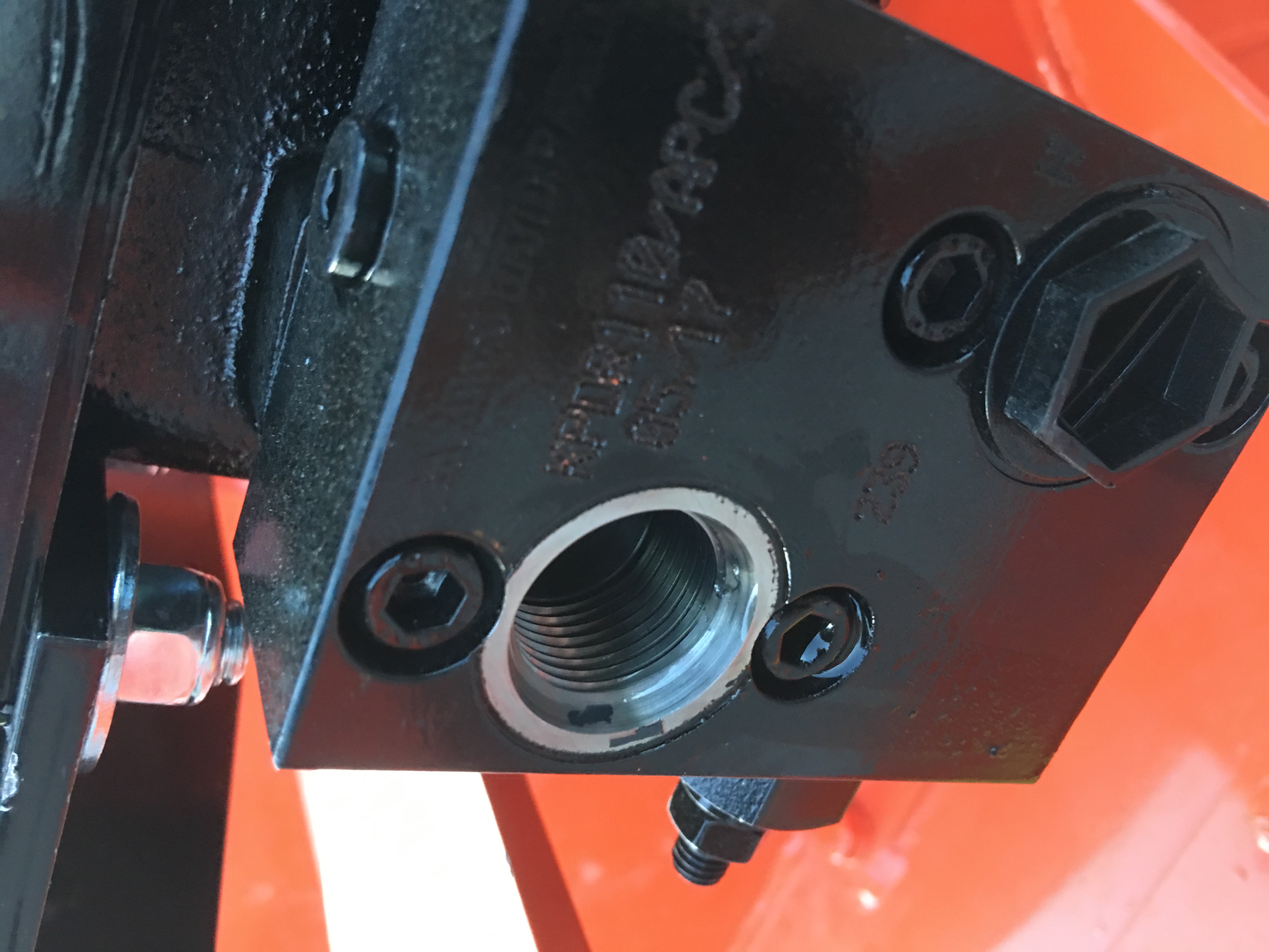

Sorry for the delay. Here's my motor with 3/4" threading.Waiting for couplings next week, then I'll cut driveshaft, and get everything dialed in. Jobs this week needed box scraper anyway.
   / Anyone have a Puma 84 with hydraulic chute rotation?
View attachment 523128View attachment 523129View attachment 523130
Thanks for posting the photos. You got the expensive orbital motor! I didn't specify which one when I ordered but I think I'm getting the cheaper regular hydraulic cylinder though. Looks like you have 1/2" O-ring boss fittings (ORB) which should be the same as -08AN O-ring. I like those much better than the regular NPT/NPTF fittings since you don't need any sealer.

Hello RichM752 and oldafretired,
Rich,
You need to have your hydraulic shop order British Standard Pipe hydraulic fittings for the valve on your snow blower. It has a blue dot B.S.P. o-ring with a steel washer and a nut to compress the O-ring to the body to seal it.
The British Standard Pipe fittings are designed to allow fine adjustment of the fittings on hydraulic valve bank stacks that have B.S.P. threads and fittings.
   / Anyone have a Puma 84 with hydraulic chute rotation? #9
Rich,
Thanks so much!! I'm headed to the Kubota dealer Tuesday to pick up couplers and will pass the info on along with photos to ensure the correct set up. I love this forum.
