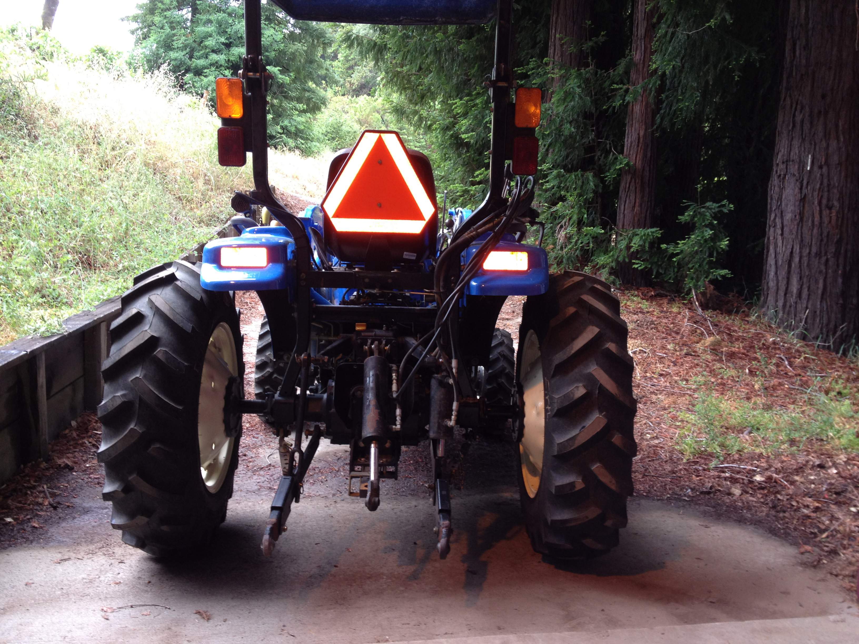

Just wanted to close the loop. I got custom wheels from Hey Manufacturing for a reasonable cost and they built them like I wanted - W-I-D-E. As you can see in the photo, I've got a ton more stability. Happy camper! 2012-06-04 17.06.05.jpg

I guess that is about as wide as I've seen! Congrats on the upgrade and improved performance for your vineyard.

Just wanted to close the loop. I got custom wheels from Hey Manufacturing for a reasonable cost and they built them like I wanted - W-I-D-E. As you can see in the photo, I've got a ton more stability. Happy camper!View attachment 270394
Those wheels look just like what I need. What is your center-to-center (and your outside-to-outside) measurement?
