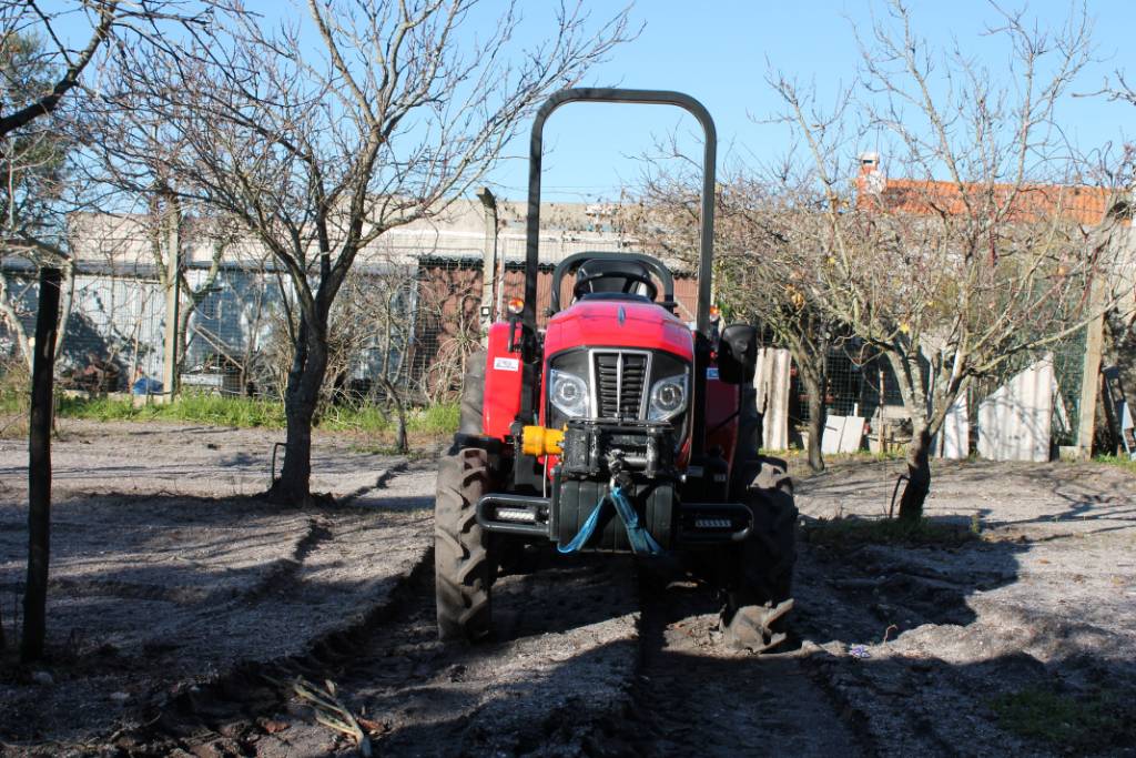

I used to always mow with my FEL on. It took the punishment and did it without issue. My new tractor is larger so it is harder to haul and mow with the loader on. I have a grill guard but it is not enough. I am thinking of a drop down bumper that protects the battery box,steering rods and the front of the tractor. Anyone have any ideas? Is a piece of pipe and some brackets as good as it gets?

Yes. I did it on mine when I built the winch. It works nicely as it pushes the brush away from the hood Could use a bigger/wider one though but I still need to drive in tight spaces.
