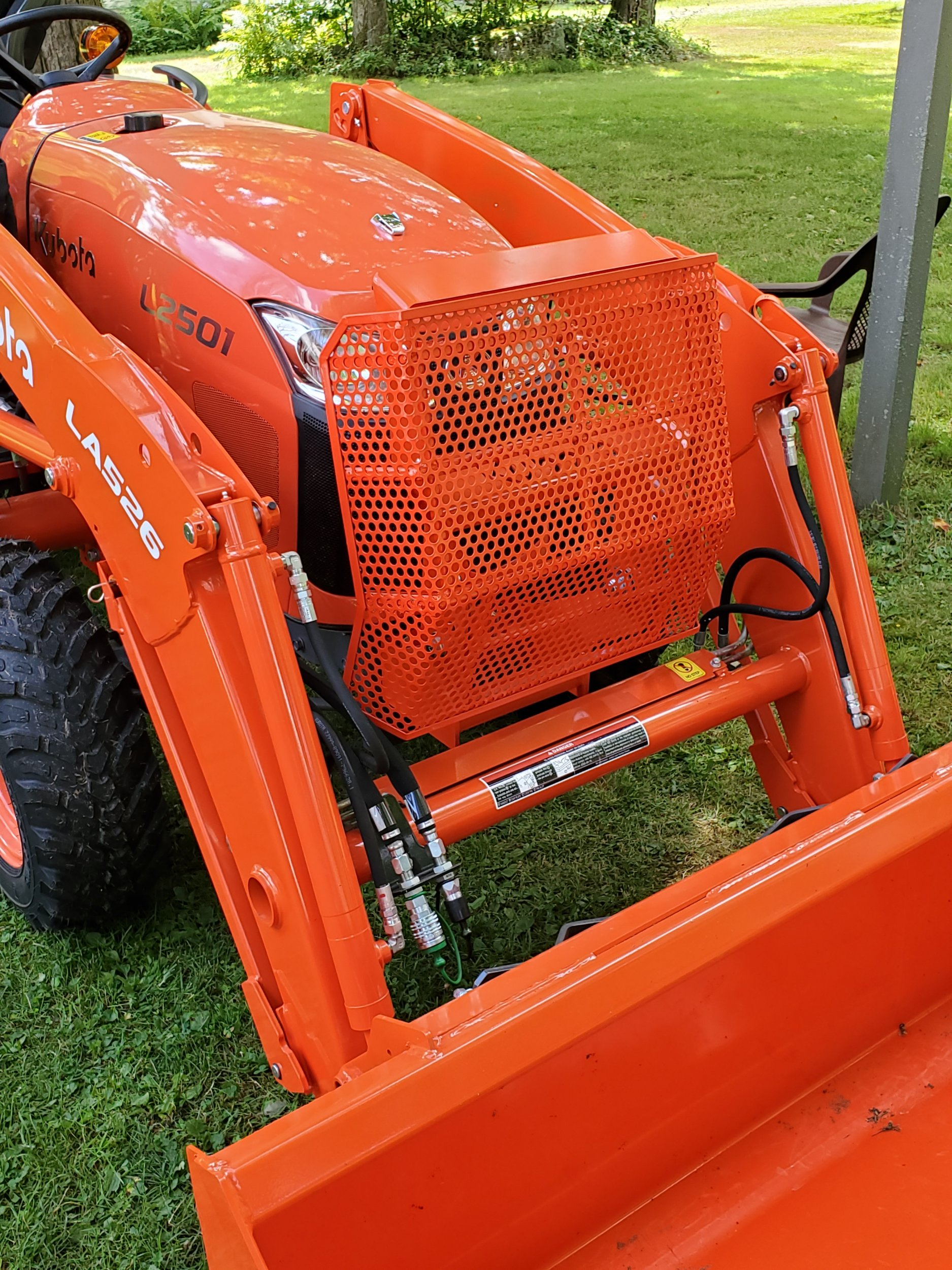

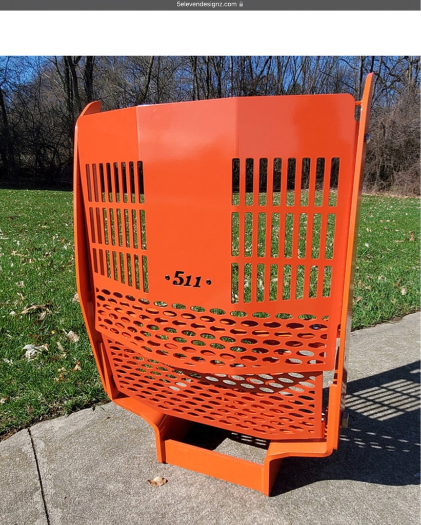

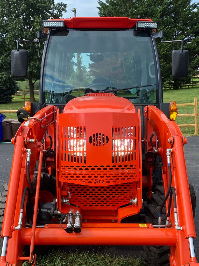

Not my work, but this is what I have on my L4060 by 5ElevenDesignz

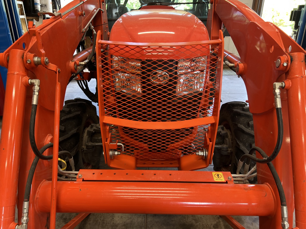

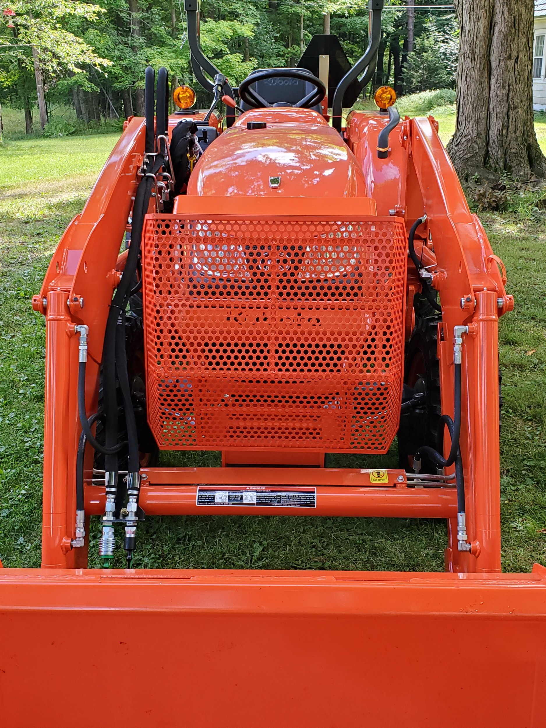

This is what I ended up welding... just some expanded metal that I contoured to the back side of the grill... I didn't go with the perforated metal like you did @Mountain Meadows becasue I didn't want to lose the headlights that much (but I like the look of yours for sure!) I think mine looks great (becasue I'm not showing the welds) and should offer the protection I'm looking for.

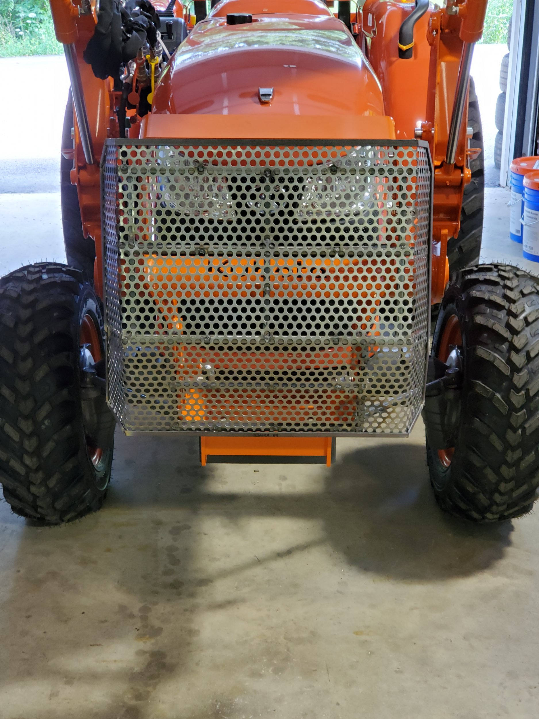

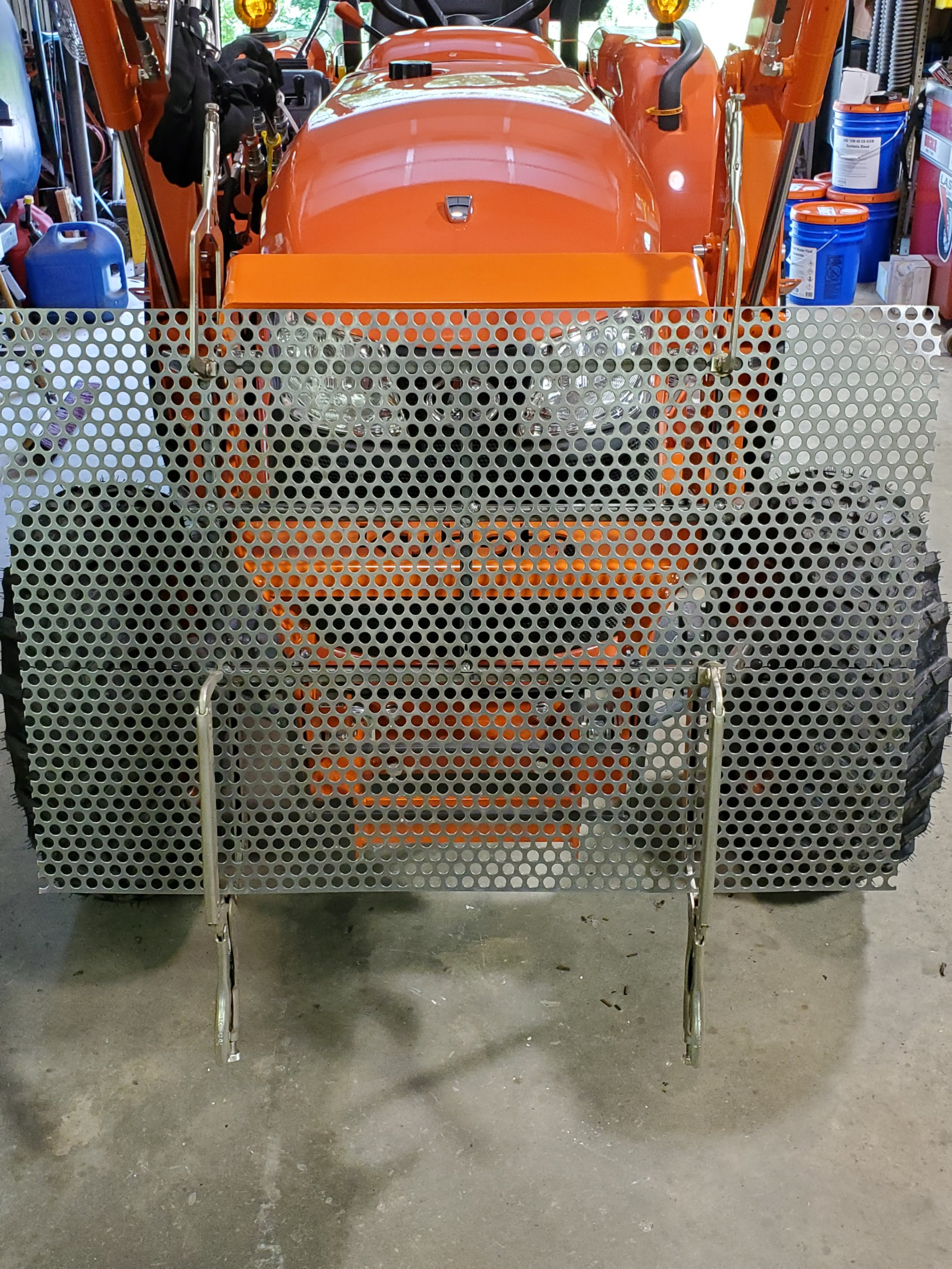

That looks well made but since I have some heavy brush to clean up I had my reservations when it came to an expanded metal brush guard after seeing this..........
I wasn't too worried about the lighting through the perforated steel plate. I plan on additional lighting for my rops.

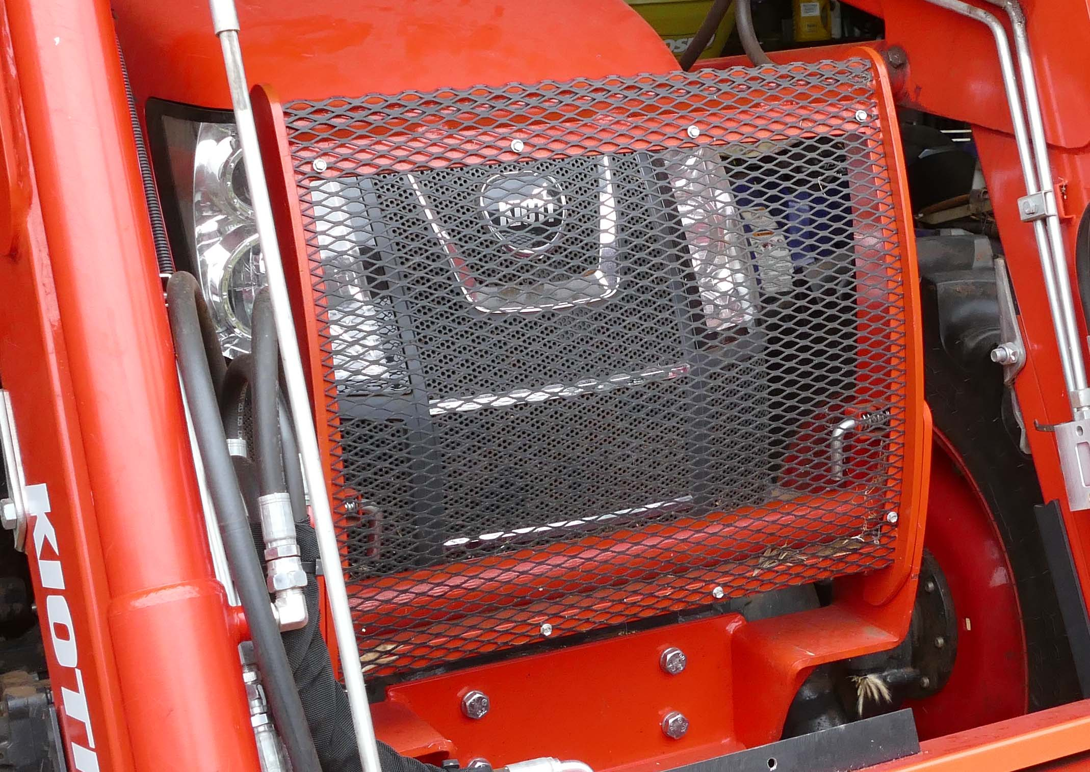

Here's what I did with my new Kioti.
I didn't want to drill holes and drive screws in to the OEM tubes (top and bottom), so welded angle iron to the tubes, also bent some strip steel and tacked it down both sides.
I regard the expanded grill as being sacrificial, to protect the (no doubt horrendously expensive) Kioti grill, and screwing it in place will allow for easy replacement should it become necessary (as per Mountain Meadows' photo).

My expanded metal is similar to Oz-Kioti's post except I welded my expanded to the grill frame. The key is to position it like you want to get started and then get a good tack weld at one end. Then use clamps to draw the expanded to the next area of the frame. Tack that area. Move your clamps...tack that area...repeat process until you get all of the expanded welded to your frame.
I recommend letting your expanded metal run past the edges of your frame until you have it tack welded in place. Then cut off the excess. I don't recommend trying to cut it to fit and then trying to weld/bend it to your frame. You'll come up short that way.
This process is easier if you remove your frame and do this work on a welding table.

I used 0.06" Thick x 0.5" Hole x 0.6875" Stagger Carbon Steel Perforated 2' x 3' Sheet. It's easy to work with and with bracing it's very stout.

Something I noticed about various pictures of Kubota grill guards is that the OEM grill frames vary in shape. On my L2501, the frame narrows at the bottom just like Mountain Meadows L2501. That's a very nice fabrication job that gives good coverage for the entire front grill.
