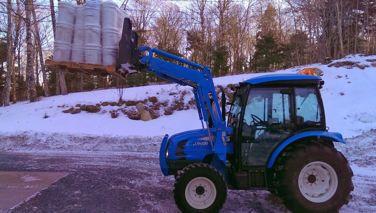

I've had a U5020C with an LL5100 loader for almost a year now. The pallet pictures contains 36 - 50lb pails of cement plus the forks and pallet itself. It lifts them with no problem at idle and with no ballast other than the loaded rear tires. She does get a little light when at full height, but manageable. I plow snow with the FEL (7ft blade), grade drivewys and such. It does everything I need and more. I do a lot of road running in the winter plowing local driveways and found she bogged a little in high (16th) gear, so I turned up the engine to ~55hp - 57hp and she works great now with no boggin at all! I had originally wanted the U5030C but the dealer talked me into the U5020C becuase it was less money and would do everything I wanted and he was right.
