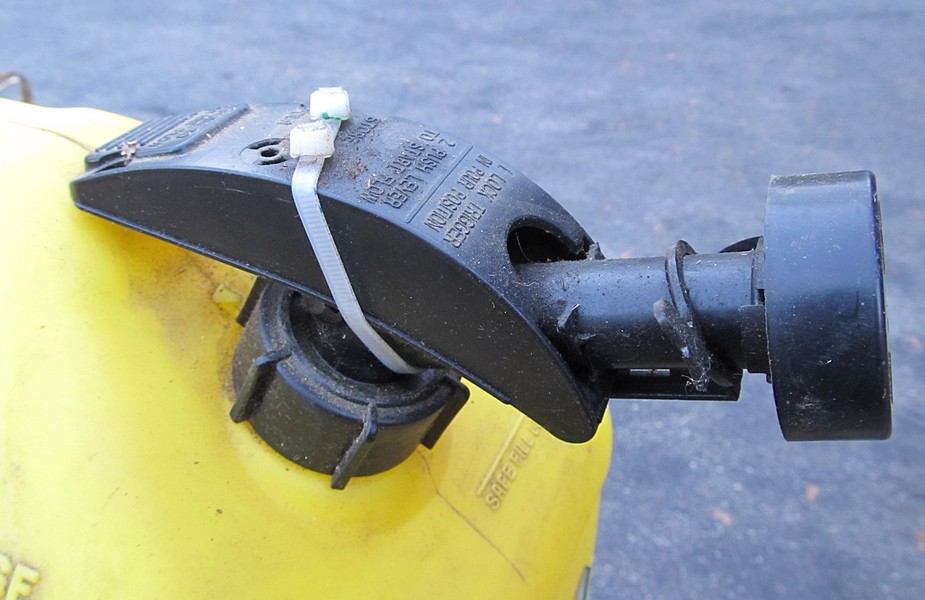

I have one of those fancy safety spouts on my diesel can and I have yet to get the dam thing to work. So I just remove the government approved nuisance spout and use funnel. Uncle Simple stepping on us with over regulation. I have a forty year old metal gas can that's still in service.
/ Anyone having fuel problems? #12
Tie wrap holds the trigger open on my diesel jug. I just couldn't hold the jug at the height of the tank and also try and hold the trigger open without some spillage.
