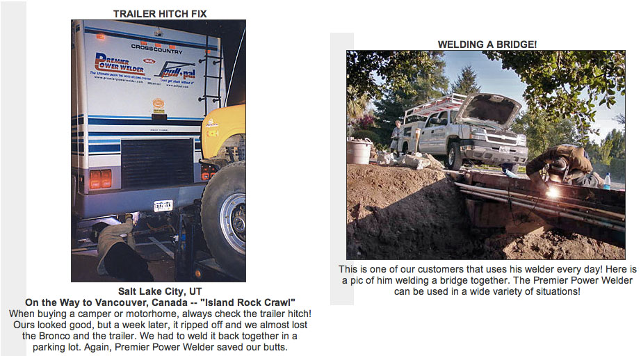

These fellas put the "P" in "Portable" !
(wonder if I really ** believe ** they towed a Bronco without look looking over the trailer hitch first.)
attachment.php
(pics from Premier Power Welder high-frequency portable 4x4 and off-road on-board welding unit for MIG, heli-arc, TIG welding )
   / Anyone here got an alternator welder on their truck or tractor? #7
Pat towed that Bronco all over the country almost every week so I doubt if he checked it before every trip. Before I had my own Premier, Pat used the Bronco's welder to repair my motorhome's hitch when it broke hauling my Cruiser into Johnson Valley. I bought one the next week.
