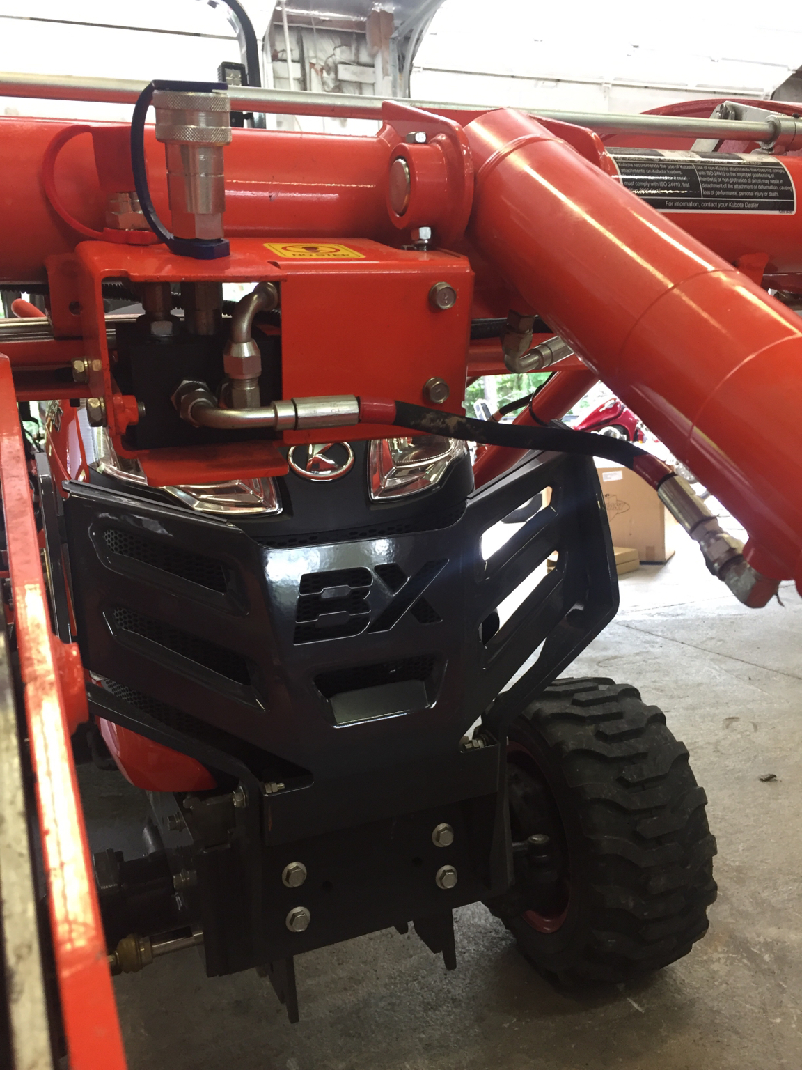

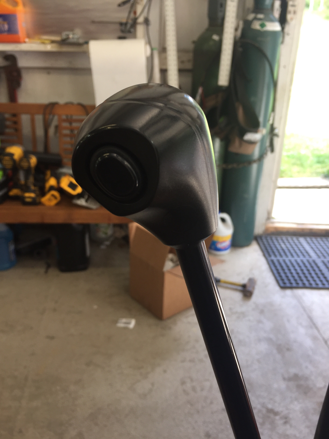

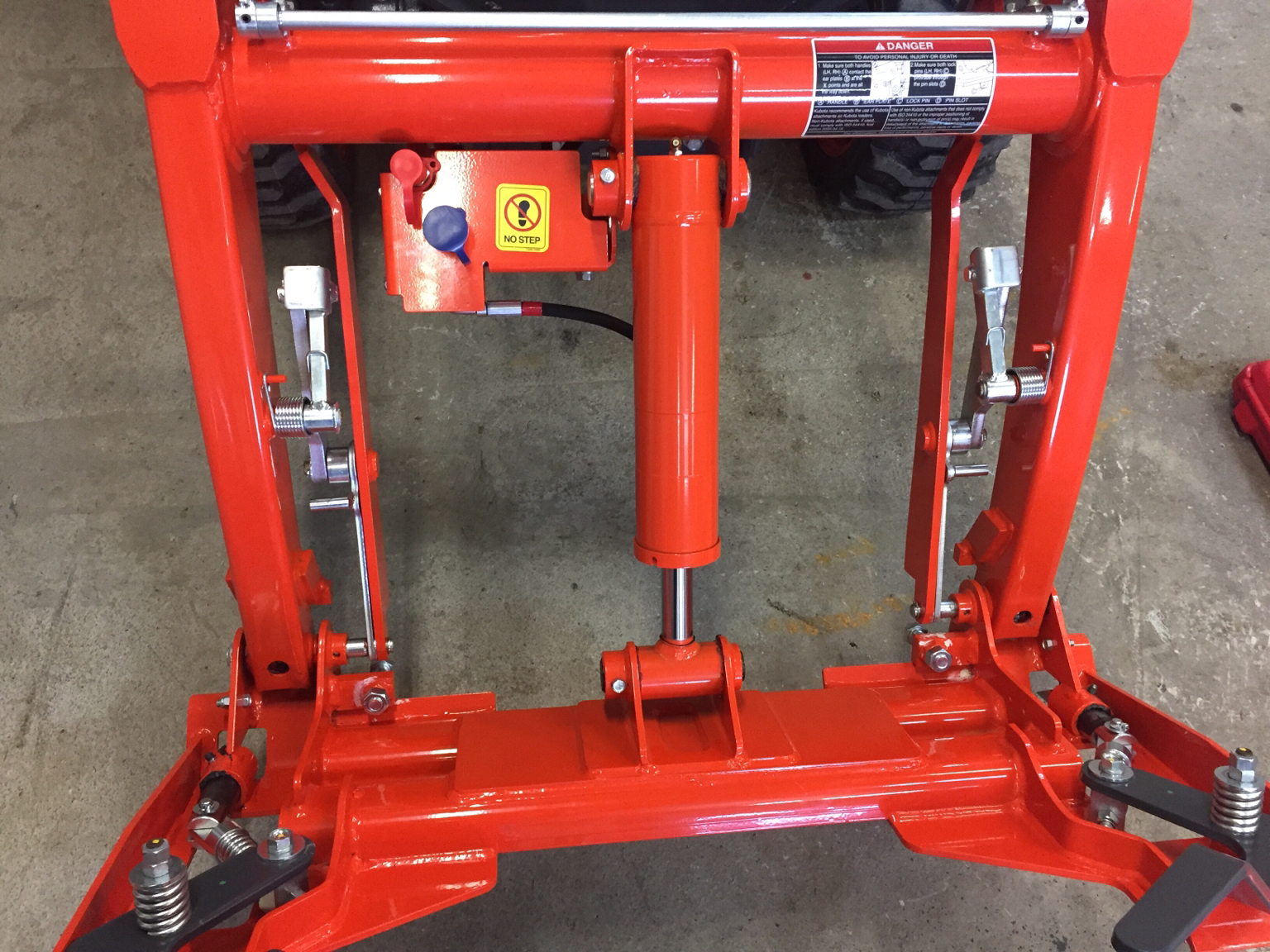

Had Messicks install mine when I bought my BX23s love it on my 4in1. Just hold in the button with your thumb an the dump/curl function for the bucket operates what ever accessory that's attached an it open/closes it. From what I understand the older 3rd function would only open an close the attached attachments the whole way where as this unit works just like the other hydraulics. IMG_6505.JPG. IMG_5859.JPG

What size connections are on that? 3/8"? I would like to order my grapple but wanted to wait until I knew what size connections are on the 3rd function valve... :)

That sounds like a diverter type valve vs true third function. The prior version ( what i have) is a true 3rd function where you can open/close the grapple while using the curl/dump function. However, due to the BX'S lower flow rate, they don't move too fast when activating both functions so probably no real-world difference.
They are the same as the curl cylinder has. My bucket has bigger quick connects on it so they put bigger ones on the valve. IMG_6652.JPGIMG_6653.JPG
